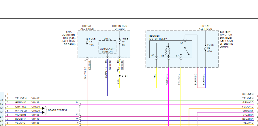

HVAC fuse location?
May 17, 2026 at 4:12 AM
DOUBLEDEE65
MEMBER
2 POSTS
HVAC fuse location
May 18, 2026 at 7:34 AM (Merged)
Experienced Mechanic
55,688 POSTS

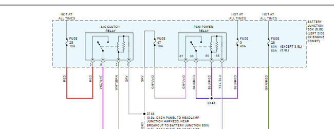

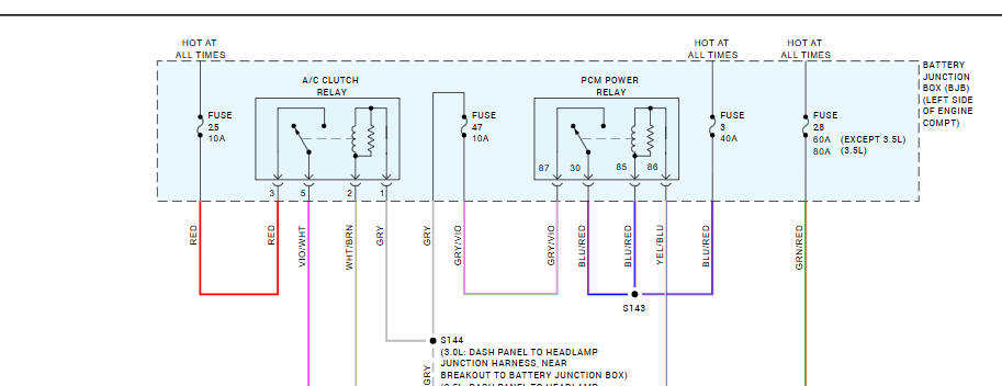

So there are several fuses that run the HVAC system. Here is a video to help check them and the location of the fuses in the wiring diagrams below so you can check them out.
https://www.youtube.com/watch?v=G-xNK79Wa-w
Check out the images (below). Let me know how it goes
