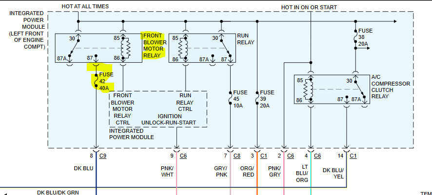

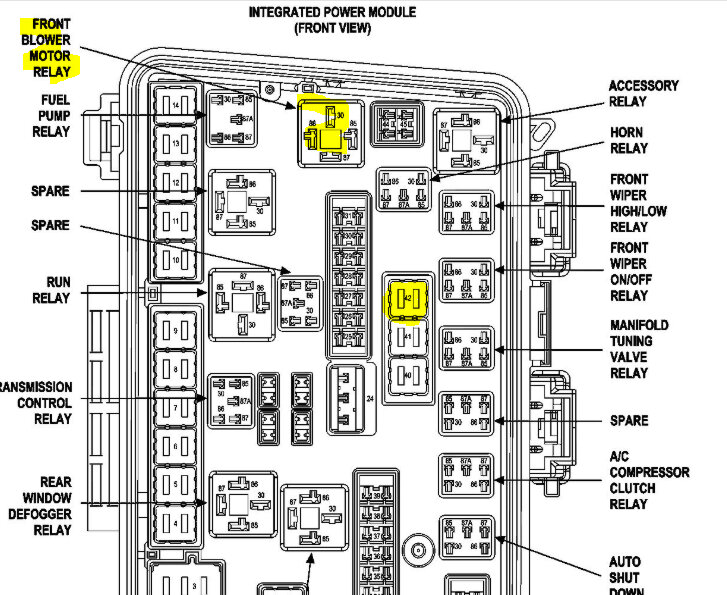

In most cases, a faulty resistor will still work on high speed. If you are not getting the blower motor to run at all, it could be a fuse or relay in the integrated power distribution module under the hood (fuse box).
Do me a favor. Check fuse 42 to make sure it is good. Confirm there is power to it as well. Here is a link you may find helpful:
If that is good, locate the blower relay in the same fuse box and switch it with a different one in the box having the same part number to see if it is a faulty relay.
I attached a couple of pics below to help you locate the fuse and relay. Let me know what you find or if you have questions.

Hey Joe, I just checked the fuse and relay, and both are good and are receiving power.

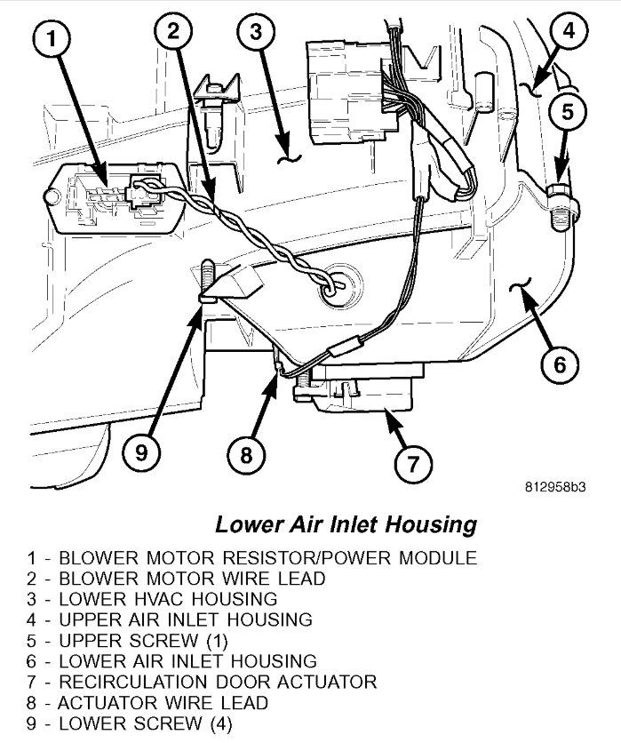

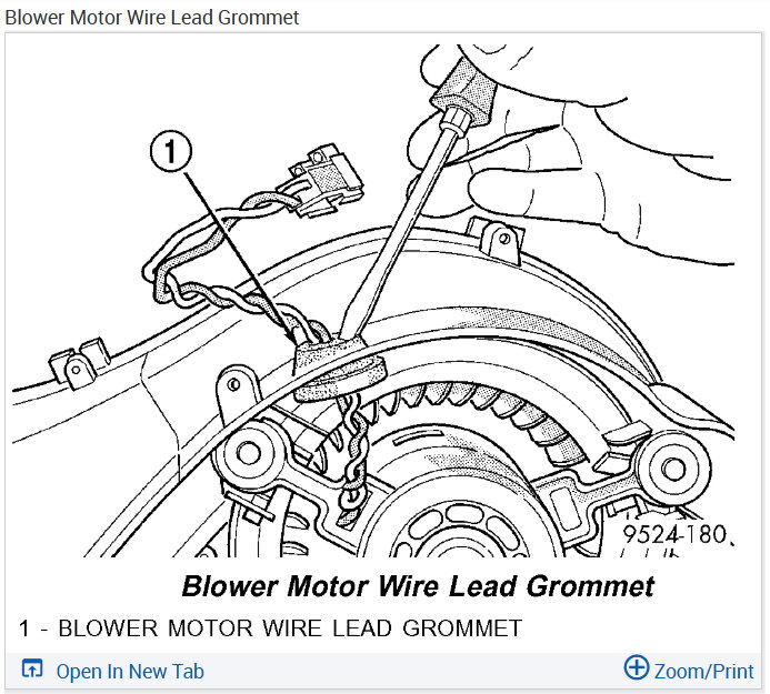

Yep, lets move onto the blower motor which is a common failure. Here is a guide to help test for power and ground and I have included the blower motor location as well.
https://www.2carpros.com/articles/how-to-test-an-automotive-hvac-system-blower-fan-motor-a-detailed
It looks like the blower motor is hard to get to, but the wires are easy so I would use those for the testing. Check out the images (below). Please let us know what happens.
