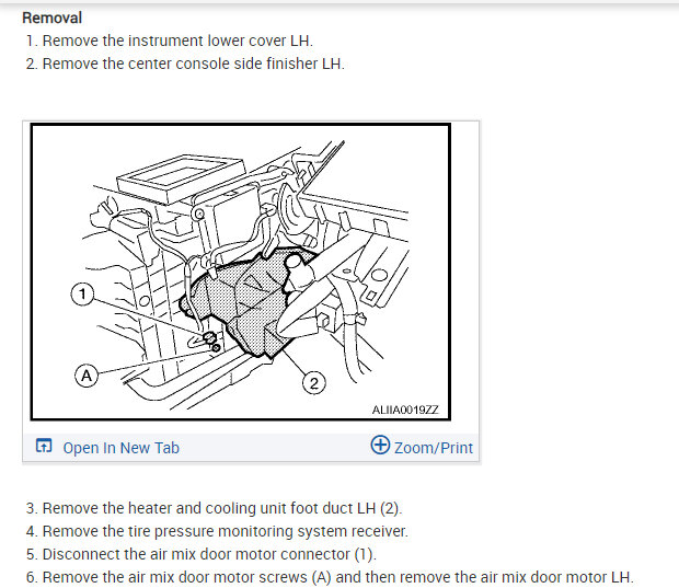

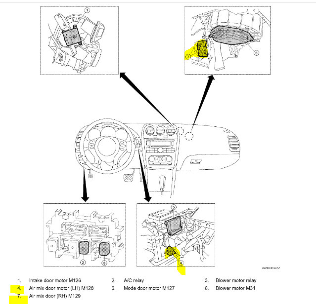

On this vehicle, there should be two blend door actuators (air mix doors). I attached a picture below for you and highlighted the two actuators. To provide the correct directions, I need to know which side isn't working, passenger or driver's side.

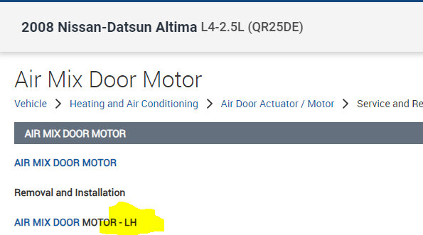

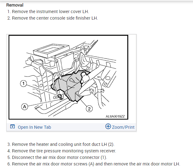

Are you getting cold air from the passenger side? If so, then suspect it is the air mix door actuator. I attached the directions below for you.
If you are not getting cold air from either side, chances are this isn't the issue, so let me know. The directions are for the left side (driver's side).
Let me know if you have questions or if I can help in any way.
