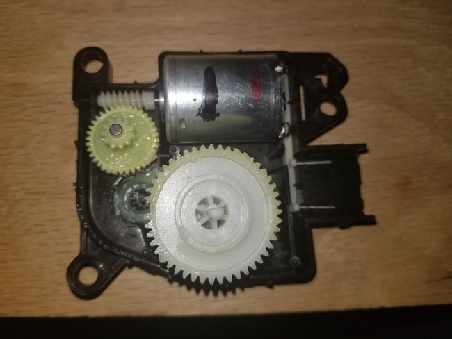

I checked to make sure it was properly secured and all the screws are tight. I think there's a gear on the inside of the actuator that is striped.
Oct 25, 2017 at 1:34 PM

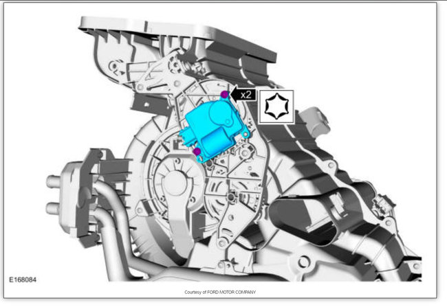

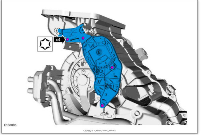

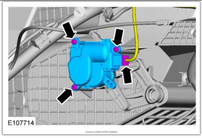

  • 55,781 POSTS
Yes it is stripped nice work on the video.
Here are the diagrams you requested. (below)
Here is a guide that will give you an idea of what you are in for when changing the actuator motor out.

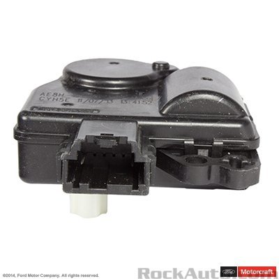

SATURNTECH9
  • 30,868 POSTS
That's the recirculation actuator I posted a picture is that what you're looks like?
Oct 25, 2017 at 3:48 PM
LMURPHY1437
  • 11 POSTS
Looks just like it. I ordered the part for the repair and it also looks just like that

$38 with a lifetime warrantly. It didn't take me longer than 15 minutes to fix. I removed the glove box in one piece. It was fixed by clips. Then unscrewed the 2 screws and fastened the new one. Now it's working like a champ!! Thanks guys for your help.
Oct 27, 2017 at 4:40 AM
  • 55,781 POSTS
Oct 27, 2017 at 4:47 AM
SATURNTECH9
  • 30,868 POSTS
Glad to hear you got it fixed great pics of the inside of the broken one shows what happens when they fail.Please tell all your friends about us.

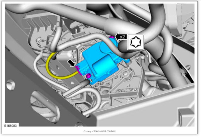

DOUBLED25 Could you please use this link to ask this as a new question?
Please include your vehicle information and if you have the manual heater controls (turn a dial for temp) or the automatic (set a desired temp and it does the rest) system.
In both cases the temperature control actuator is between the firewall and heater core so the dash has to be removed the cooling system drained and the A/C recovered then the HVAC case removed to get to it.
