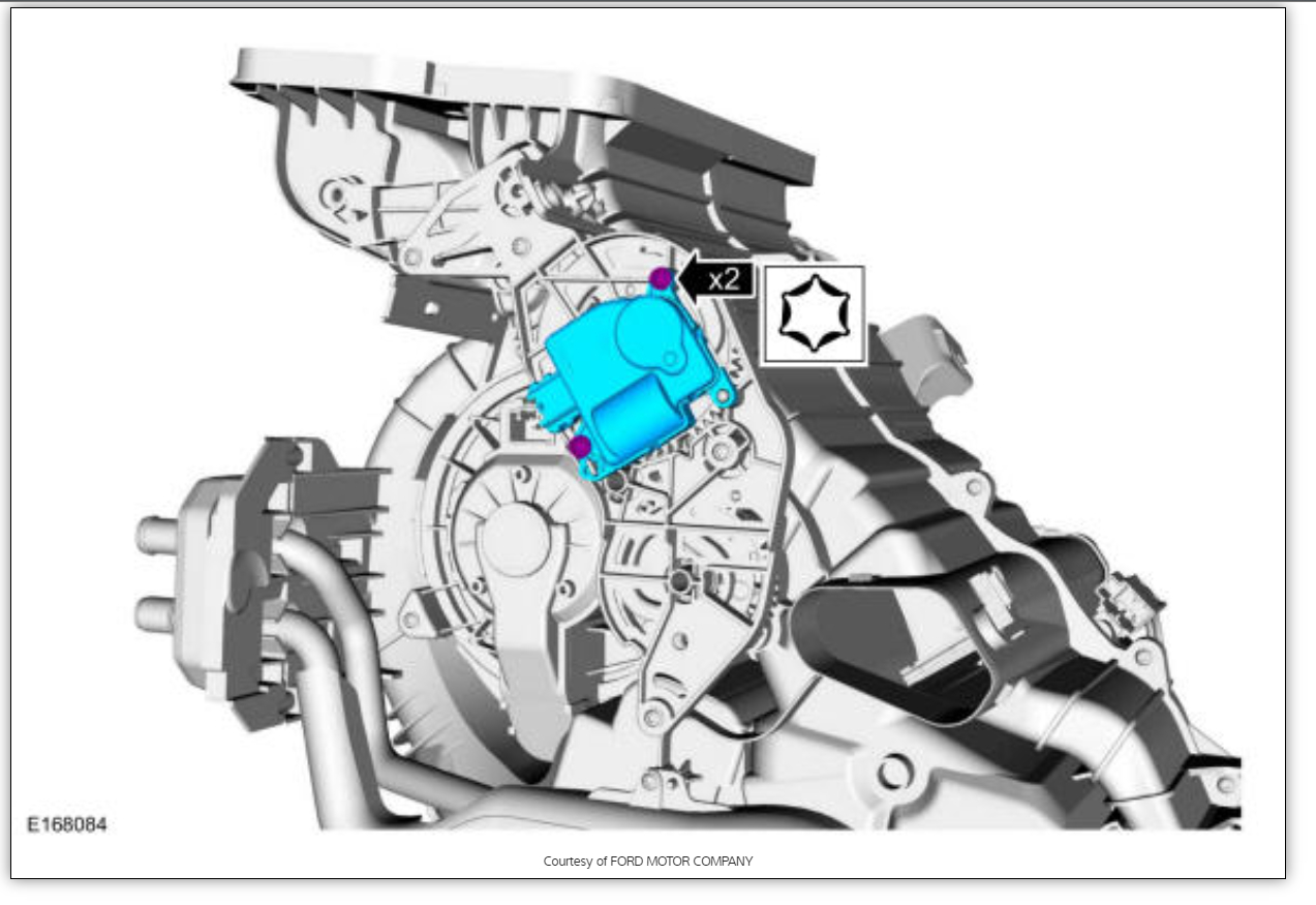

I am getting this knocking sound and realized that it is the HVAC door actuator. I am looking for a diagram that shows the location of the actuator so I can replace it. Any help would be amazing.

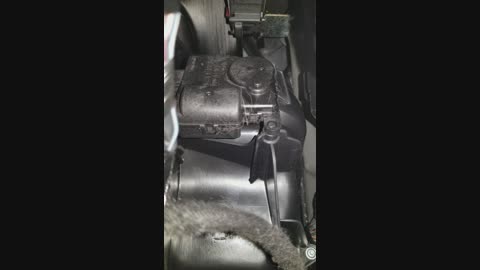

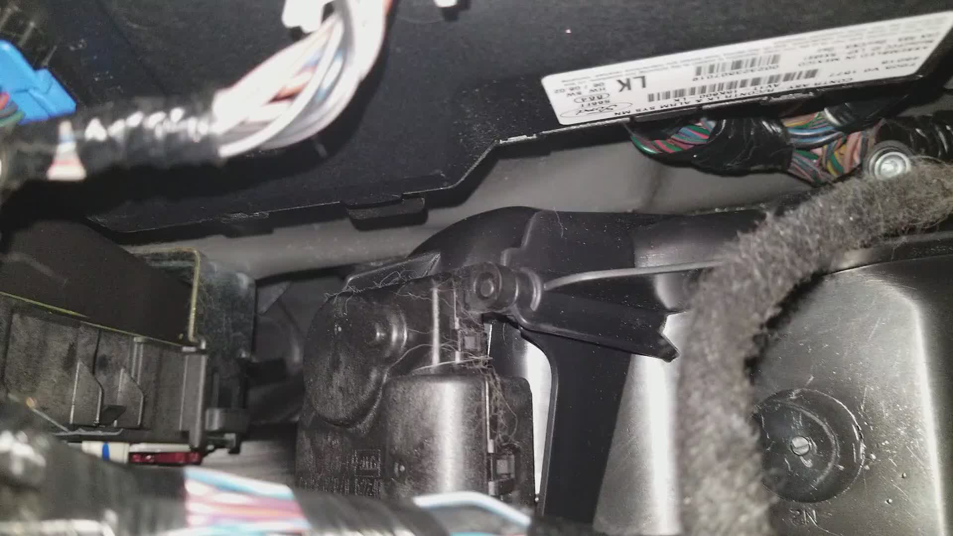

It's the one located directly behind the glove box. I can look underneath and see it jumping when it makes the noise
Oct 25, 2017 at 1:18 PM
LMURPHY1437
  • 11 POSTS
Here's a video of the actuator jumping in place and I'm recording direct where the passanger feet would be in the very back behind the glove box
Oct 25, 2017 at 1:26 PM
LMURPHY1437
  • 11 POSTS
I checked to make sure it was properly secured and all the screws are tight. I think there's a gear on the inside of the actuator that is striped.

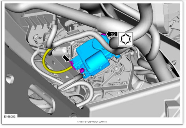

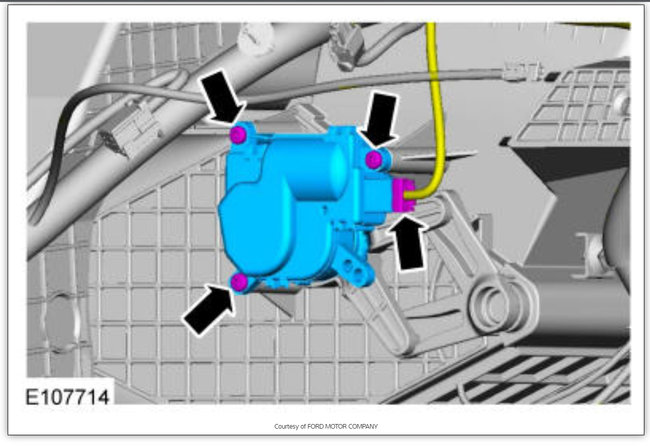

  • 55,433 POSTS
Yes it is stripped nice work on the video.
Here are the diagrams you requested. (below)
Here is a guide that will give you an idea of what you are in for when changing the actuator motor out.

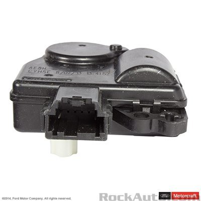

Hold off till I check my online repair information at work on your actuator.
Oct 25, 2017 at 3:21 PM
SATURNTECH9
  • 30,869 POSTS
That's the recirculation actuator I posted a picture is that what you're looks like?
Oct 25, 2017 at 3:48 PM
LMURPHY1437
  • 11 POSTS
Looks just like it. I ordered the part for the repair and it also looks just like that

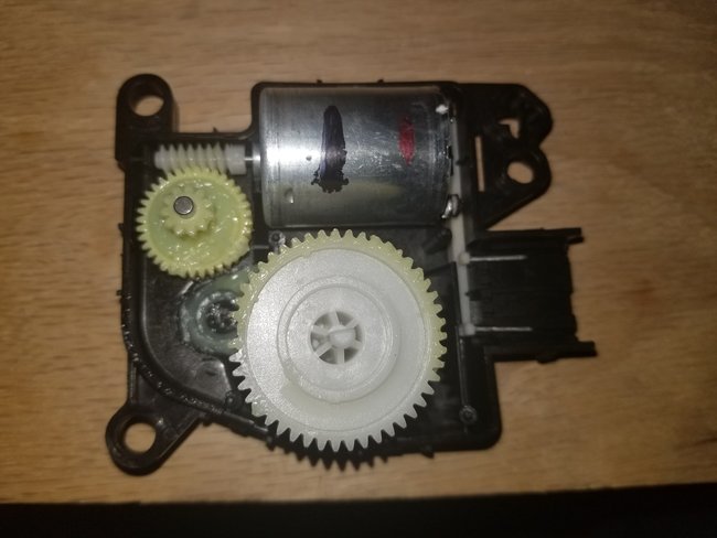

$38 with a lifetime warrantly. It didn't take me longer than 15 minutes to fix. I removed the glove box in one piece. It was fixed by clips. Then unscrewed the 2 screws and fastened the new one. Now it's working like a champ!! Thanks guys for your help.
Oct 27, 2017 at 4:40 AM
  • 55,433 POSTS
Oct 27, 2017 at 4:47 AM
SATURNTECH9
  • 30,869 POSTS
Glad to hear you got it fixed great pics of the inside of the broken one shows what happens when they fail.Please tell all your friends about us.

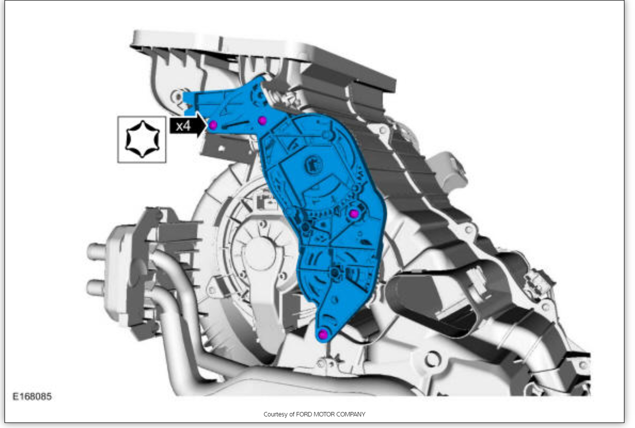

I’m having basically the same issue with my 15’ Fiesta se. I was having the clicking sound a few months ago but it stopped. Now I only have heat. It makes no difference what temperature I set the climate control to it blows hot air.
Feb 4, 2019 at 5:44 AM
STEVE W.
  • 15,351 POSTS
DOUBLED25 Could you please use this link to ask this as a new question?
Please include your vehicle information and if you have the manual heater controls (turn a dial for temp) or the automatic (set a desired temp and it does the rest) system.
In both cases the temperature control actuator is between the firewall and heater core so the dash has to be removed the cooling system drained and the A/C recovered then the HVAC case removed to get to it.
