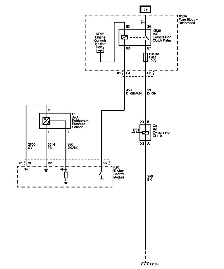

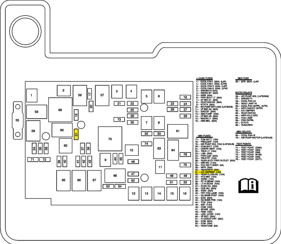

The vehicle listed has a 2.4. The air is warm. static pressure on high and low is 150 PSI running pressure is the same. Compressor clutch does not engage. Verified the vehicle A/C command is active. Verified all controls on faceplate are functional. All temperature sensors are accurate and functional. Ambient temperature is 86f.

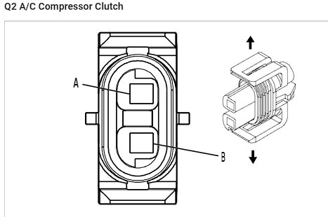

Hello, the first thing I would check is the fuse for the compressor clutch. I highlighted the fuse in the image. If that checks out okay, then use a test light or DVOM to check for power and ground at the compressor connector. The engine will need to be running with the A/C turned on, so be very careful of moving parts. If you are getting good power and ground and the connector, that would indicate a failed coil on the compressor.
