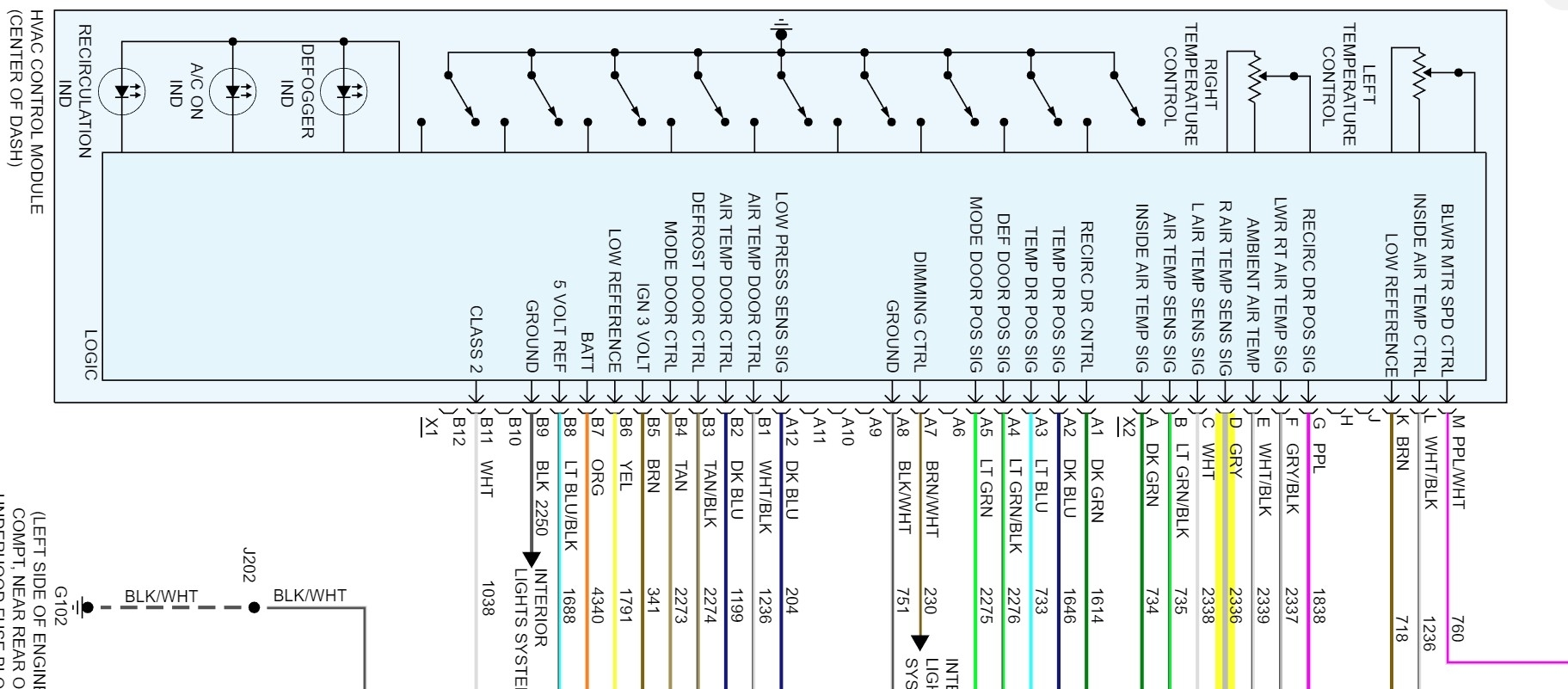

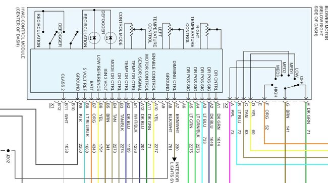

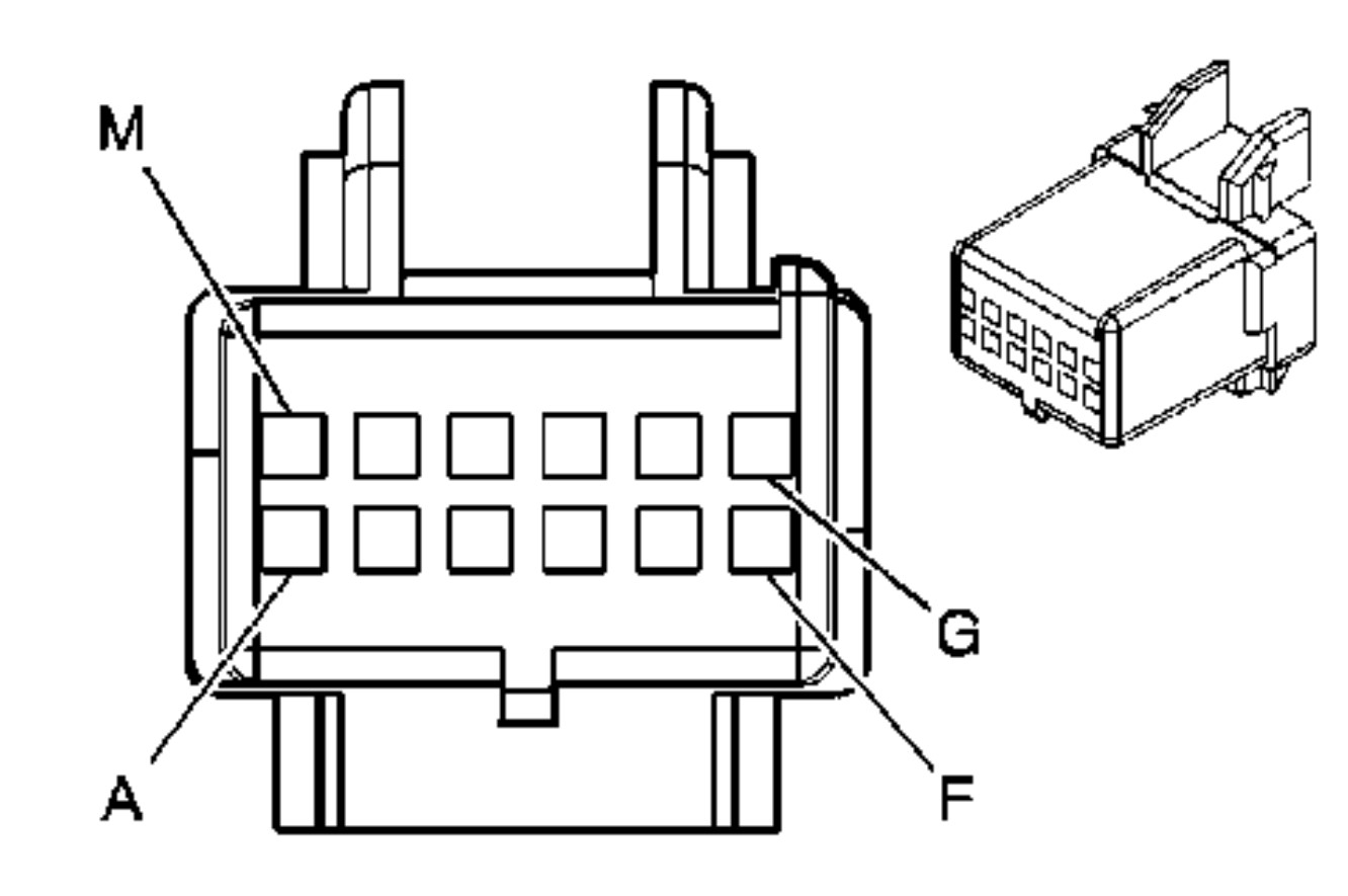

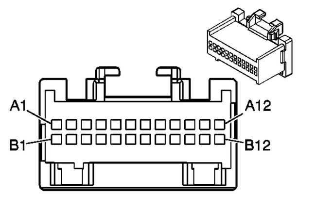

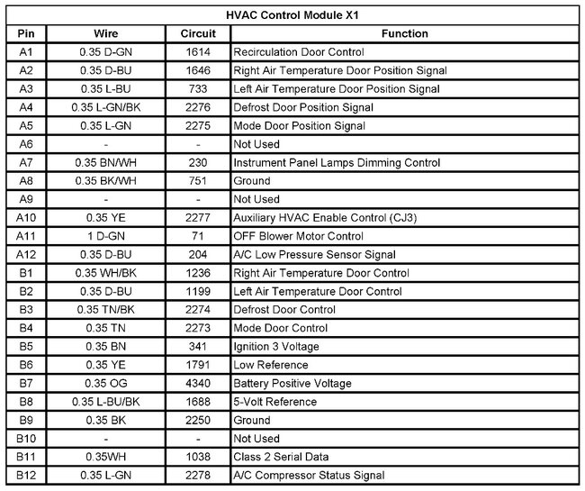

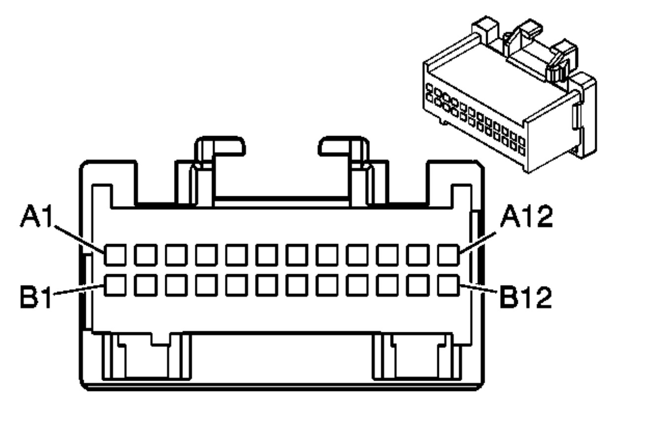

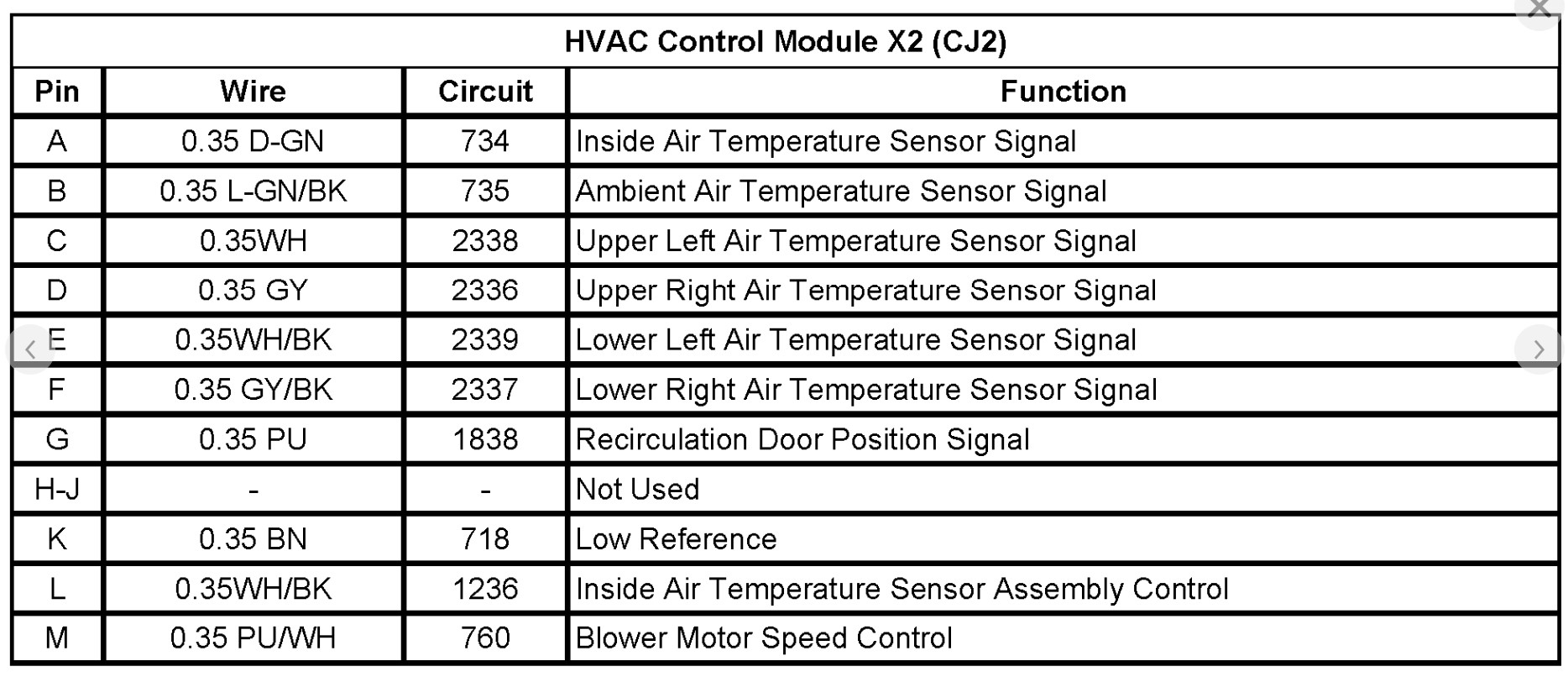

Looking for a pin out diagram of the A/C module. Wanting to diagnose an issue with it working. Can't find any pin out of the light blue plug and the black plug. Maybe some board schematic as well.
Feb 24, 2023 at 8:59 AM
STEVE W.
  • 15,293 POSTS

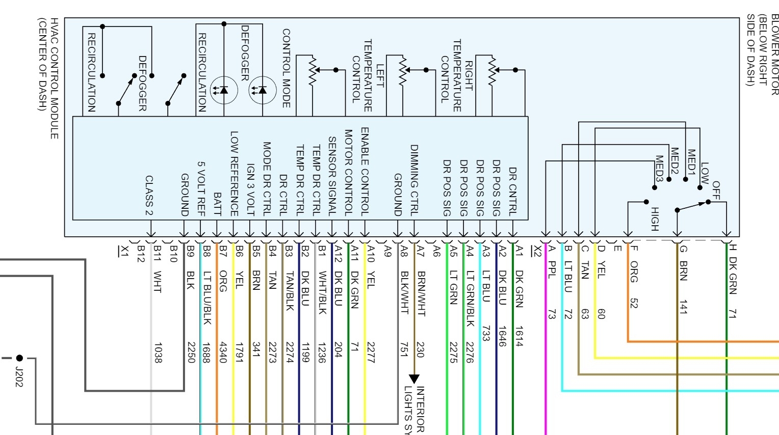

Very doubtful of you finding any board level schematics, those are only shared with the folks who make the boards and a very few authorized repair companies. However, the wiring pinouts are attached. First is the automatic system, second is manual control. What is the issue you have? GM systems are generally known for failing aspirators and actuators, with the occasional control head failure. The connector images fit both but with some missing on the manual control.
