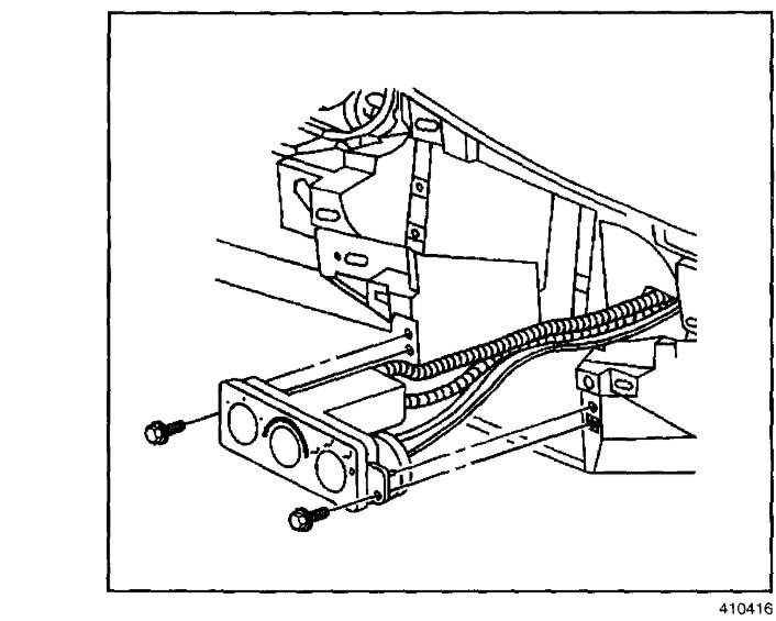

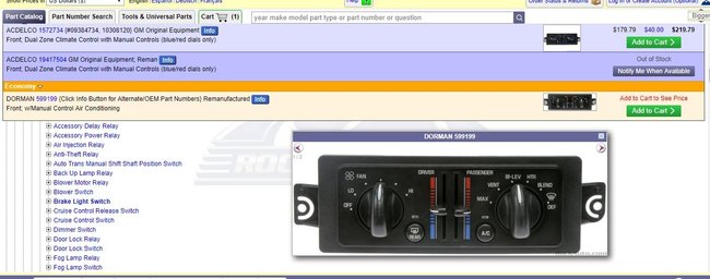

Yes, I would replace the control head. It sounds like it has failed.
rock auto has the part. I attached a picture for you.

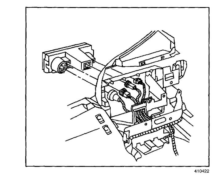

Procedures below for you.
1. Remove the instrument panel accessory trim plate.
2. Remove the front floor console, if equipped.
3. Remove the retaining screws from the HVAC control module.
4. Pull the HVAC control module out from the instrument panel.
5. Disconnect the electrical connectors and the vacuum harness, if equipped from the HVAC control module.
6. Remove the HVAC control module.
