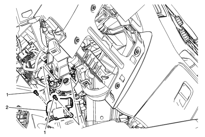

I replaced the actuator for the blend door actuator because the driver side blew hot. Now I have cold air coming out only on driver and passenger feet and nowhere else even when selected on control panel. This is an LTZ with dual zone.
Which one do I need to replace now.

Yep, this happens when the mode actuator goes out, bad timing there, it happens. It is on the drivers side above the accelerator pedal. Here is a guide to help reset the system after the repair:
https://www.2carpros.com/articles/step-by-step-guide-to-reset-your-cars-hvac-system-an-essential-for-every
Check out the images (below). Let us know how it goes.

The problem is solved. I would like to thank you for your help.
Sep 25, 2025 at 4:13 AM
  • 55,628 POSTS
Cool! what was the problem?
Sep 26, 2025 at 2:12 AM
BANDITNC
I had originally replaced the actuator on the driver side just above the steering column and so I replaced it based on your recommendation and that was the problem. Kind of weird that it failed so soon.
