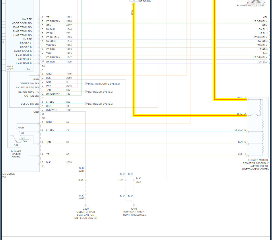

My vehicle listed above Alpha's HVAC blower stopped working one hot afternoon while running on high for sometime.
Did all usual suspected checks, found the blower resistor connector was burnt, but had been previously repaired by splicing a wire in place of the burnt terminal and solder.
I've replaced the connector and resistor now that I've had it off.
Still no fix. While on the highest setting, can hear the relay buzzing, turning on and off rapidly.
I did remove the blower and connected directly to battery, it works fine.
Another odd thing that happens when trying to turn on the blower, the wiper comes on and sometimes I get "Traction Failed' on the dash.
Not sure if it's related, but I have an issue with my right turn signal as well. Selecting right, turn on the left turn signal. Sometimes its flickers on and off, sometimes it's okay if I choose left then right (but can see the left momentarily flash once even when selecting right).

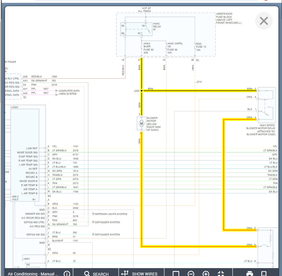

It sounds like the relay is the issue. If you hear it rapidly clicking then that means it is either shorted or control module (BCM in this case) has a grounding issue causing it to rapidly turn on and off.
A relay should click once when it is turned on and that is it. So I would start with checking voltage at the blower and then remove and jump the relay by applying 12 volts to the 87 terminal.
I attached the wiring diagram below that will help with this.
Please run through this and let us know if you have other questions. Thanks

Thank you for the guidance, I managed to trace a bad contact on the ground side leading up to post G106 in the right wheel well. That sorted the blower issue and the wiper/turn signal issues as well.
Thanks again.
