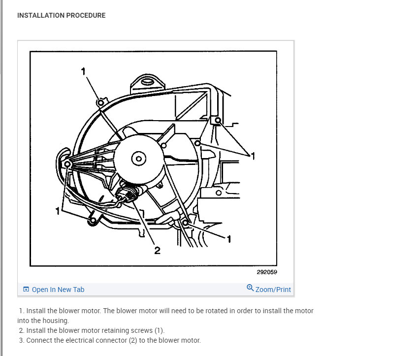

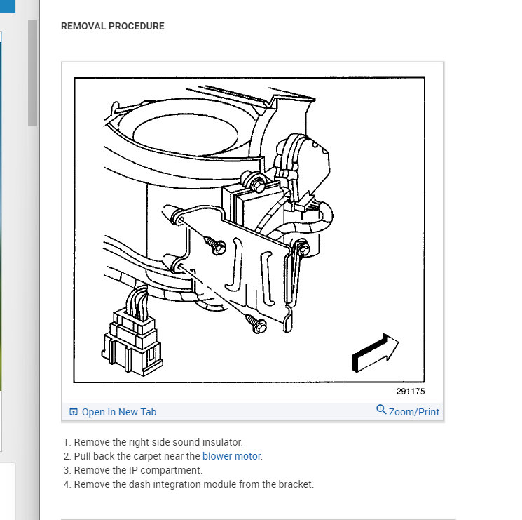

I need description of blower motor removal procedure. A video would be nice. I have removed everything except the motor. I can't get the housing apart.

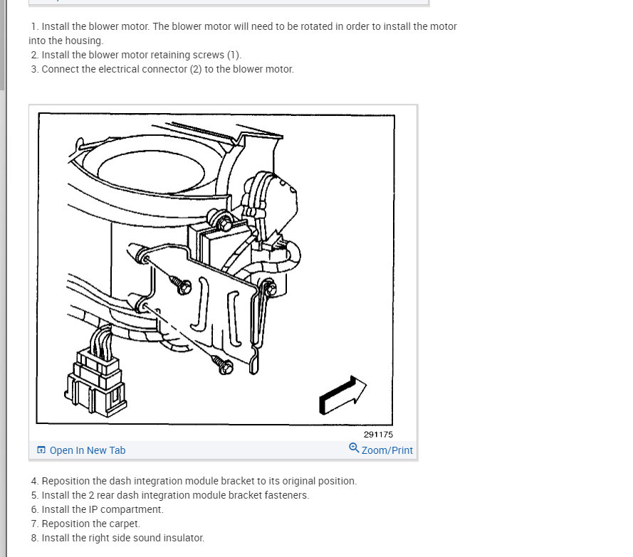

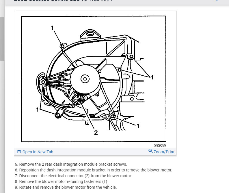

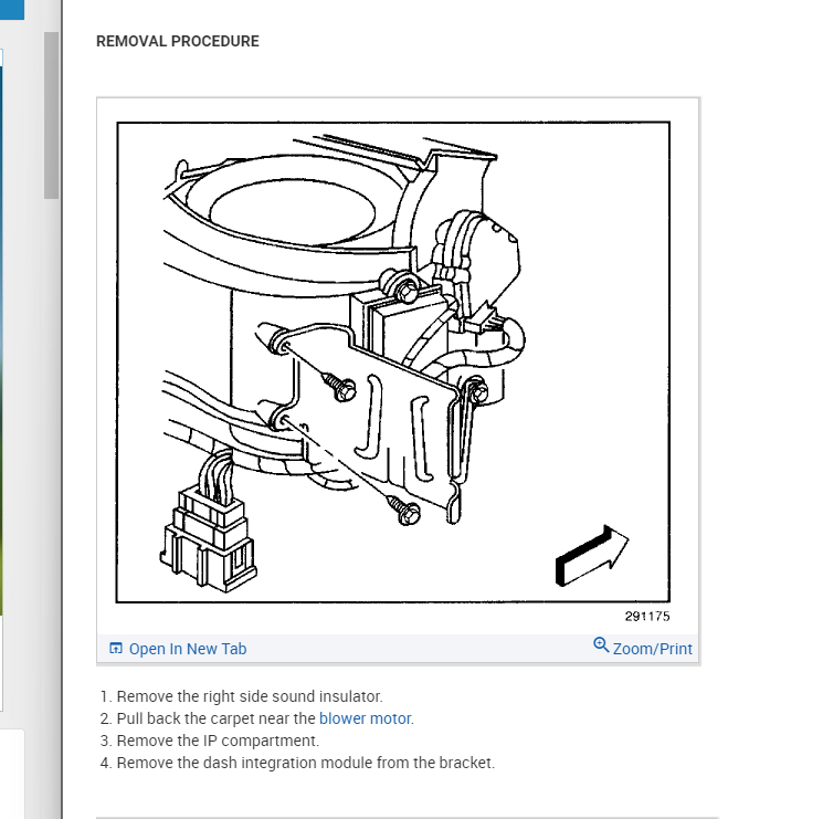

However, the process from the manual is below. Please run through all this info and we can go from there.

Did you see the attached documents that I provided for your specific vehicle? I understand the look is different between the Ford and GM but the idea with the video was to give you the overall process not an exact step by step.
The exact step by step from the manual for this vehicle was attached below my previous post.
Basically, I am trying to give you as much info as possible to help you do this repair. Sorry I don't have a video on your vehicle but unfortunately that is not possible to make a video on every vehicle.
Please review the attached documents and let me know if you have questions. Thanks
