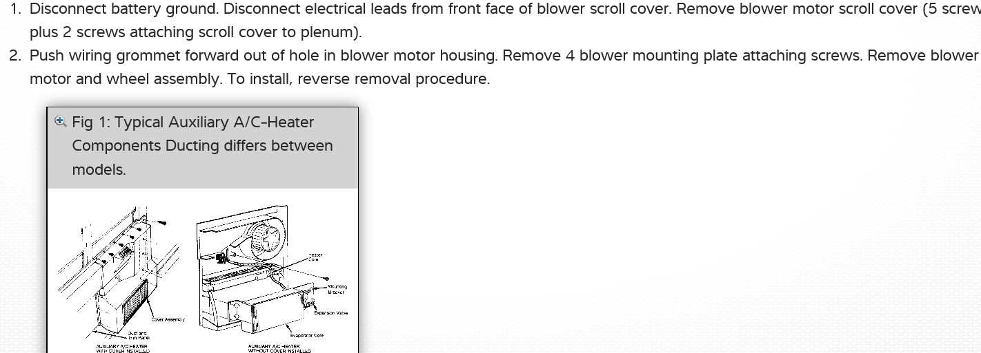

I have a 1987 RV built on a Ford e350. The ac/heater blower will start squealing after it runs for a little while either on ac or heat. I want to replace it but have a question on removal. Does it remove from the interior of the vehicle of under the hood. It seems that it should come out from the interior, and looking at replacement part photos seems that there shouldn't be any connections to it from under the hood. I have attempted to remove it but it seemed very solid after the screws were removed. Does it take anything other than force to remove it?

see pic if you do what this says it mayhave to be pried off due to age. you can use sealer that is sold at auto parts to fill gap again if you have any
