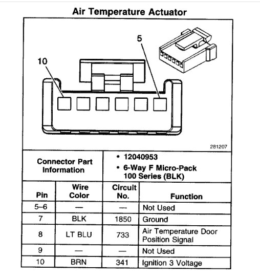

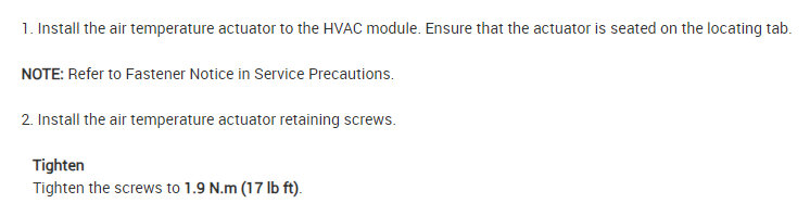

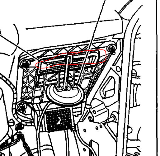

I need to replace my HVAC actuator inside the glove box. When i unplug it ,i see this has a 4-pin wire plug, all the new ones i want to order have the pins moew pins where it gets plugged in at, does it make any difference if i buy one that has extra pins?? The one i have has numbers, left to right 10 9 8 7 6 is blank and 5 is blank... I see Dorman has part number 604-100and 604- 101 different price but have more pins. I was confused in this issue, with the pins and was just wondering, will the aftermarket ones still work, and what do the extra pins mean?? mine is a manual dial, changing the cold scale to hot. I hope i didn't confuse you on this issue, I just do not want to put the wrong one in, because i know this is not going to be fun doing, especially with bruised right hand and knuckles. any help will be thankful. God bless you on the work you do. One last thing, do they have to be calibrated so how after its installed?? i watch too many YouTube and i am really dump founded.
Feb 9, 2024 at 7:17 AM
  • 110,244 POSTS

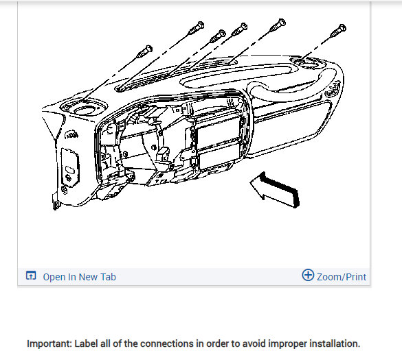

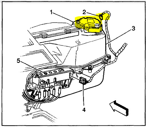

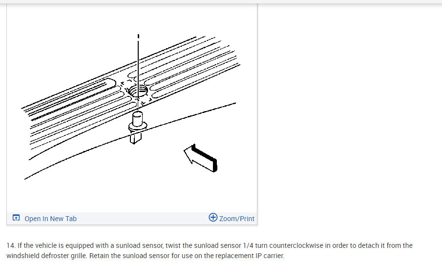

I'm not sure you are looking at the same part. I attached a connector image of the air temperature door actuator below. Let me know if it is what you have.

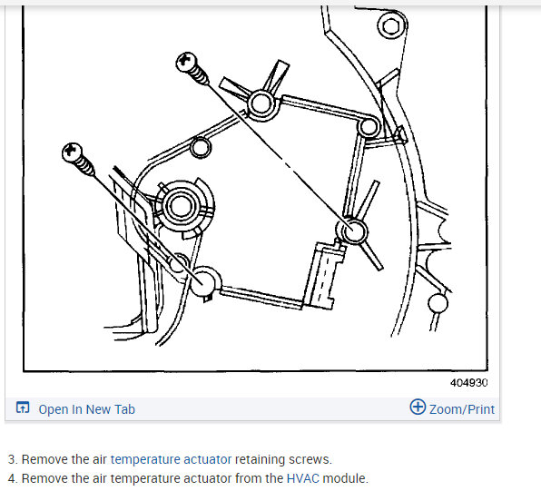

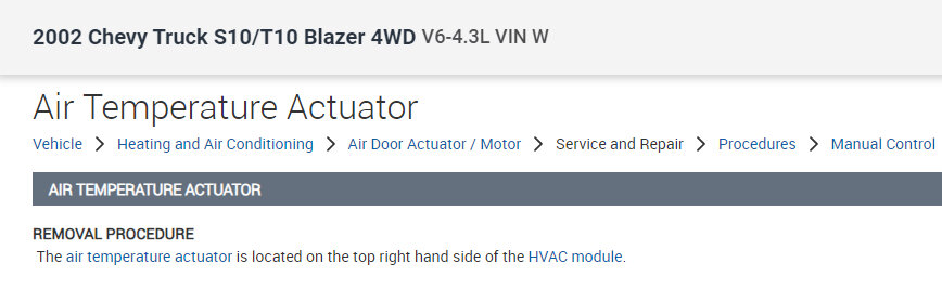

Next, to replace this actuator, the manual indicates the instrument panel carrier needs to be removed. This is somewhat of a nightmare. LOL

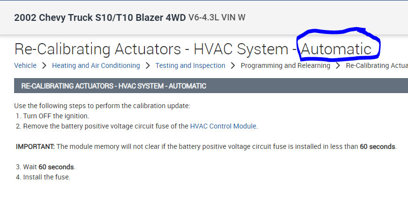

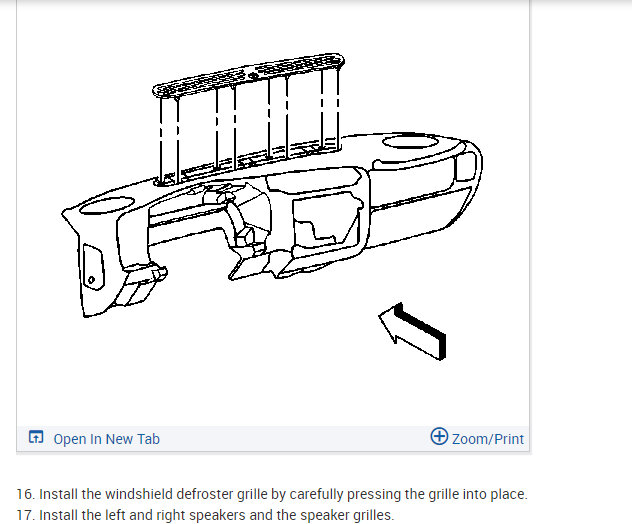

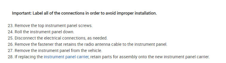

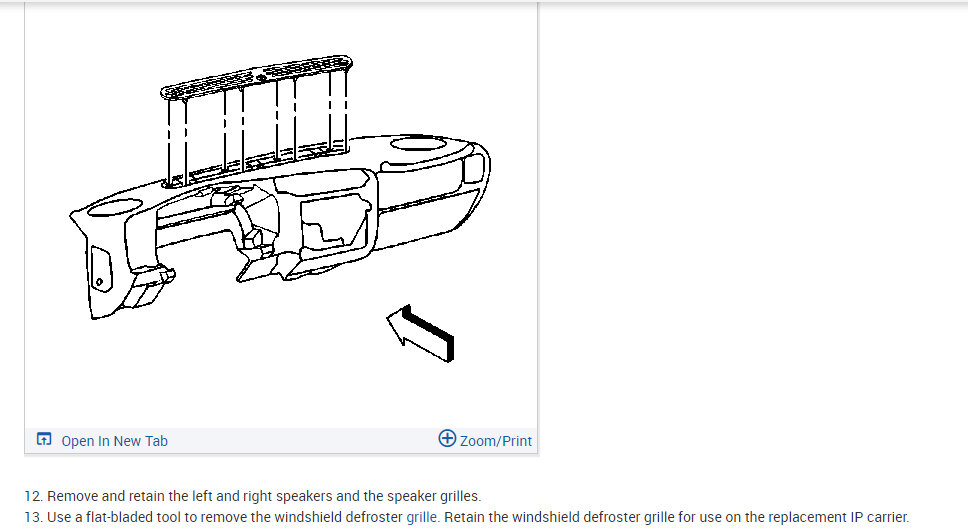

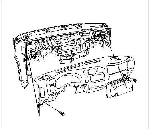

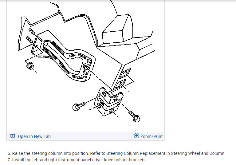

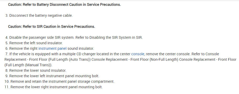

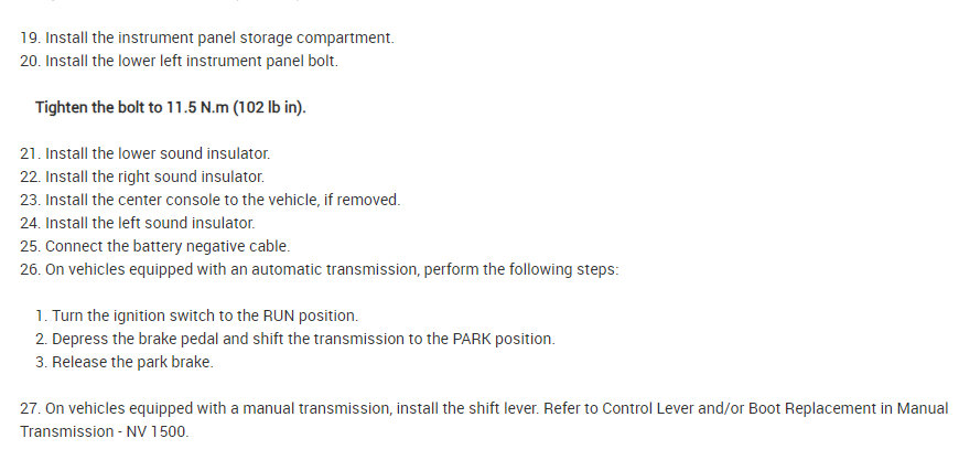

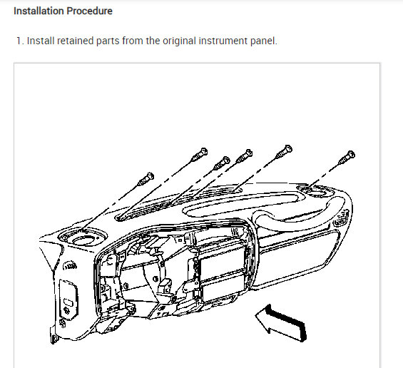

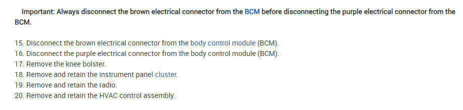

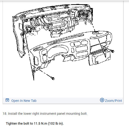

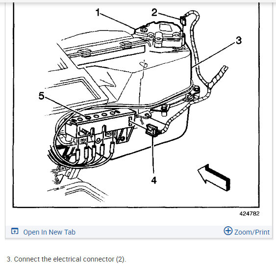

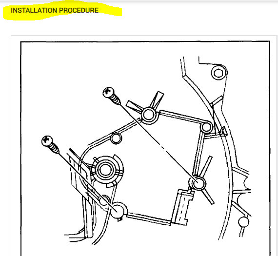

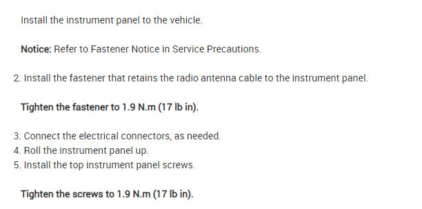

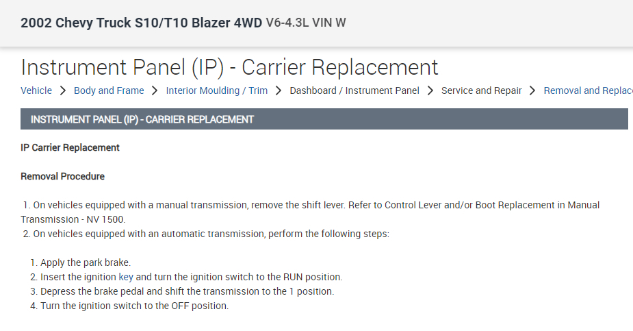

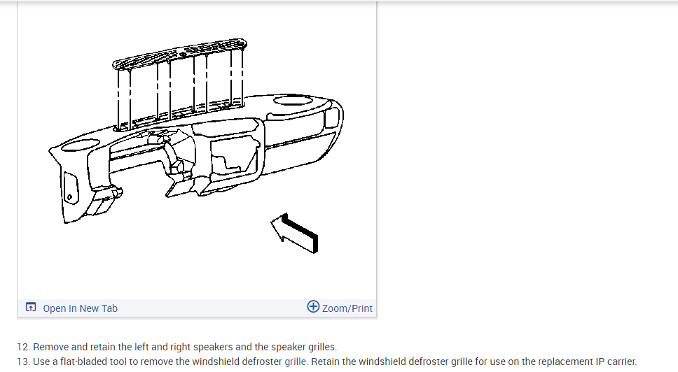

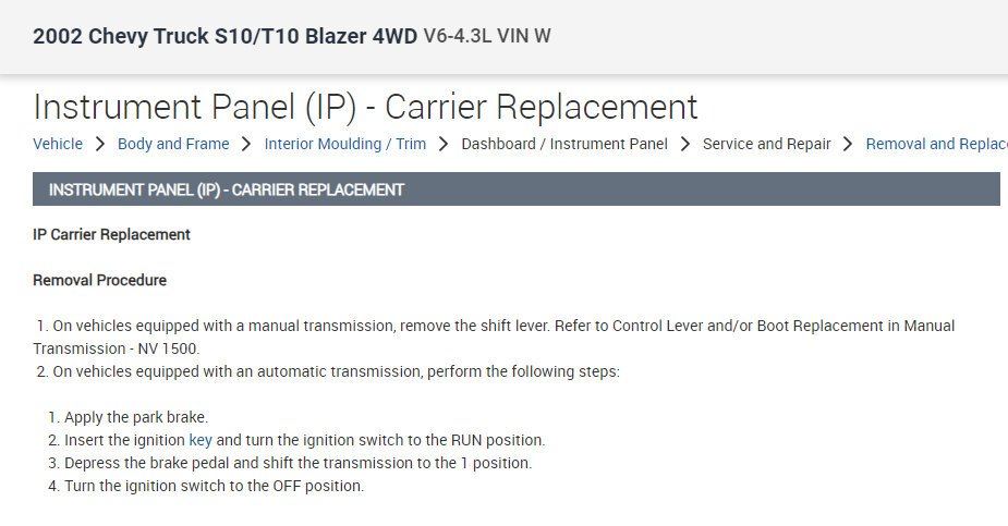

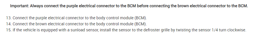

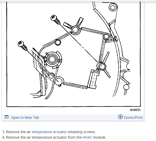

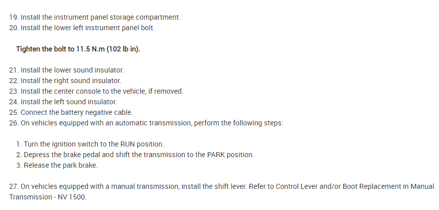

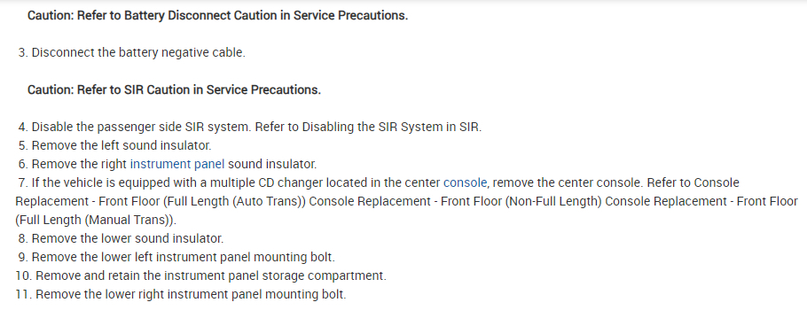

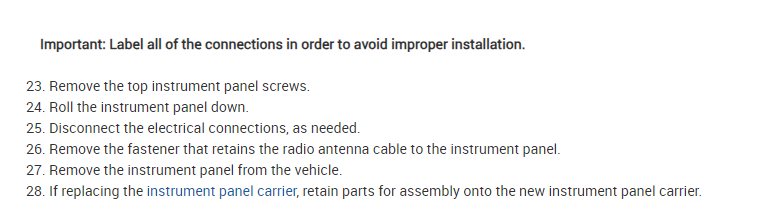

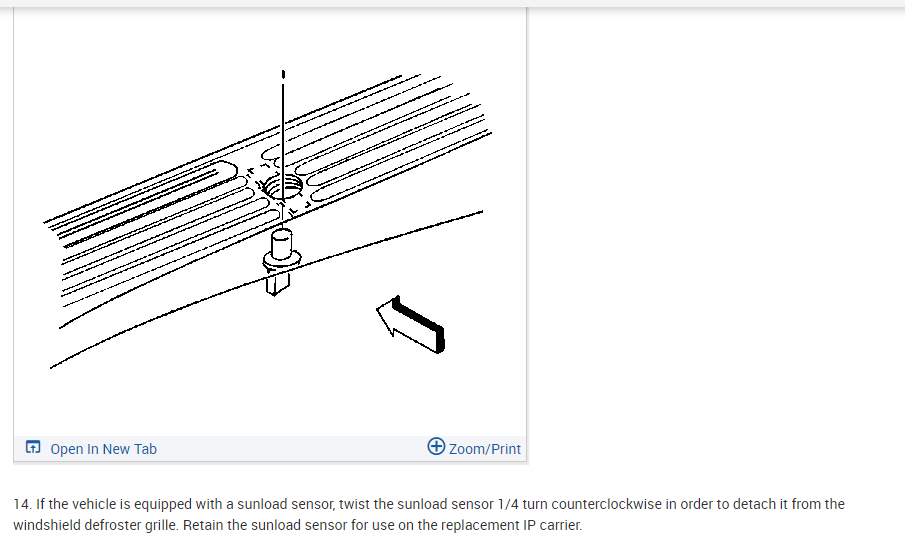

So, pic 1 below shows the connector. Pics 2 - 9 are the directions for replacing the actuator once the carrier is removed. I added pic 10 for recalibrating the actuator, but the manual only indicates this needs done with automatic climate control.

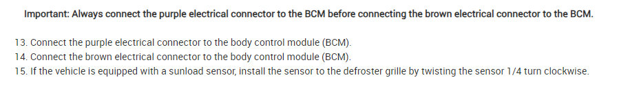

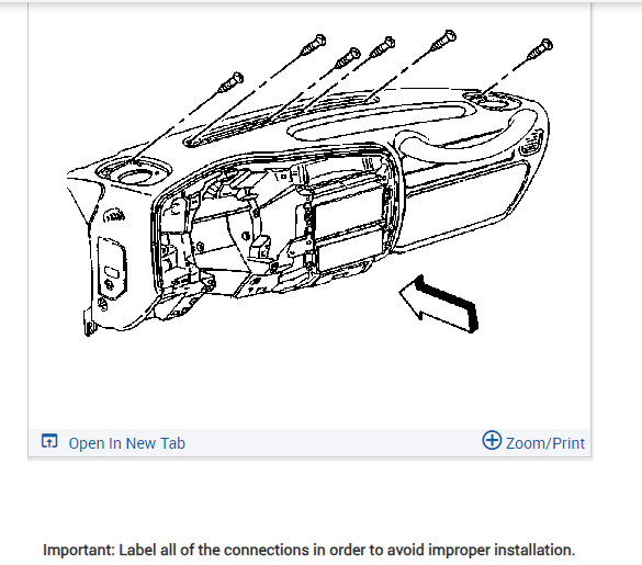

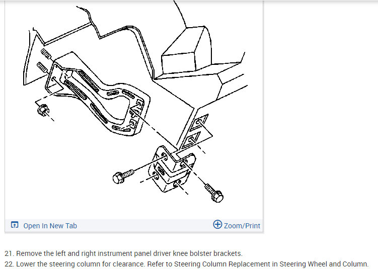

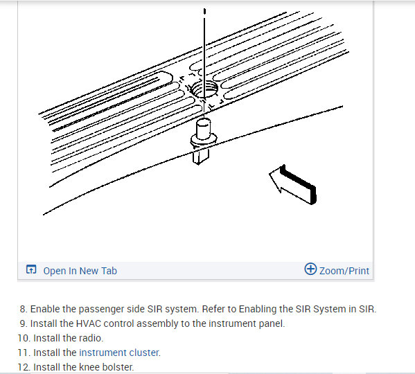

The remaining pics, starting with pic 11, are the directions for Replacing the IP carrier. You aren't replacing it but that is how the removal directions are provided. Also, (and this is from memory only) I don't believe the IP carrier needs to be fully removed. If I recall, once the upper and lower carrier bolts are removed, you can roll the IP enough to replace the actuator. Just be careful to avoid wiring damage.
Also, back to your original question. You need to make sure the connector will even work with yours. Often, connector pins are not all used. Your vehicle, for example, has a six pin connector, but only three of the pins are used. What I recommend is to deal locally. Remove the actuator to see which you have. I have a few reasons I'm suggesting this. First, there are several different part numbers which appear to work. That indicates there were different designs based on model, package, and climate controls in the vehicle. Second, I have seen so many aftermarket parts failing. You don't want to go through the return procedure if needed. Finally, and to me most importantly, you don't want to do this job twice.
I hope this helps. Let me know if you have questions.

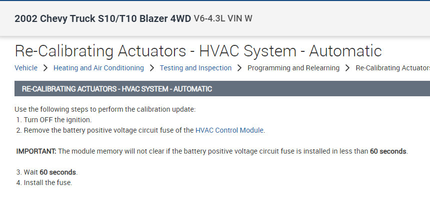

will do as instructed. After I install i, do i have to calibrate it or does it do it by itself??
Feb 11, 2024 at 1:57 AM
  • 110,244 POSTS
The only thing indicated in my manual is related to an automatic climate control system. Nothing is listed for manual climate control.
However, if there are any issues, it won't hurt to try the reset for the automatic type so I attached the directions below.
See pic below.

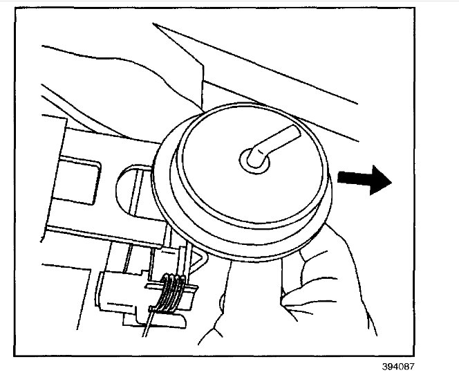

Take a look at the pic below. Is this the door/actuator you are referring to? If so, that is the fresh air/recirculation door and actuator. That won't change the air flow volume.
See pic below.
Feb 15, 2024 at 11:39 AM

  • 86 POSTS
That's the one i was talking about. will be testing it today, and get back to you on the results.
