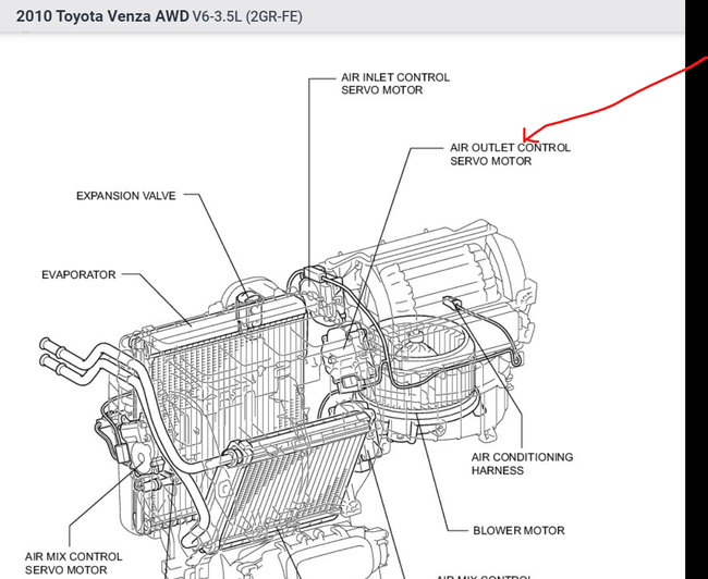

I recently noticed that when turning on the vehicle (Venza), the HVAC controls don't work (rear/front defrost, mode change, temperature, etc.,) and the word "auto" is shown on the screen. After 30-45 seconds, the controls work but the airflow is stuck to the front facing vents. Changing to front defrost or footwell doesn't provide any airflow to those locations.
I've searched online but the only mentions I've come across are about the airflow mixer/actuator and replacing that. However, that seems to be for people that have a problem where it's constantly hot or cold airflow. Would replacing the driver's side actuator help resolve the issue of the airflow not diverting to the selected option? Or is there another actuator that would need changing? Is there such a thing as a "mode" actuator?

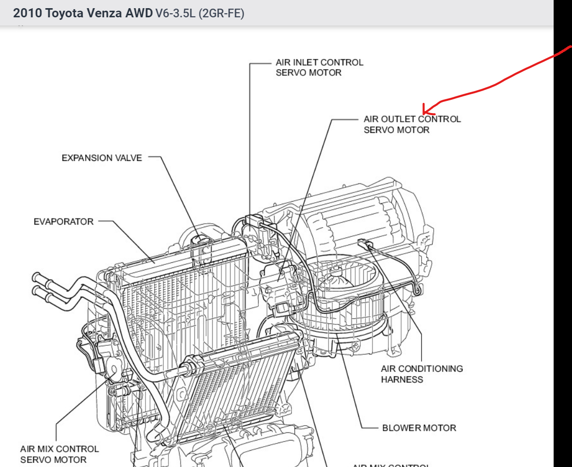

Yes, they called it an air outlet servo motor here is the location in the images below. Check out the diagrams (below). Let us know what happens and please upload pictures or videos of the problem.

Thank you, Ken. I too think it's this servo, so I've made an appointment with my dealer next week to see what they say. Let's hope they don't come back to saying that it's a $3,000.00 job as it seems like it should be serviceable by removing the glove box and some side panels. Still unfortunate to have to spend a lot of money on a vehicle that we only plan on keeping for another 6 months.

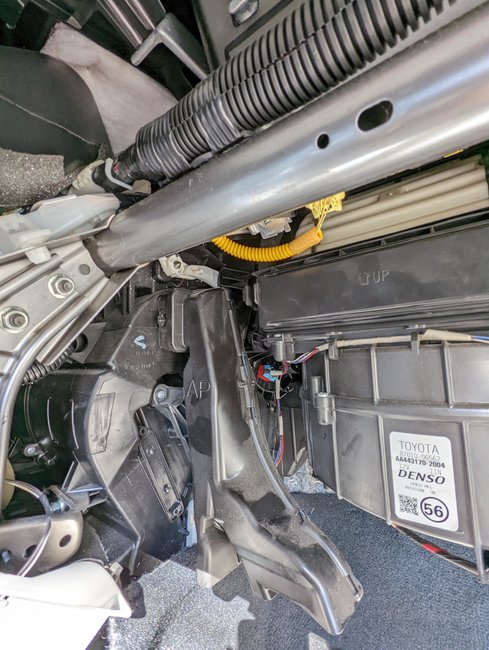

So not much of an update. I took apart the glovebox area so I could have a better look at the blower motor and actuator area. I can confirm that when changing the air mode, the gears and pulleys don't move for the one up top which I believe is the air outlet control servo motor. I tried moving the gear and lever a bit, but it wouldn't budge. So, since I had this much access, is it possible to replace that part without tearing out the entire dashboard? Seems tight and I could see having to remove the blower and maybe the long air tube directing airflow downwards but is that piece even changeable? Also, what part number is it? I'm having a bit of a challenge finding the part. I think it's Toyota 87106-06250 but would love it if someone could confirm.

They don't give us the part number on this particular car for some reason, sorry. That is a tight fit to remove the servo motor try to remove as much as you can to get at it. Also, I noticed this car has a cabin filter, remove that to see if it is plugged.
