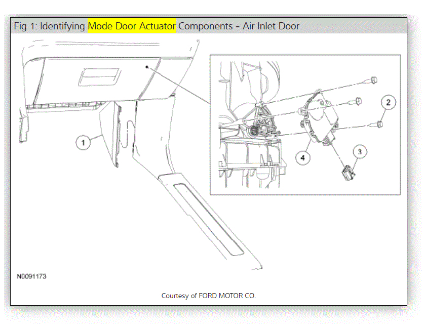

Which one is now making noise? I attached a pic below. Is this the one you replaced? Is it making noise again since the other one was replaced?

As far as I knew there were 3 actuators. One by the gas pedal. One on the passenger floorboard under the center console. And one behind the dash to the right of the navigation screen display and behind the left side of the glove box. The pic you sent looks like it shows one on the right side of the glove box.
The one still clicking is the one by the passenger floorboard (left side) under the center console. I just replaced it, but it didn’t start clicking until I then next replaced the one behind the dash left side of glovebox because the one that is now clicking didn’t fix my initial problem.

Looking at your drawing again, I see that it says mode door actuator. I believe this is the one that is up near the gas pedal.
I have replaced that one in the past, but no issue with it during this fix.

You are correct, that is the mode actuator. Tell me, is the present issue related to temperature control, air flow direction, or fresh/recirculated air issues?
