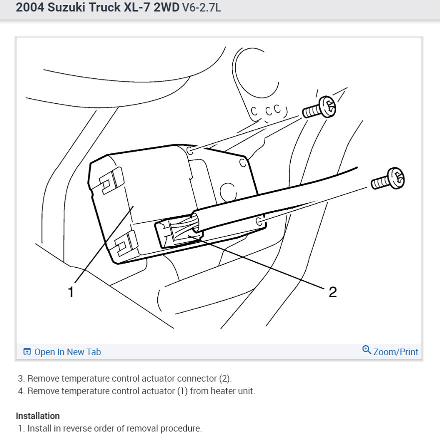

I had an old fault codes related to my A/C B1504 and B1513. Whenever I try to clear those codes come back on my scanner after few miles.
Actually my A/C works fine while driving but no cooling on idle although same air blow.
What would be the problem and how to fix it?

Sorry I forgot to mention that B1504 shows sun load sensor circuit and B1513 shows temperature control actuator.
Oct 17, 2018 at 4:04 PM
  • 55,423 POSTS
The problem could be shorted a shorted temperature blend door actuator. Here is a guide that can walk you through it and the location of the actuator for your car:
