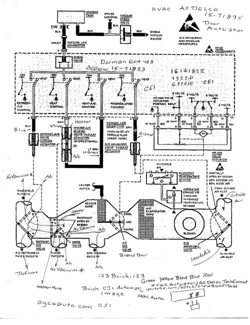

HVAC climate control. Where may a cross section/schematic diagram be found, showing dual zone air doors and all other air doors, together with actuators for same?
Feb 15, 2019 at 2:46 AM

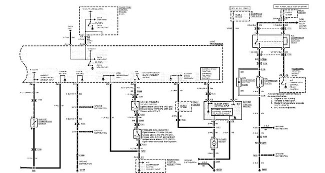

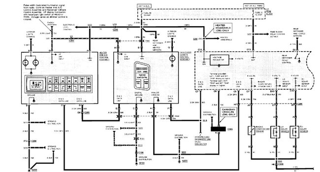

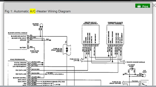

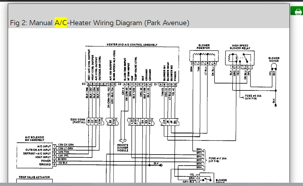

Good morning,
I attached the wire diagrams for you to view as requested.

Thank you, appreciate the information you have offered. I have a question; Is the “cross section/schematic diagram” enclosed, for a 1991 Buick Park Avenue with a “Dual Zone, Climate Control” HVAC system. If the enclosed diagram is not for a “Dual Zone, Climate Control” unit, where may I find the proper diagram.
Feb 17, 2019 at 12:40 AM
The diagrams we provided are for your exact system.

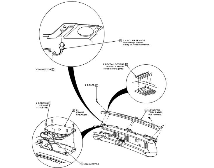

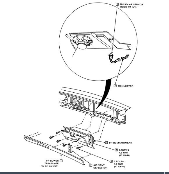

Okay, that could be the temperature sensor in the car.
They are called solar sensors. I attached a picture of the location of both the left and right side sensors.
Mar 12, 2019 at 6:13 PM
WELDONAB+FORUMS
  • 16 POSTS
Okay, will check the sensors tomorrow. The temperature difference from driver's side to passenger's side outlets is near fifteen plus degrees.

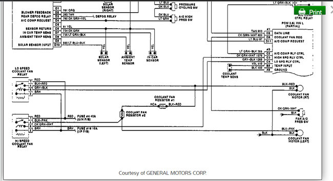

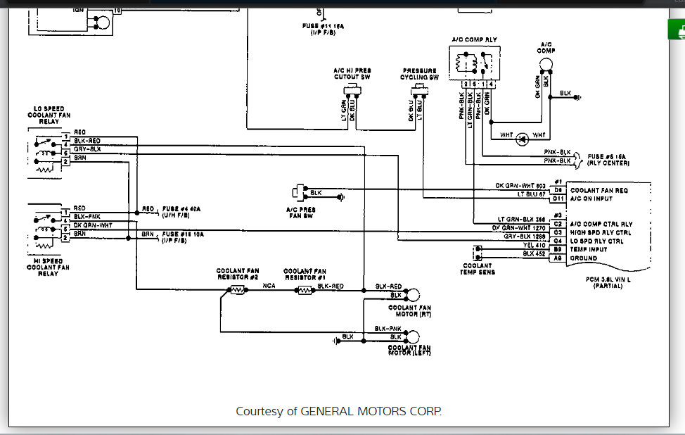

I have included the wiring diagrams for your vehicle's HVAC system in the diagrams down below. This is the only information I could pull up in my two reference sources for it. Please go over them and get back to us with what you are able to find out.
Thanks,
Alex
