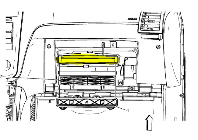

I can hear the front blower through all the speeds but only a little air coming from dash vents, nothing on floor or defrost. Any ideas?
Feb 26, 2022 at 10:31 AM
  • 110,194 POSTS
The first thing I would check is the cabin air filter. If it is plugged, it will prevent air from circulating through the system.
I attached a pic below of the filter's location. Have you checked this yet?
See pic below.
