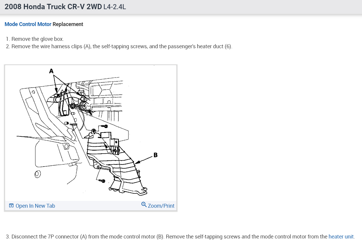

Blower working fine at all speeds. Both problems began at same time. Please help!
Sep 8, 2019 at 10:14 PM
Experienced Mechanic
55,740 POSTS

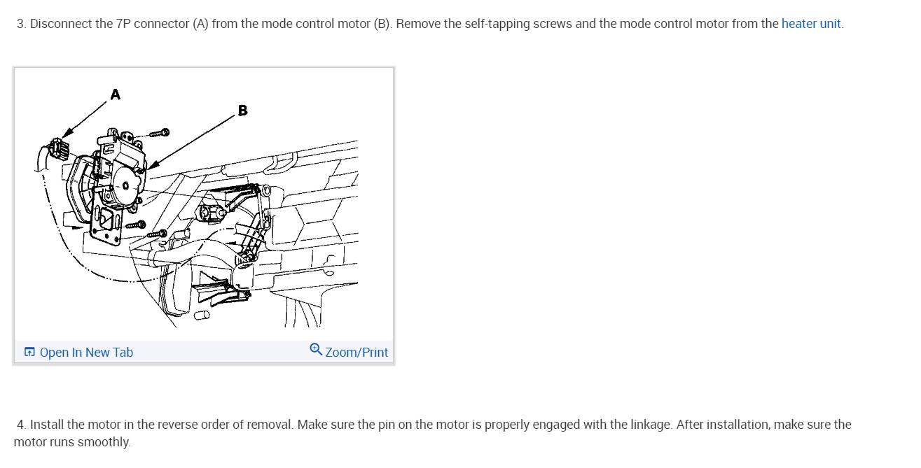

This happens when the mode actuator goes out. here is a guide that will walk you through the steps with diagrams below to show you how on your car:
