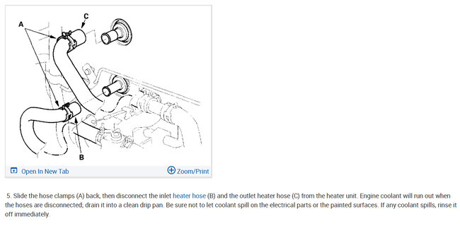

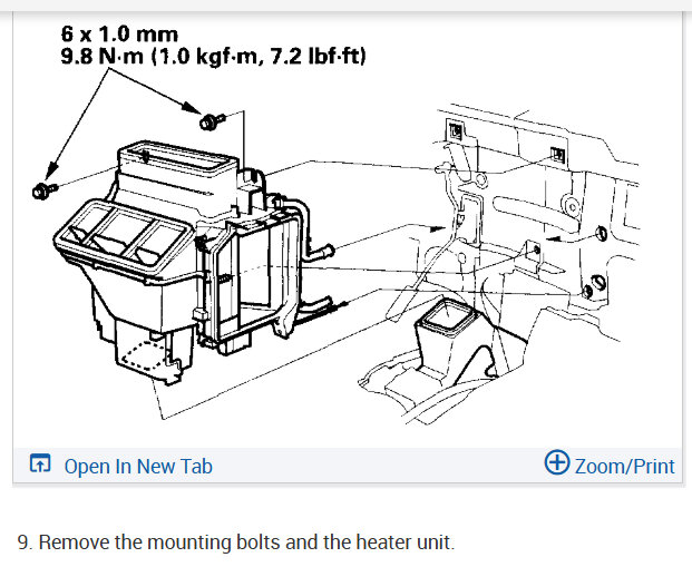

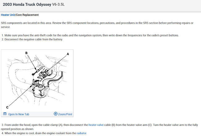

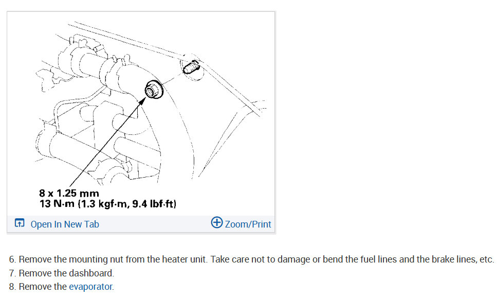

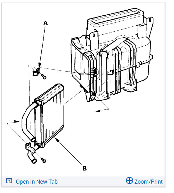

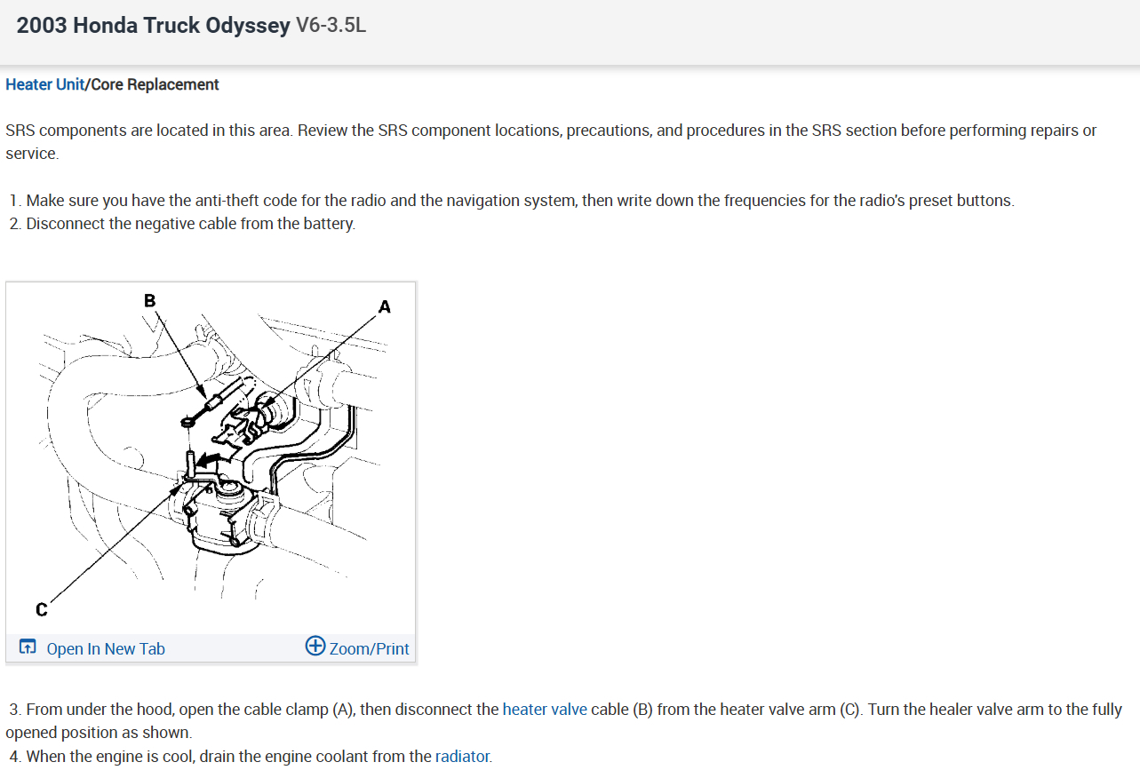

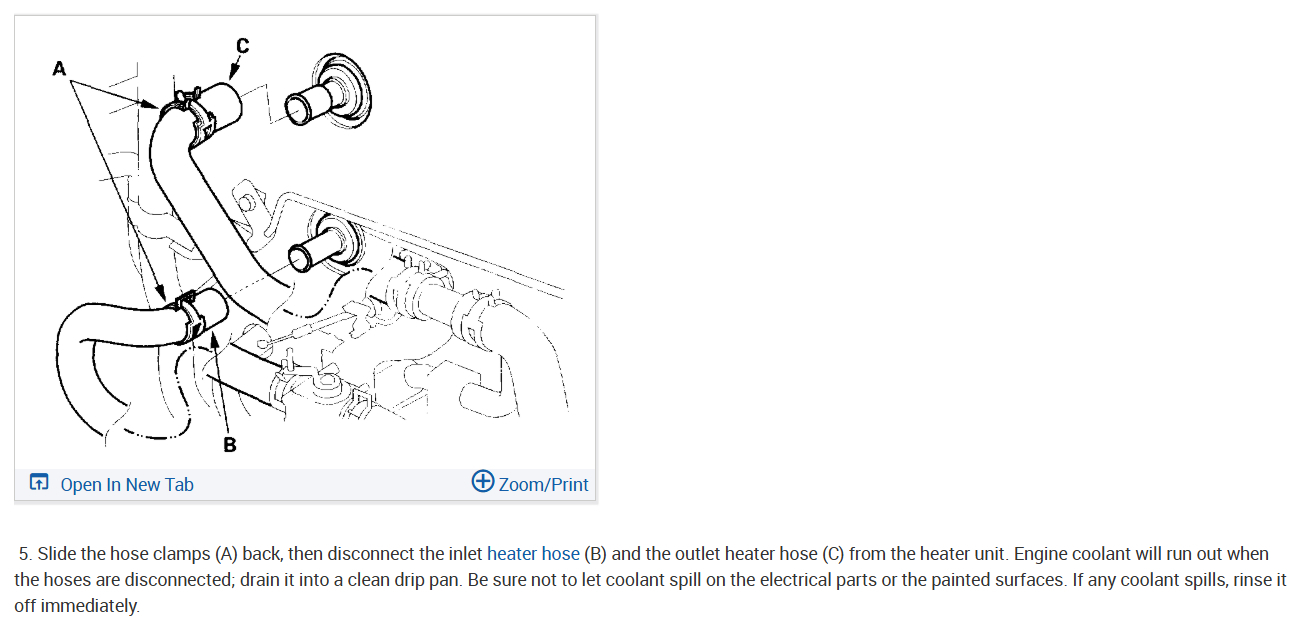

Is it necessary to remove the whole steering wheel or dismantle it, when you are removing the heater core, or can you just lower the steering column to remove the dashboard, can you provide a step by step method? Thank you.
Nov 30, 2024 at 3:20 PM
  • 55,421 POSTS

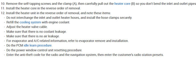

You can just lower the steering column to get it out of the way. It does not look like you will need to vacuum down the AC system so that part is good, here is how to change out the heater core, start by draining he cooling system and disconnect the battery. Check out the images (below). Let us know if you need anything else.
Dec 1, 2024 at 4:21 AM
EARTHMOBILE
So I don't need to take the steering wheel off, just unloosen the brackets and let the steering column hang on the seat. What about the pinch bolt at bottom, it should be okay?
Dec 1, 2024 at 1:52 PM
  • 55,421 POSTS
You should be okay, but I would support the column as too not stress the connection at the pinch bolt.
