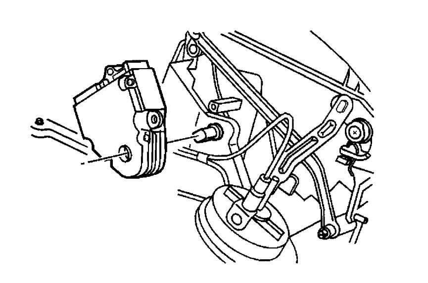

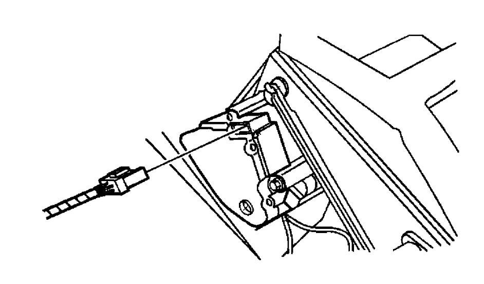

I have air blowing through the defrost, middle, and floor vents at the same time. However, if I select the defrost, the windshield clears up relatively quickly. When I increase the temperature, the air on the passenger side heats up as expected. The air on the driver's side remains cold.

The actuator on the left side sounds like it is not functioning. I attached pictures and the procedure for replacing it.
As far as the other issue, do you have sufficient air flow from the vents with the AC on?
REMOVAL PROCEDURE
imageZoom/Print
1. Remove the left instrument panel insulator.
2. Remove the knee bolster.
3. Disconnect the electrical connector from the temperature valve electric actuator.

4. Remove the mounting screws from the temperature valve electric actuator.
5. Remove the temperature valve electric actuator.
