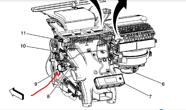

Sometimes only blows cold air on drivers side but passenger side is hot. I can’t see to find the blend door actuator for that.
Feb 1, 2026 at 3:47 AM
  • 55,694 POSTS
So the driver side blend door actuator is on the left side of the HVAC plenum above the accelerator pedal. Make sure to reset the system once the part is replaced, here is a guide to help.
https://www.2carpros.com/articles/step-by-step-guide-to-reset-your-cars-hvac-system-an-essential-for-every
Check out the images (below). Let us know if you need anything else.
