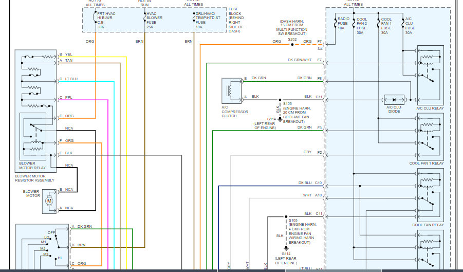

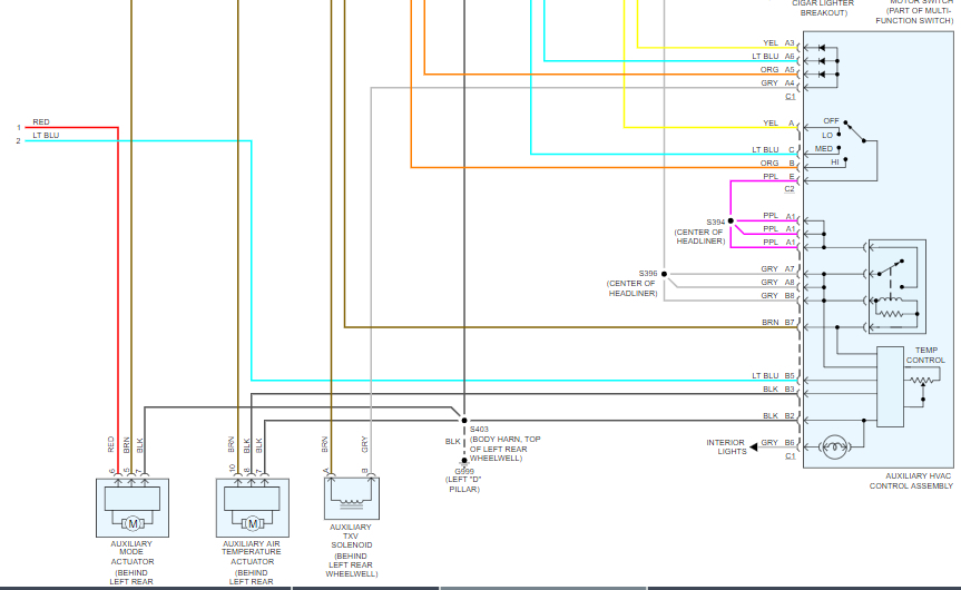

Previous owner disconnected wire that controls the heat and connected that to only cool air. How do I reverse what was done? The when on red it throws out cool not heat.

Good evening,
What wire? Where? Can you post a picture of the wire?
There are many controls for heat.

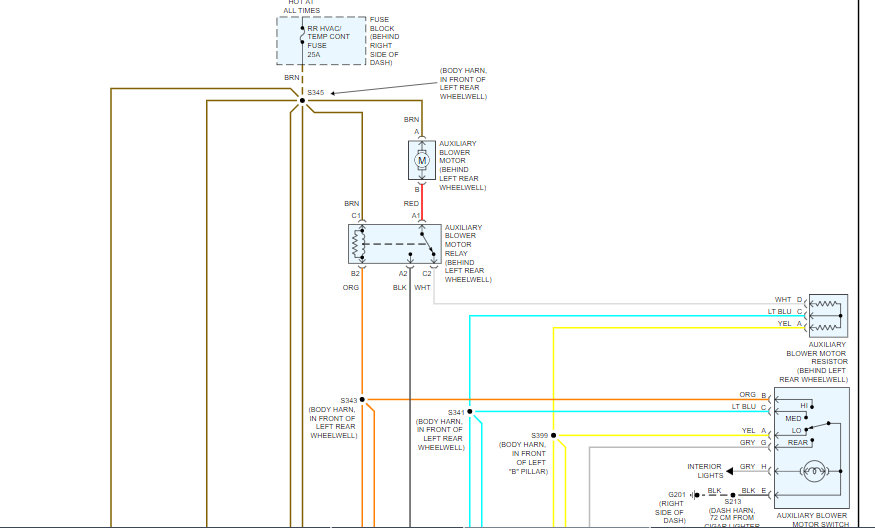

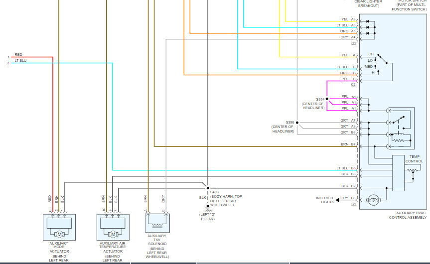

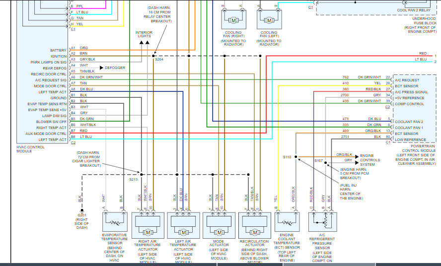

Here are the diagrams. What wire did he disconnect?
