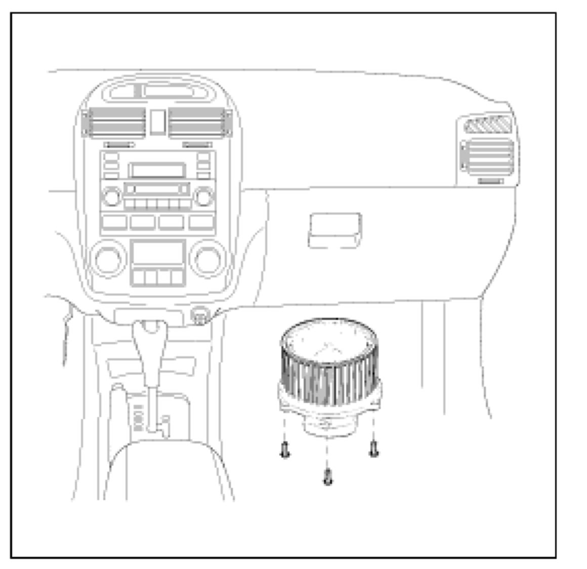

It has 3 motors for the A/C unit. There are 2 on drivers side and 1 to the side of glove box. I need to replace the 1 next to glove box but can't find any information on what that motor is called or even the part number for it. It hangs when switching between inside and outside air.

If you are referring to the blower motor, there is only one. It is located under the dash and behind the glove box. If it is something different, let me know.
Here are the directions for replacement. The attached picture correlates with the directions.
BLOWER MOTOR
BLOWER MOTOR
REPLACEMENT
1. Disconnect the negative (-) battery terminal.
2. Disconnect the connector of the blower motor.
Pic 1
3. Remove the blower motor after loosening the mounting screws.
4. Install in the reverse order of removal.
