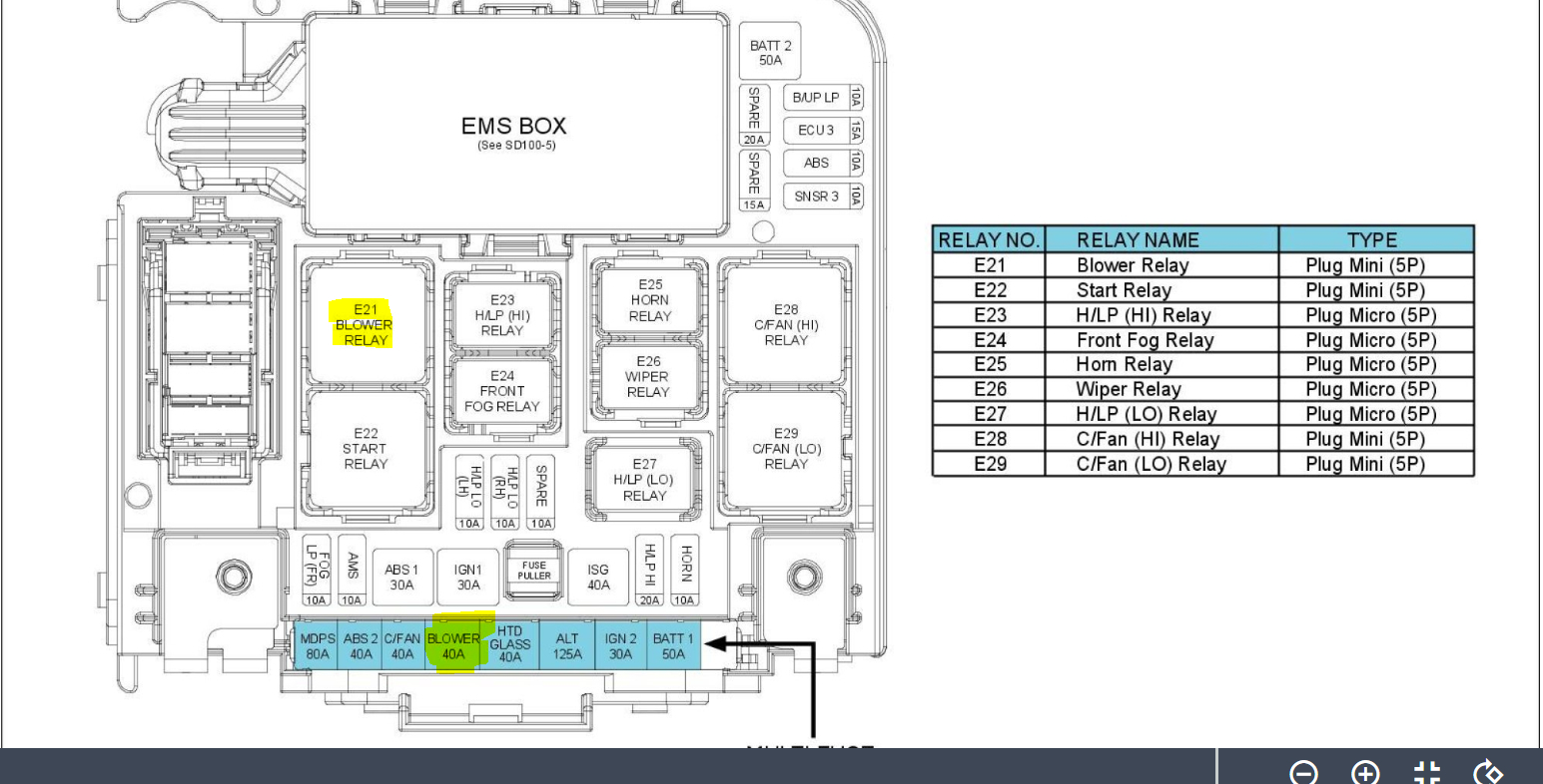

This air doesn't blow at all. I have changed the cabin filter the blower motor and the blower motor resistor none of that has worked.
Jan 6, 2020 at 12:49 AM
  • 110,244 POSTS
Have you checked the blower motor relay and fuse? If you look at pic 1, I highlighted both which are located in the engine compartment fuse box. If you haven't done this, check them and let me know what you find.
