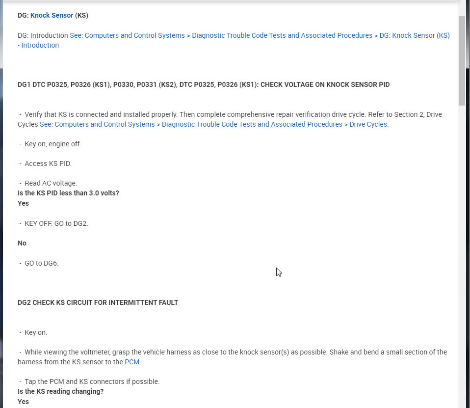

My car has I PO301 and a PO325. The misfire is random. I am looking for testing procedures. I am going to swap injectors to see if I can move the problem, but I am not sure how to test the coil. Does this car have a waste spark system so I can swap wire locations.(it does not have COP'S)
I am also trying to find the test procedure for the knock sensor. I have checked for resistance. there was no reading.. open circuit.

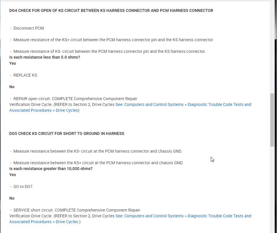

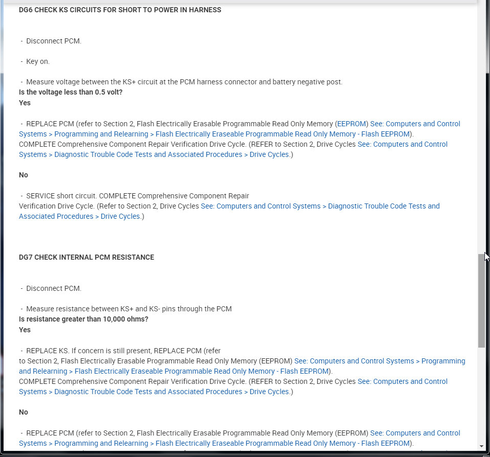

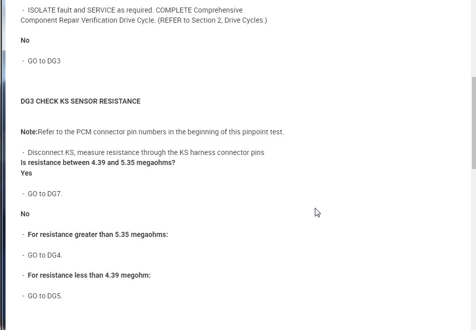

So you checked resistance across the sensor itself? If you have an open circuit here then I would replace the sensor and retest the misfire because a faulty knock sensor can cause an intermittent misfire.
I attached the testing for this knock sensor code as well however, I suspect you won't get past step 4. They have you testing the circuit from the PCM but if you checked the sensor and it is open then I suspect that is the reason for this code.
Let me know if you have questions. Thanks
Oct 22, 2020 at 4:26 AM (Merged)
DAVEMALLARY
  • 14 POSTS
Yes, I checked resistance across the sensor itself, and it is open. I can't find the Knock sensor pid on my scanner.. I have an Autel 708. I don't really know how to use it, I bought it for educational purposes. I will get a new knock sensor and go from there.

I meant to update this sooner. I replaced the coil and the PCV valve. I ordered the wrong knock sensor so it did not get replaced. The codes are still gone and have not come back. The car has developed an intermittent oil leak. It will leave a puddle and a trail of oil occasionally after starting the car. It has happened 3 times that I know of. Do you have any guesses on what it could be?
