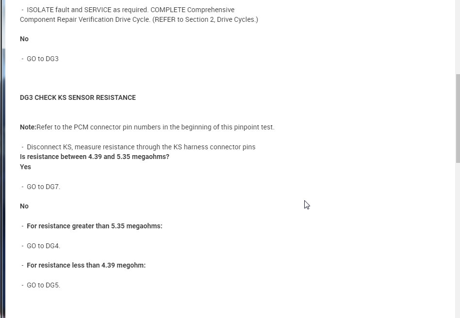

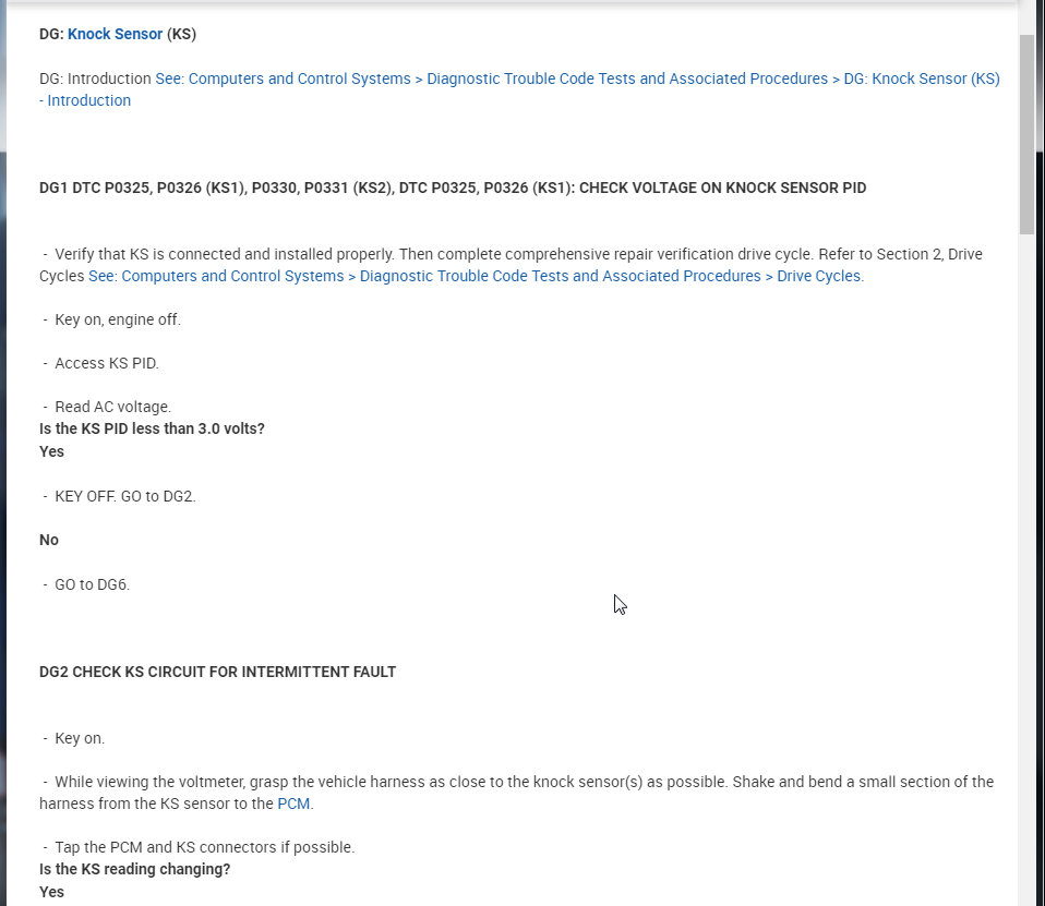

My car has I PO301 and a PO325. The misfire is random. I am looking for testing procedures. I am going to swap injectors to see if I can move the problem, but I am not sure how to test the coil. Does this car have a waste spark system so I can swap wire locations.(it does not have COP'S)
I am also trying to find the test procedure for the knock sensor. I have checked for resistance. there was no reading.. open circuit.

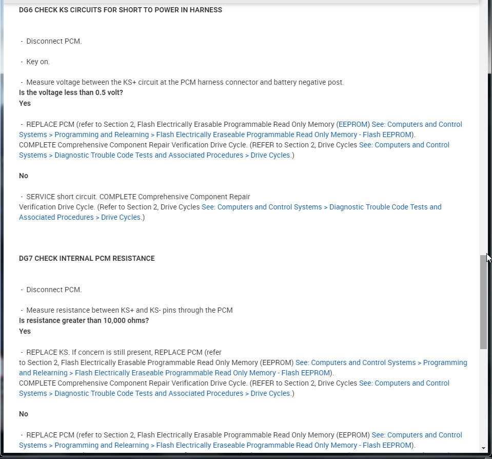

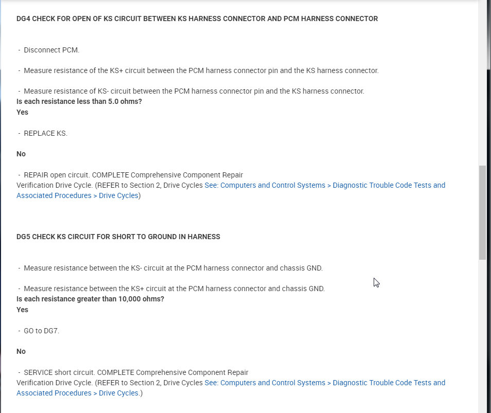

So you checked resistance across the sensor itself? If you have an open circuit here then I would replace the sensor and retest the misfire because a faulty knock sensor can cause an intermittent misfire.
I attached the testing for this knock sensor code as well however, I suspect you won't get past step 4. They have you testing the circuit from the PCM but if you checked the sensor and it is open then I suspect that is the reason for this code.
Let me know if you have questions. Thanks

Yes, I checked resistance across the sensor itself, and it is open. I can't find the Knock sensor pid on my scanner.. I have an Autel 708. I don't really know how to use it, I bought it for educational purposes. I will get a new knock sensor and go from there.
I suspect the coil is weak. I was using my spark tester to see how far the spark would jump from the coil. #1 would not jump out of the top of the coil, but # 4 would jump out about three quarters of an inch. I did not test the others. Does that sound like a weak coil to you?
