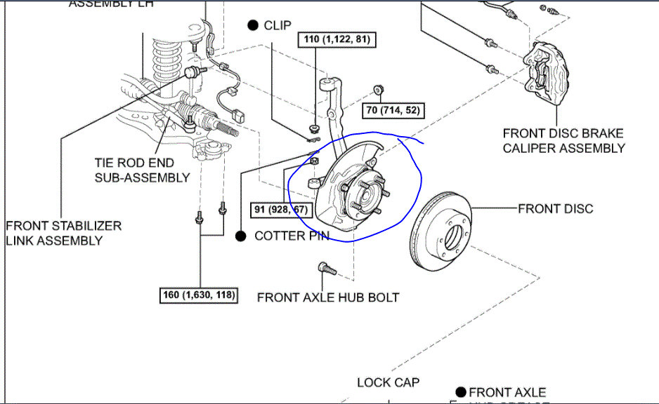

When I am accelerating between 80-120 kph I hear the humming noise .

Good afternoon,
As far as the noise, none of the tune up things needs to be addressed at this time for your noise.
The noise could be coming from several places.
https://www.2carpros.com/articles/whirring-sound
1. Tires. If the tire are worn, they will give you road noise. Try rotating the tires and see if the noise changes.
https://www.2carpros.com/articles/how-car-tires-work
2. Bearings. You have hub bearings in both the front and rear of the truck and if they are worn, this is a common reason.
https://www.2carpros.com/articles/bearing-hub-replacement
The other thought is the drive line making the noise. Can you upload a video of the noise so I can hear it? It will help me identifying it.
As far as the tune up, as long as it is running good at the moment, replace the plugs and the filters such as air and fuel filter. That would be a good start.
https://www.2carpros.com/articles/how-to-change-spark-plugs
https://www.2carpros.com/articles/how-to-change-a-fuel-filter
