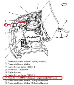

need location of IAT sensor and what two wires from MAPsensor control it. Thanks

IAT sensor is between air cleaner and throttle body. what engine size do you have?
https://images.2carpros.com/forum/automotive_pictures/261618_Noname_2154.jpg

3.5 5 cyl found connector integrated with MAS plug five wires. which two control iat?

the IAT wiring will be the light blue wire and the black wire.
the pink, yellow and black/white wires are the MAF wiring.

that confirms whatI've been told. Thank you!
