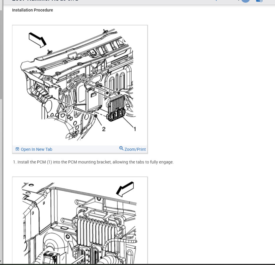

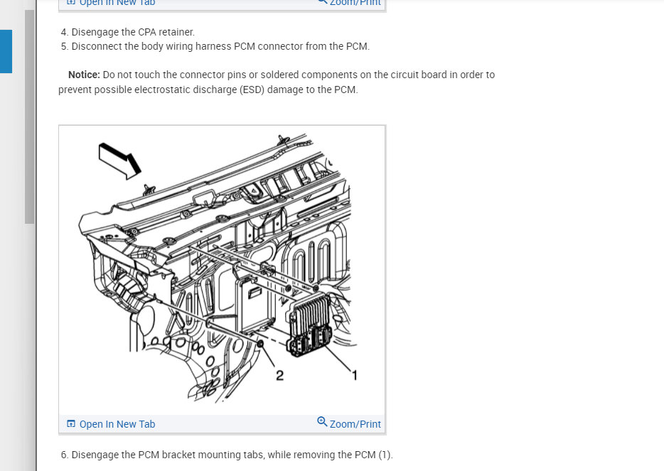

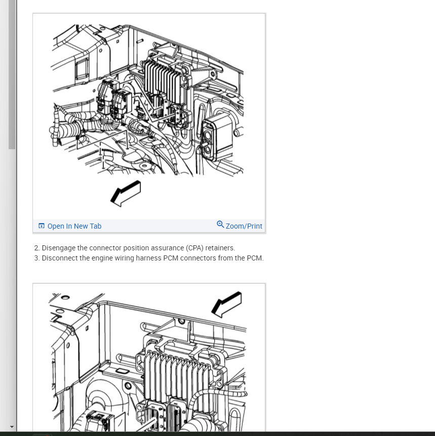

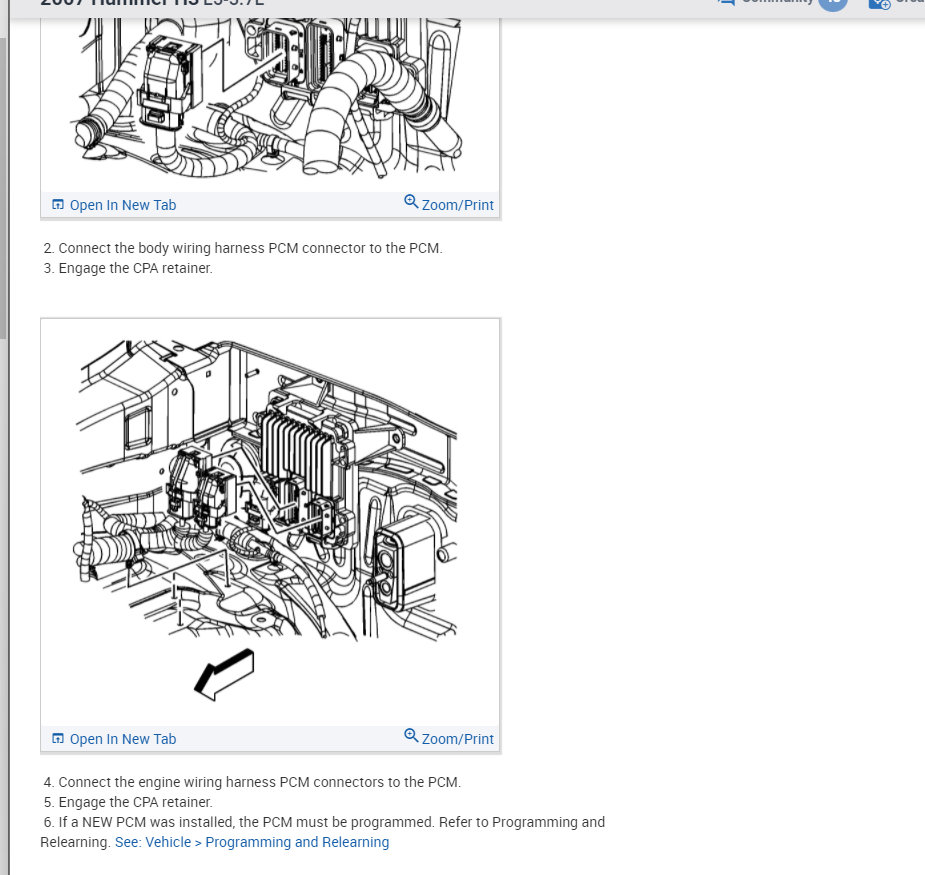

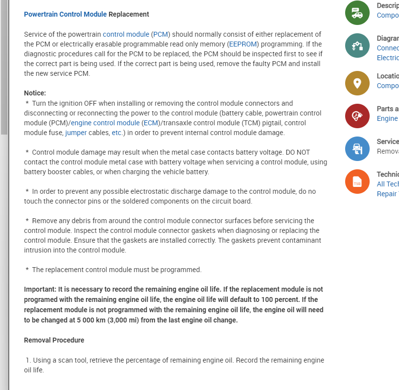

I need to replace my PCM can you tell me how and give the location as well?
Feb 18, 2010 at 10:15 AM

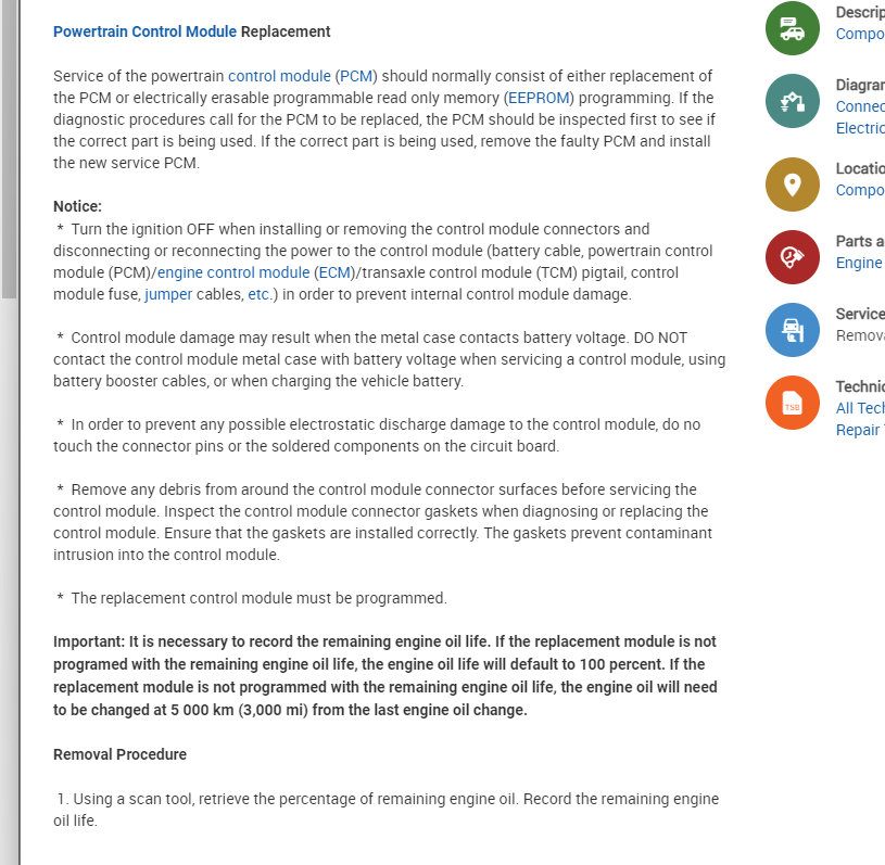

Please see the attached info for the detail that you are requesting.

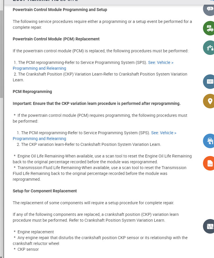

I am attaching the process to relearn the systems after the replacement as well.
Please run through this and let us know what other questions you have on this or how you make out.
Thanks for using 2CarPros.
