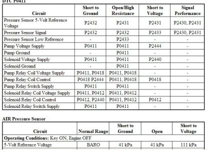

2007 Hummer H-3 code issue unable to clear code po411 Reads secondary air inadequate upward flow #1.replaced valve then reset code code then read po411/po418 issue came about around December 2009 to present ran diagnostics relay,pump,pressure,sensors read okay still unable to pass N.Y. inspection. Vehicle runs fine any suggestions

i don't know if this will help or not but it tells which codes are set and maybe you can check, but from the manual i have it says to much or a a voltage problem or a ground problem but, it could also be a bad connection as well.......
https://images.2carpros.com/forum/automotive_pictures/406719_chart_1.jpg
hoepfully you can test your system now....
