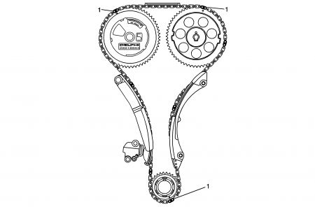

i will like to know were are the timing marks (timing belt) and if you can send me a diagram?
Sep 28, 2010 at 3:08 PM
MHPAUTOS
  • 31,937 POSTS
This engine uses a timing chain not a belt. do you still require cam timing information?

i need to now where are the timing marks if you have a diagram.

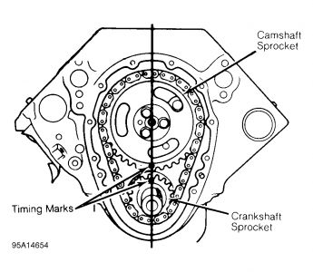

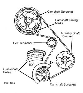

MHPAUTOS
  • 31,937 POSTS
hi there, I did find a chain and belt timing picture. i hope that these are of help. Mark (mhpautos)

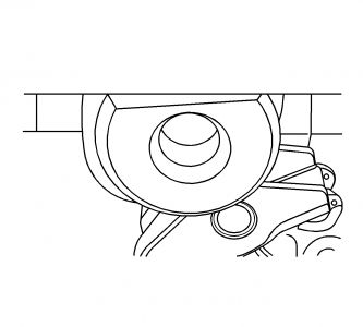

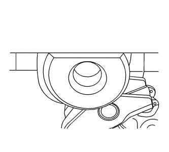

The previous information is not for the 3.5L, this is from a bulletin, and it shows the possibilities. If you do not have the front engine cover off, did you wedge the timing chain tension-er prior to removing the sprockets? If you did, this should be easy. If you did not, then the tension-er has fully extended, and there is no way to depress it until you remove the front cover and release the lock. #PIP3668A: SES Light After Internal Engine Repairs Due to DTC P0017 - keywords after cam correlation crank cylinder DTC head induced previous replacement seal since spring timing valve - (May 24, 2006) Subject: SES Light After Internal Engine Repairs due DTC P0017 Models: 2004-2006 Chevrolet Colorado 2004-2006 GMC Canyon 2006 Hummer H3 with 2.8L Engine (VIN 8 - RPO LK5) or 3.5L Engine (VIN 6 - RPO L52) This PI has been superseded to include 2006 model years, line art, and additional mechanical engine timing information. Please discard PIP3668. The following diagnosis might be helpful if the vehicle exhibits the symptom(s) described in this PI. Condition/Concern: A P0017 DTC may be encountered if the timing chain tensioner had to be reset during repairs, such as cylinder head replacement, this concern may be the result of incorrect cam to crank timing. As the timing chain tensioner is released, chain slack between the crankshaft and tensioner shoe is eliminated. As this occurs, it is very easy for the timing chain to shift one tooth at the crankshaft sprocket without being noticed by the technician, resulting in incorrect mechanical timing and a P0017 DTC. This can be hard to detect upon reassembly because it is possible to install the cam holding tool on the rear cam flats of a mistimed engine if the #1 piston is not EXACTLY at TDC. Additionally, if the cam holding tool (J-44221) has ever been used to hold the rear cam flats to break the camshaft sprocket bolts loose, tool damage may have occurred. As a result, it may be possible to install a damaged cam holding tool on the rear cam flats of a mistimed engine. Due to these factors, a technician may believe that a mistimed engine is timed correctly. On 2004 - 2005 2.8L and 3.5L engines, a P0017 DTC may be experienced if the exhaust camshaft actuator was damaged during internal repairs. The spline style exhaust camshaft actuator used on 2004-2005 2.8L and 3.5L engines is designed to operate between 25 degrees of retard and 0 degrees (full advance/rest/clockwise position). There is a stop tab inside of the camshaft actuator that prevents the exhaust cam from advancing beyond the rest position under normal operating conditions. This tab can bend if the exhaust cam/actuator is forced to rotate beyond the rest position (full advance/full clockwise) during internal engine repairs. This type of damage should not occur on 2006 model year and newer 2.8L and 3.5L engines because they are equipped with a vane style exhaust camshaft actuator, which is designed differently than the spline style actuator. Recommendation/Instructions: If the SI diagnostics do not isolate the cause of the P0017, the following information may help: Ensure proper mechanical timing by removing the cam cover and rotating the crankshaft up to 14 times while watching the timing marks on both cam sprockets. The timing marks should both line up with a darkened timing chain link as shown below once every 14 crankshaft revolutions. If the cam sprocket timing marks never line up as shown below, one of the cams is mistimed and should be corrected by following SI procedures.
https://images.2carpros.com/forum/automotive_pictures/309872_1257812_1.jpg
If there is no problem found on step 1, use a TDC indicator and rotate the crankshaft clockwise until the #1 piston is EXACTLY at top dead center on the compression stroke. Important: Always rotate the crankshaft clockwise to place the #1 piston on top dead center to prevent timing chain slack from effecting the position of the camshafts. If the crankshaft is turned past #1 top dead center, rotate the crankshaft counter-clockwise at least 45 degrees before attempting to find top dead center again. With the #1 piston EXACTLY at top dead center, place a straight edge across the rear cam flats and note the orientation of the cam flats. If both of the rear cam flats are rotated in the same direction as shown below, the timing chain is off a tooth at the crankshaft and should be corrected by following SI procedures.
https://images.2carpros.com/forum/automotive_pictures/309872_1828934_1.jpg
If both of the rear cam flats are exactly horizontal (flat) as shown below, the engine is timed properly.
https://images.2carpros.com/forum/automotive_pictures/309872_1828930_1.jpg
If the rear exhaust cam flat of a 2004 - 2005 2.8L or 3.5L engine is rotated toward the driver side as shown below but the rear intake cam flat is horizontal (flat), the camshaft actuator sprocket may be been damaged during previous repairs. If camshaft actuator damaged has occurred, it will be necessary to replace the exhaust camshaft actuator again, taking care not to damage it upon reassembly. As mentioned in SI, do not force the camshaft actuator to rotate clockwise upon assembly. If it does not move easily, it is already fully advanced. New camshaft actuators are already packaged in the fully advanced (clockwise) position.

This was what i was looking for thanks. now if you can tell me how to vote in here or if i can make a donation by credit. i do not have Master Card or Visa i have American Express if you like to exchange information i have the Mitchell on demand program. However, the Hummer is not on there if you need something let me now.
