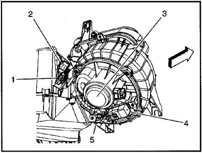

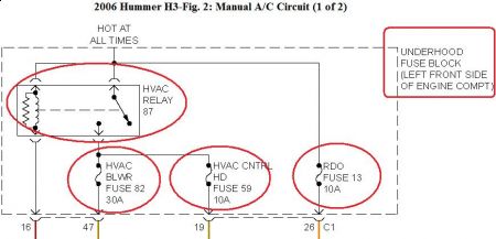

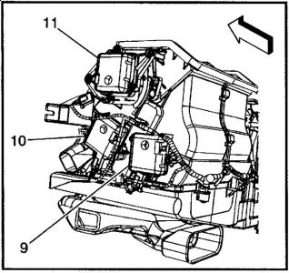

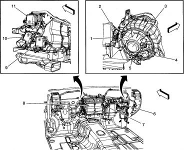

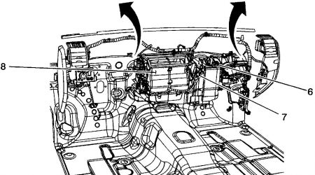

It may be the blower motor resistor, and quite possibly the blower motor itself. But before we rule any of those, please check these fuses and relays first.
https://images.2carpros.com/forum/automotive_pictures/55316_06h3blower_1.jpg
If they are all OK, then replace your resistor.

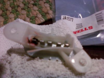

Our 2006 did the same thing, no blower. We replaced the resistor that is under the dash. Auto Zone part, 40+-$. The harness was melted to the white plastic casting because of the heat at the orange terminal. There is a white plastic retaining pin at the harness plug you have to remove to seperate the resistor. My harness was black but I was able to scrape it clean enough to make a sort of connection and the blower began to work as the harness connectors were jiggled. Now to wait for The national highway administration to recall this as it is a fire hazard. Mine is working for now but I am sure the symptoms will reapear as a full fix and it is a defective design.
