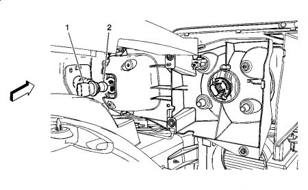

The front directional bulb went out. I have removed the grille, but can't tell how to access the bulb ro replace it. Please help.

please tell me how to access the bulb to replace it. I have already removed the grille

Hello .. thanks for the donation .. much appreciated Daytime Running Lamp, Park and Turn Signal Lamp and Bulb Replacement - Front Preliminary Procedure Remove either the RH or LH front wheelhouse panel. Disconnect the electrical connector from the daytime running lamp (DRL) bulb socket. 1...Socket, Daytime Running Lamp Bulb Tip: Twist the lamp socket counterclockwise to remove. 2...Bulb, Daytime Running

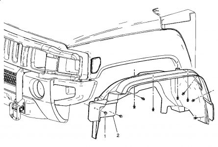

Thank you so much for your reply. Please tell me how to remove fasteners that hold wheel well in place.

Wheelhouse Panel Replacement Fig. 20: Wheelhouse Panel Replacement
https://images.2carpros.com/forum/automotive_pictures/266999_hum_2.jpg
Wheelhouse Panel Replacement Lift and support vehicle. Remove the front wheel. Remove Wheelhouse panel screws/retainers (if fitted with push pin retainers .. pull center pin of retainers from outer ring) 1...Retainer, Front Wheelhouse Panel (Qty: 10) 2...Panel, Front Wheelhouse
