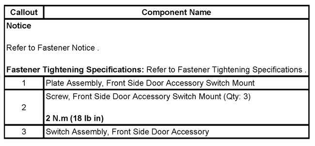

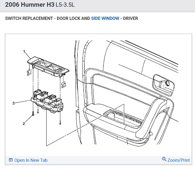

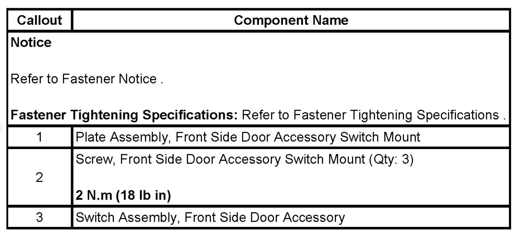

I unhooked my battery cable and when I hooked it back up my power door locks and drivers side power window stopped working?
Jan 13, 2009 at 3:42 AM
DEWEEDON
It sounds like you knocked out the driver door switch when you reconnect the battery from a voltage spike. There is a logic module inside the switch. Here is the location to help you fix the problem. Check out the diagrams (Below). Please let us know what happens.
Mar 26, 2010 at 3:03 AM
JIMM1416
Thank you for this post, I got a new switch for $98.00 and installed it all fixed! I love this site.
