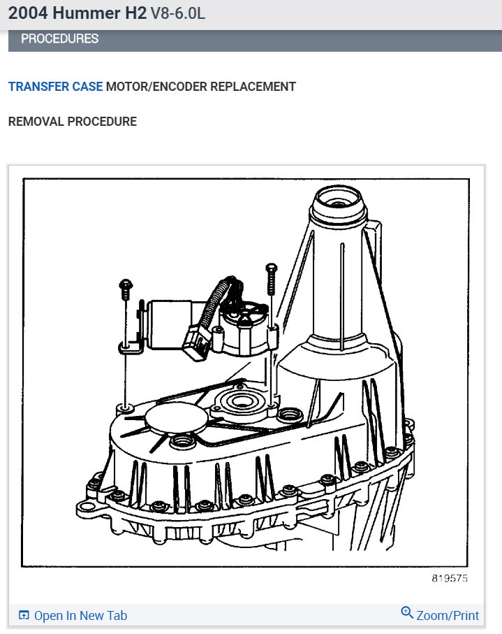

When trying to engage into either high lock or low lock, a message appears "service 4wd" and the H2 Hummer just stays in the regular all wheel drive mode. This started happening last winter and is consistant in cold weather when in MT. When I am in Houston this rarely happens, it usually will engage in either high or low lock. Someone told me the electrical actuator needs to be replaced with a pneumatic actuator. Thoughts?
Dec 18, 2008 at 7:12 PM
BRIAN 1
  • 1,030 POSTS

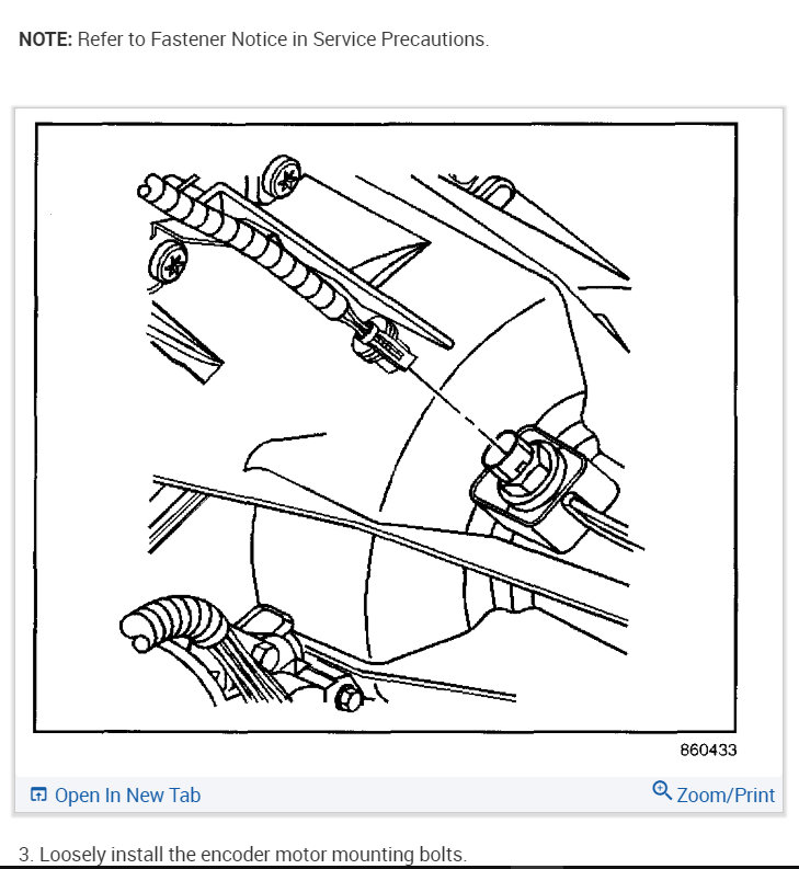

It sounds like the transfer case encoder is out, here are diagrams to help you change it out. Check out the diagrams (Below). Please let us know what happens.
Dec 18, 2008 at 7:39 PM
DUFFER69
Thank you for this post I got a new encoder for $127.00 and all set! thanks guys :)
Dec 10, 2018 at 7:24 PM
