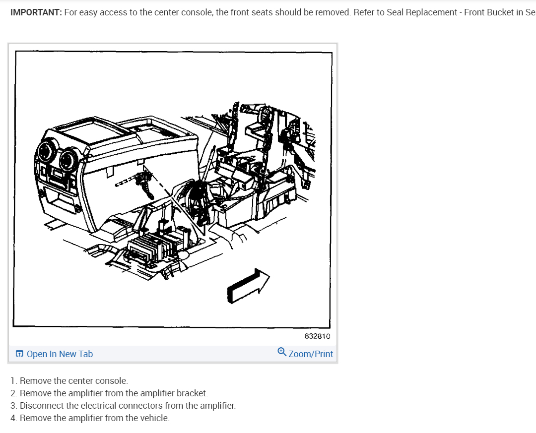

How do I replace my amp?
Friday, May 15th, 2009 AT 5:18 PM
3 Replies
DR LOOT
  • 2,311 POSTS
The factory amp is located under the center console. Here is how you can replace the amplifier. Check out the diagrams (Below). Please let us know if you need anything else to get the problem fixed.
Tuesday, May 19th, 2009 AT 11:20 AM
HOWIE0
All I want is sound. I don't need fancy but that is where my question is, I don't know what to take a part to replace it. From what I have been told that it is fairly complicated to replace a Bose with anything else so I was planning on finding a used one from a yard or e-Bay.
