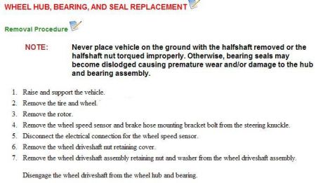

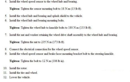

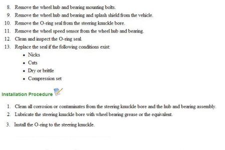

How do I change the Hun Bearing on my 2003 Hummer.

https://images.2carpros.com/forum/automotive_pictures/261618_Noname_1150.jpg
https://images.2carpros.com/forum/automotive_pictures/261618_Noname2_332.jpg
https://images.2carpros.com/forum/automotive_pictures/261618_Noname3_124.jpg
