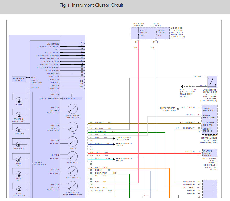

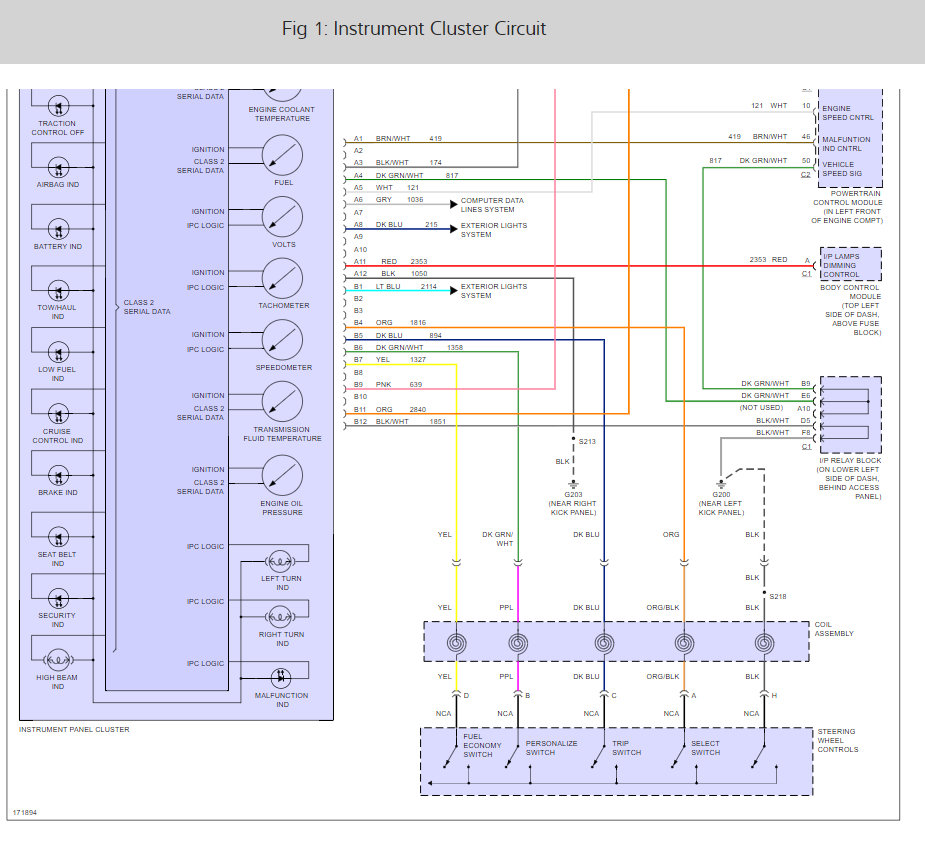

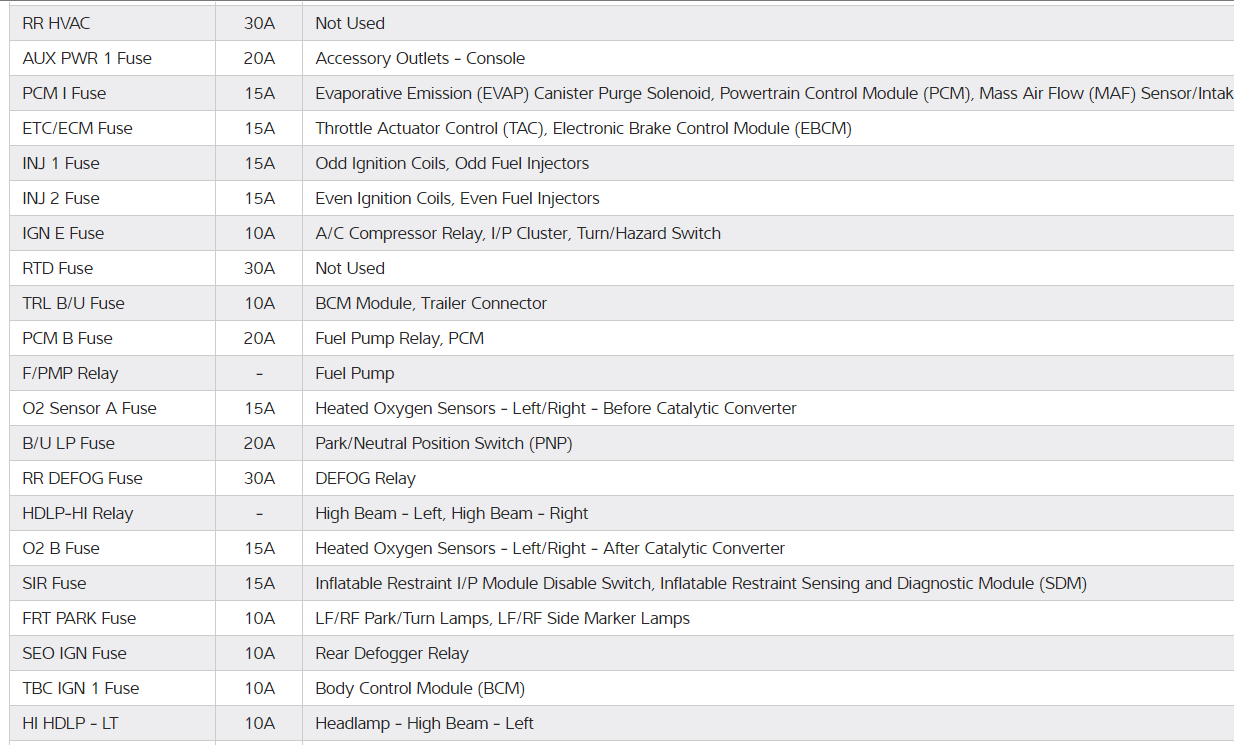

All of my gauges on my dash have stopped working. The lights still work but nothing else "moves when I crank it up. What could this problem be?
Oct 30, 2008 at 3:18 PM
HUMMER 1

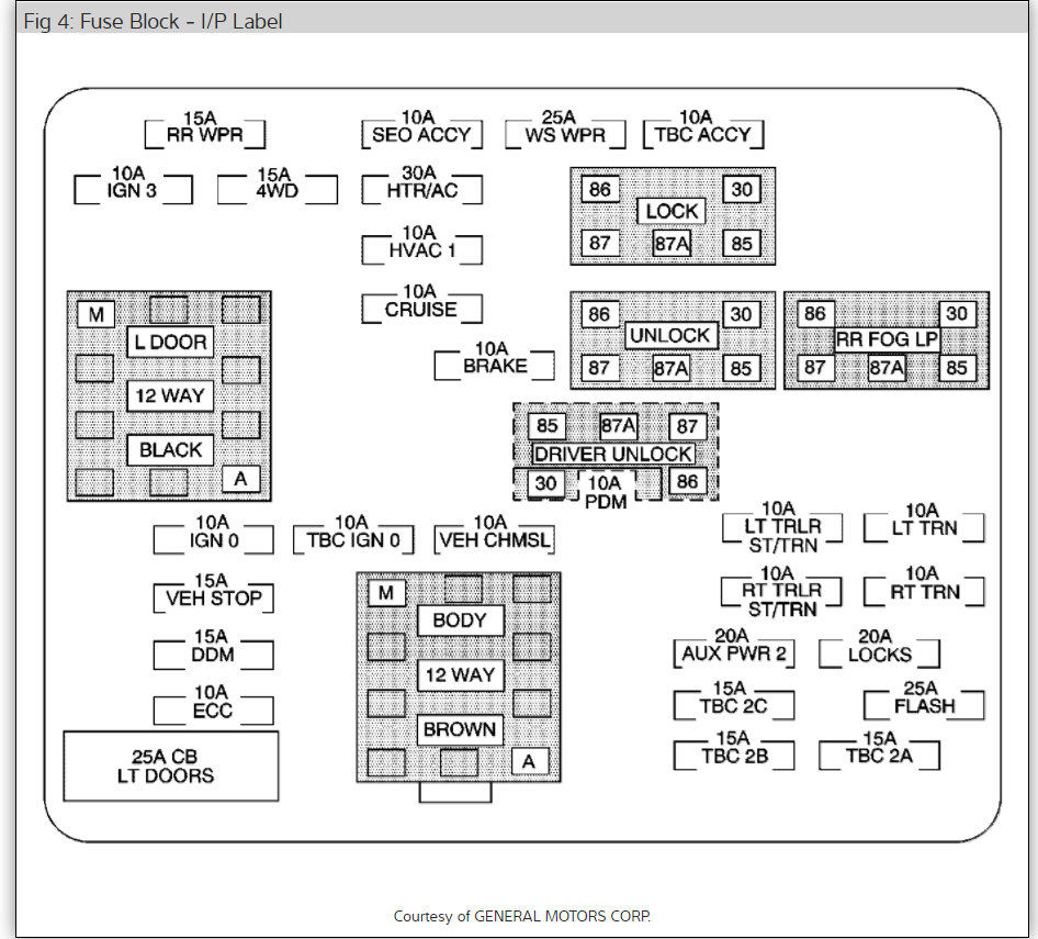

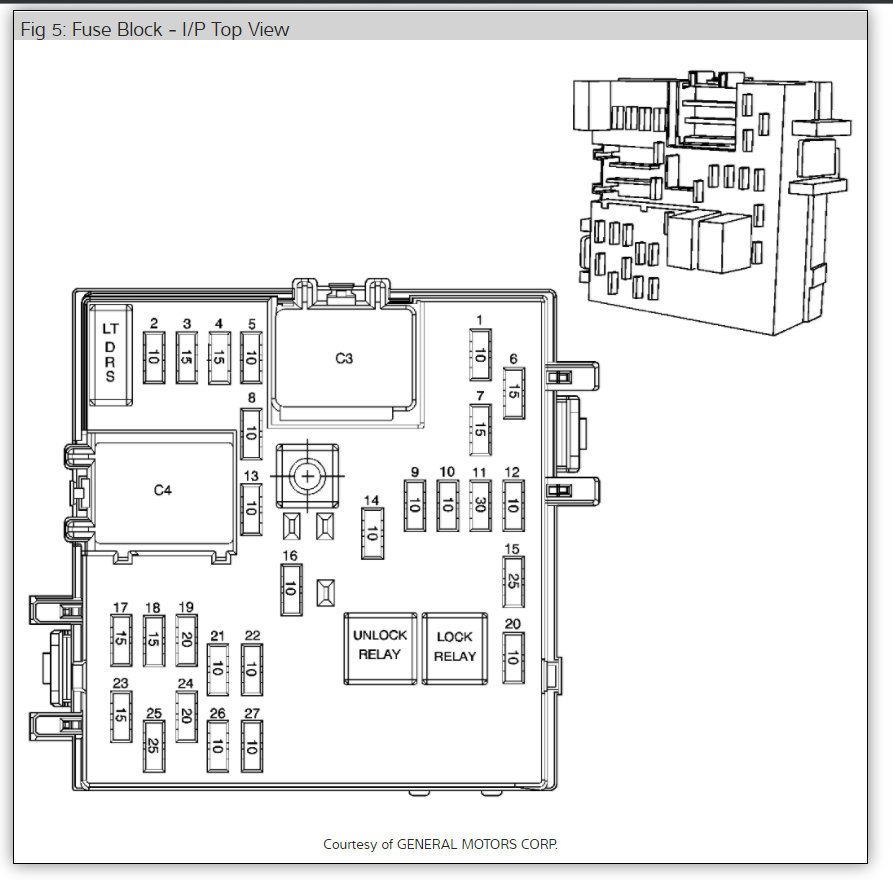

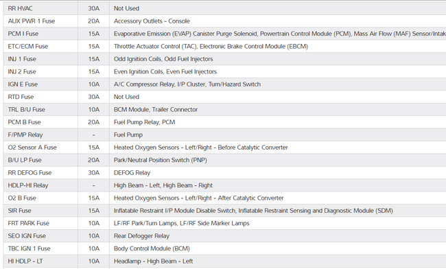

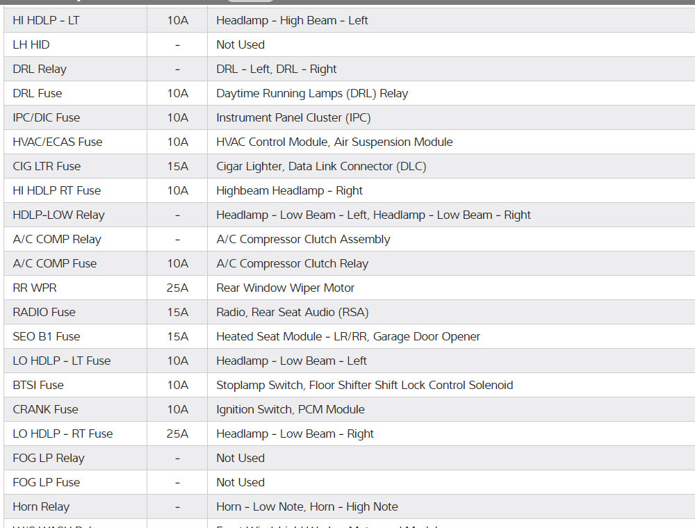

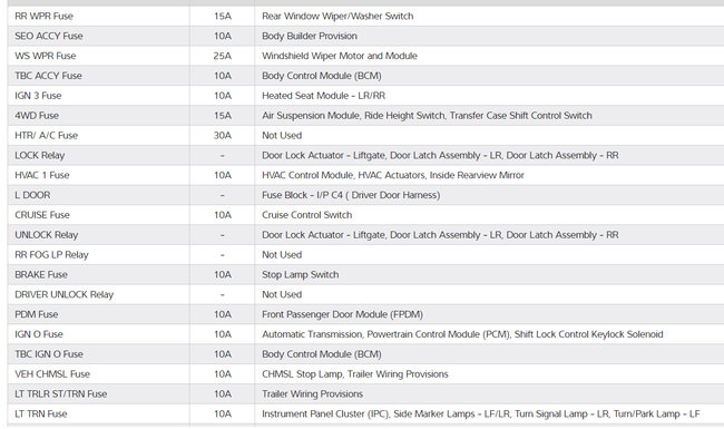

It looks like you have a fuse out there are two that run the cluster #11 and #19 (3rd diagram from the left) here is a wiring diagrams and guide to help you test and confirm the issue. Or the cluster is out
and
https://youtu.be/_HEC44xENxw
Here is the fuse panel location and diagrams (below) Please let us know if you need anything else to get the problem fixed.

I had this problem had to get a rebuilt cluster cost me $145.00 all set!
