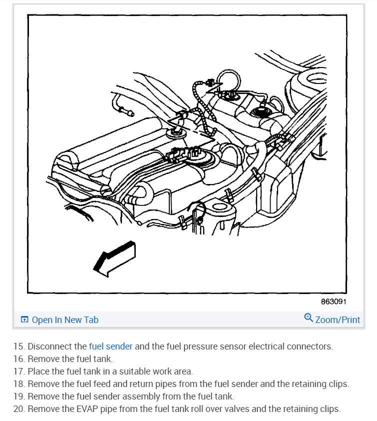

Fuel pump go out all the time in these here is a guide to help walk you through the repair with diagrams and instructions below to show you how in your car.
https://www.2carpros.com/articles/how-to-replace-an-electric-fuel-pump

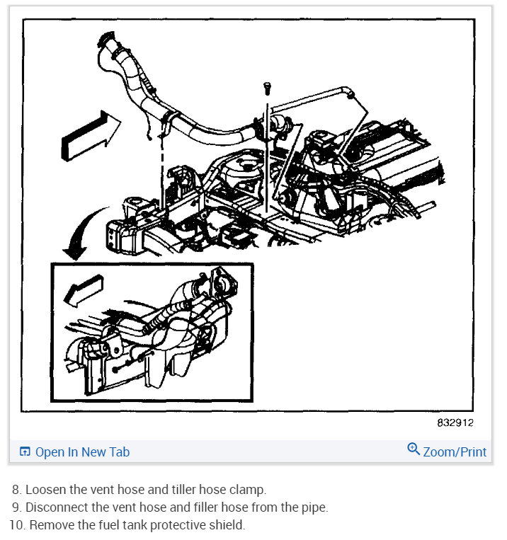

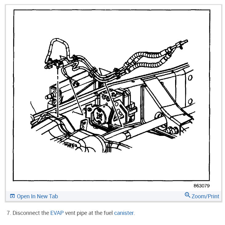

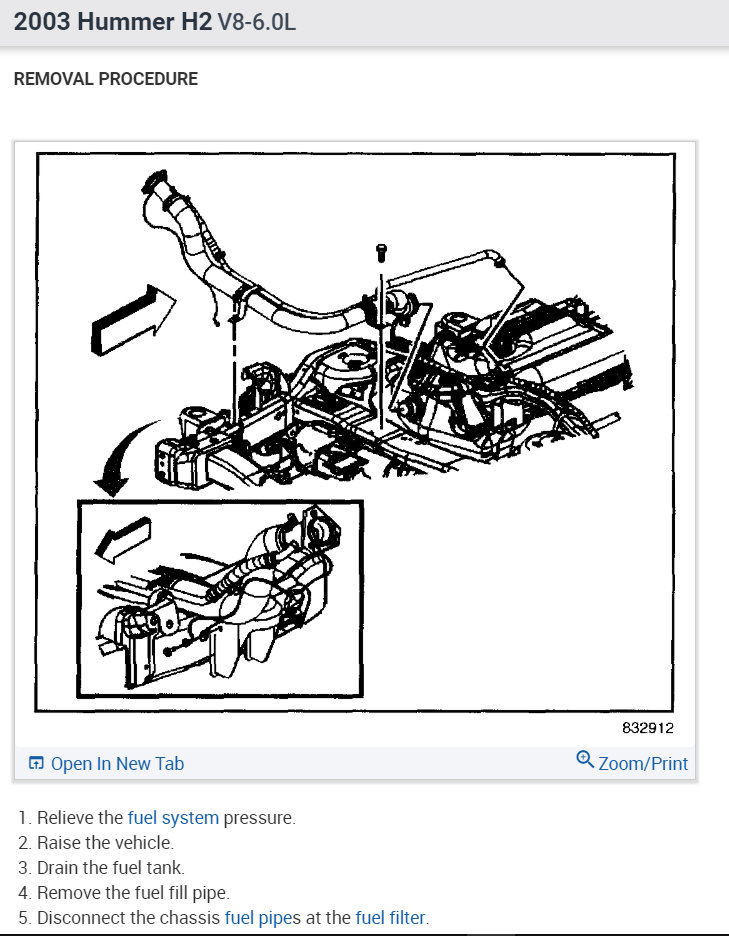

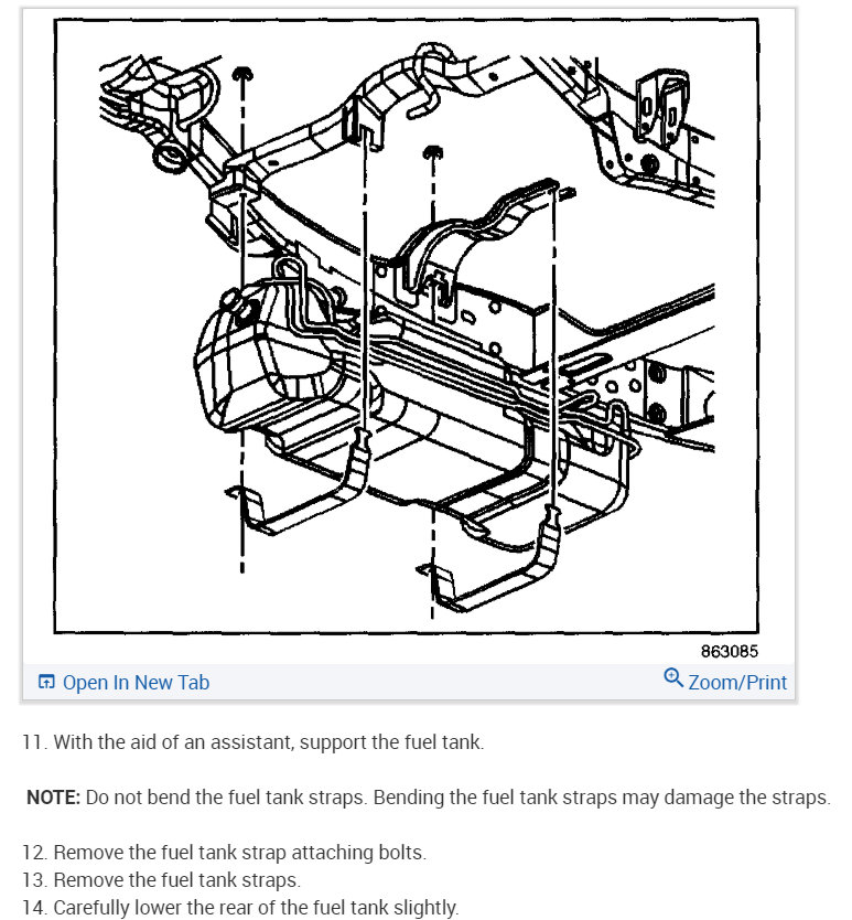

How do you replace a fuel pump on a 2003 h2 hummer?
Tuesday, January 29th, 2019 AT 5:14 PM (Merged)
FACTORYJACK
  • 4,159 POSTS
It is in the fuel tank. The tank can be lowered by first removing the shield, disconnecting lines, hoses, and electrical, and lowering, moving rearward as you go. It helps to tilt the rear of the tank down, and once you clear the axle, you can lower the front. If it has a decent amount of fuel, it also has a decent amount of weight and instability. It is not always possible, but draining the fuel is the best tip I can give.
