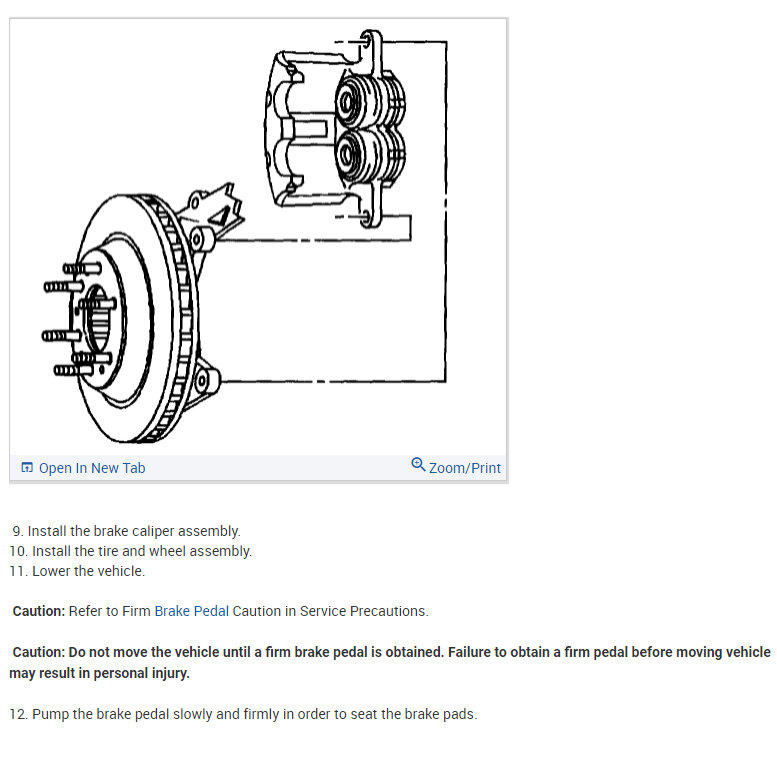

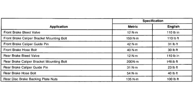

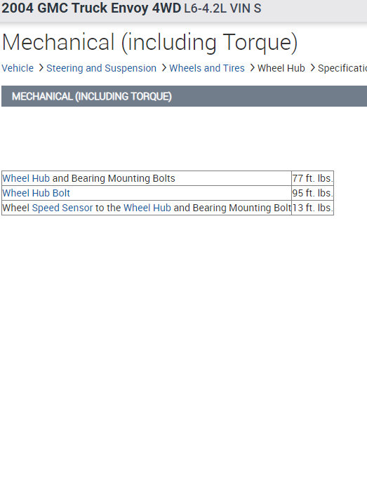

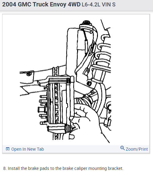

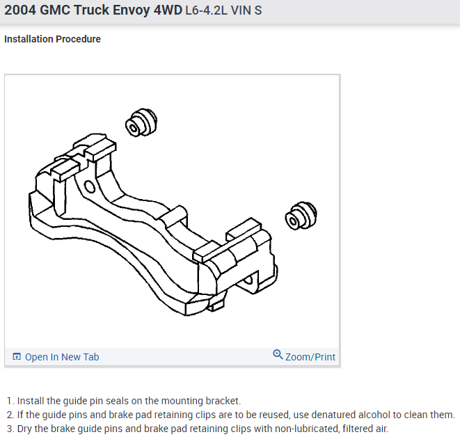

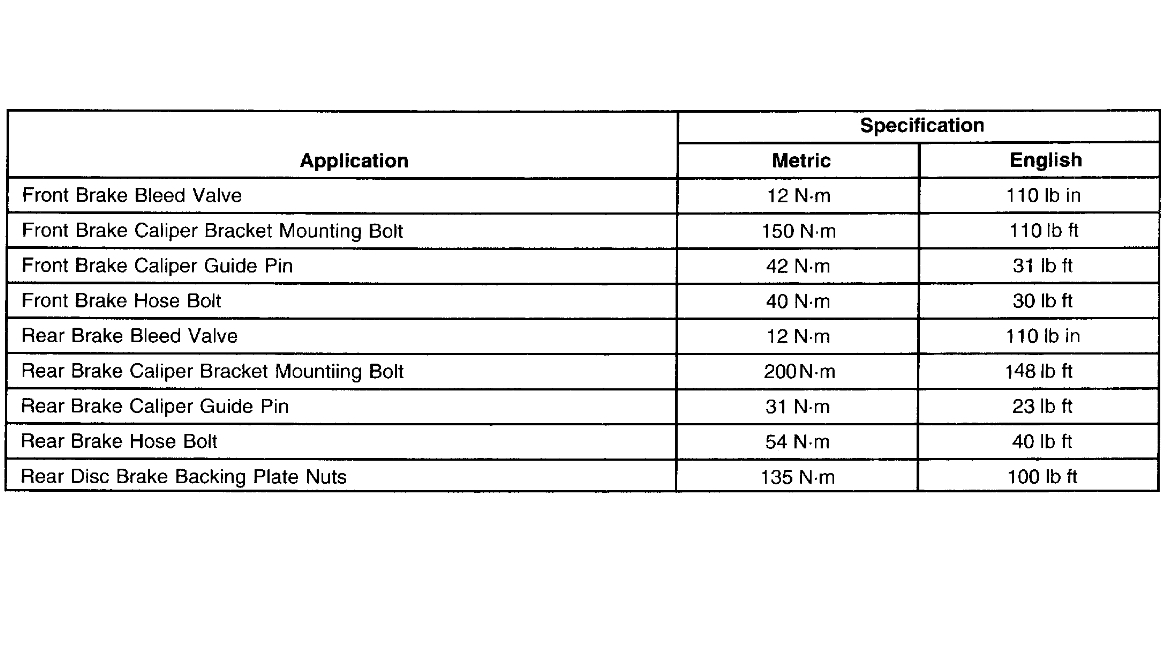

I recently found out I had a worn hub bearing so I changed the entire assembly. Would you have the torque specs for the brake caliper mounting bracket and the brake caliper and the hub assembly? Thanks ahead of time.
Aug 18, 2021 at 9:37 PM
SQM
  • 6,383 POSTS

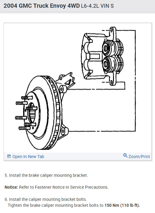

Here are the torque specifications:
Brake caliper mounting bracket bolts :110 lb ft.
Wheel Hub and Bearing Mounting Bolts: 77 ft. lbs.
Wheel Hub Bolt: 95 ft. lbs.
Wheel Speed Sensor to the Wheel Hub and Bearing Mounting Bolt 13 ft. lbs.
https://www.2carpros.com/articles/brake-caliper-replacement
https://www.2carpros.com/articles/how-to-replace-front-wheel-bearings-and-seals
Please let me know if you need any other info.
