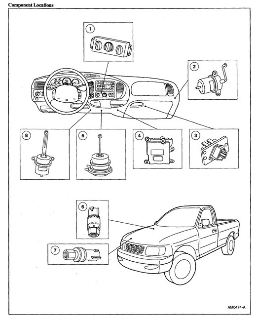

Now, the HVAC actuator doors are run by engine vacuum. When you press the gas, engine vacuum decreases and therefore, the noise goes away. When you let off the gas, it increases and you get the noise. If I am correct, one of the actuators is leaking vacuum or one of the vacuum hoses is damaged or disconnected.

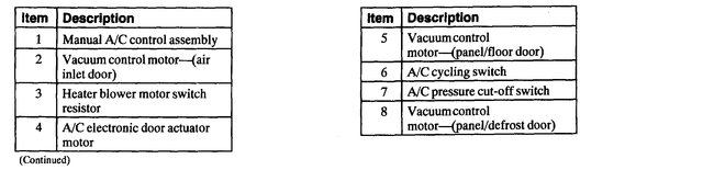

Craw under the dash and you will see vacuum lines. A supply will come from the engine to the control panel. From there, they will branch off to actuators. You need to see if any look damaged or disconnected. Also, try running the temperature the opposite as you have it, change air flow directions and see if everything is actually working or if one of the different selections changes the noise. There is an actuator for temperature, and two for mode (air flow direction). Any one of them could be the problem. If you find one not working properly or slowly, that is where we will focus.
I attached a general picture for you to see. It indicates where the different actuators are located. Focus on numbers 2, 5, and 8. Keep in mind, these things have vacuum modules which should hold vacuum. If there is a tear or dry rot issues, they will make noise. I actually heard them sound like geese. lol
Let me know what you find.
