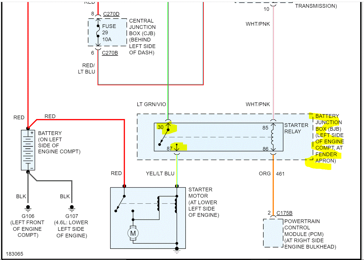

How would you use jumper wire to crank over starter?
2004 FORD EXPLORER
167,000 MILES
KIKS13
  • 10 POSTS
No crank no start.
Apr 7, 2022 at 6:28 AM
  • 110,240 POSTS

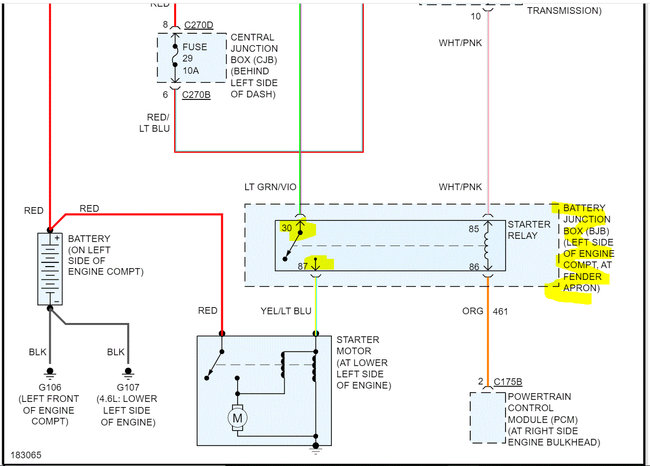

I am basing this on a 4wd 4.0L engine.
In the fuse box under the hood, you will find the starter relay. If you remove that relay and look on the rear of it, you will see 4 numbers, 30, 85, 86, and 87. Pay attention to the orientation of those numbers to where they will plug back into the fuse/relay box.
If you want to jumper the starter, you will need to jump where pins 30 and 87 plug into the box.

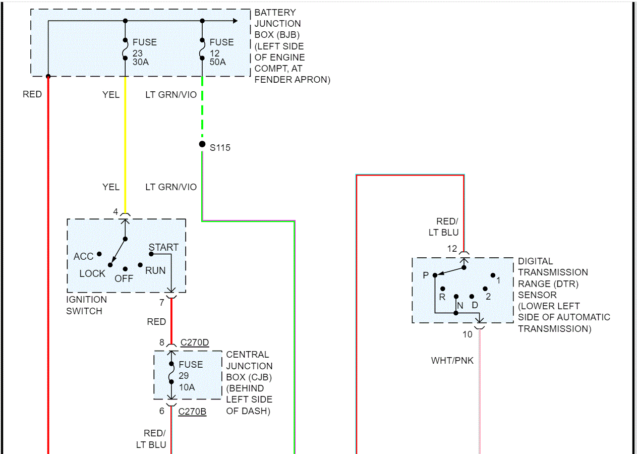

If you look below, I attached the wiring schematic for the starting system circuit. I'm not sure what is happening, but if you let me know, I can help direct you to repair the issue.

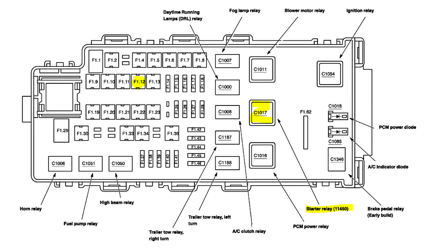

Note, if fuse 12 has failed in the battery junction box, the starter will not work even when jumping the relay. So, check that as well. Also, in addition to confirming the fuse is good, also make sure there is power to and from it.
The last pic below shows the relay location and the fuse I mentioned.

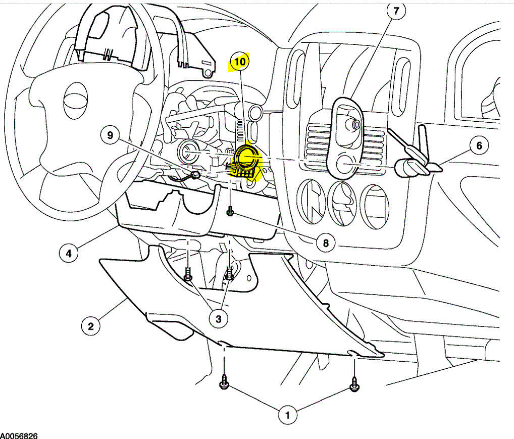

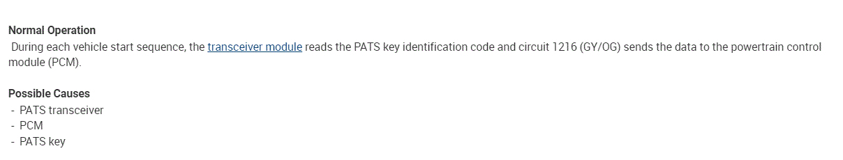

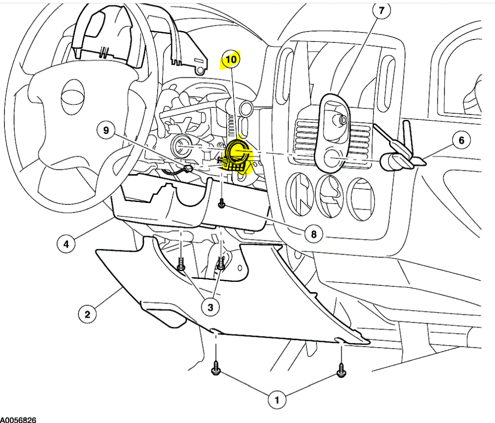

If it is the PATS, it should crank but not start. Did you try a different key? Was any work done around the transceiver? It's under the steering wheel covers. See pic 1.
As far as the system is concerned, what we need to do is get a scanner that can read the can-bus. CAN starts for the controller area network. Basically, the computers/modules are tied together via a few wires. This will retrieve codes regardless of the module storing them and should indicate where the problem is located.
Here is a link showing how it's done:
Let me know if that is something you can have done.
See pic below.

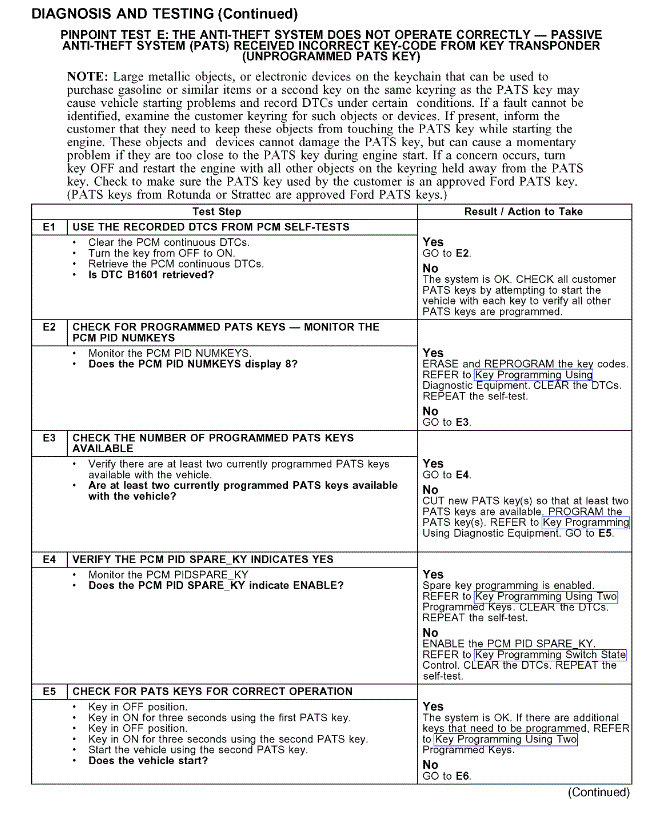

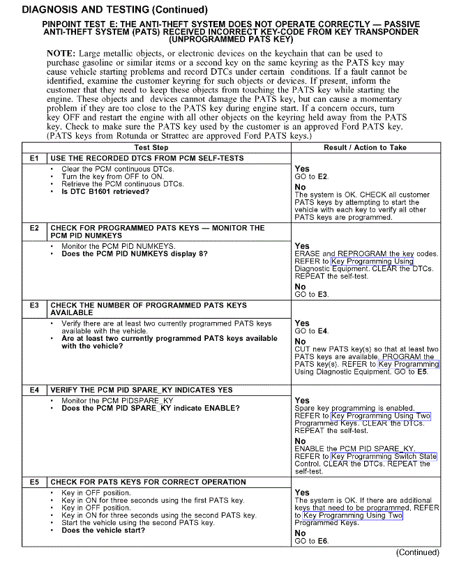

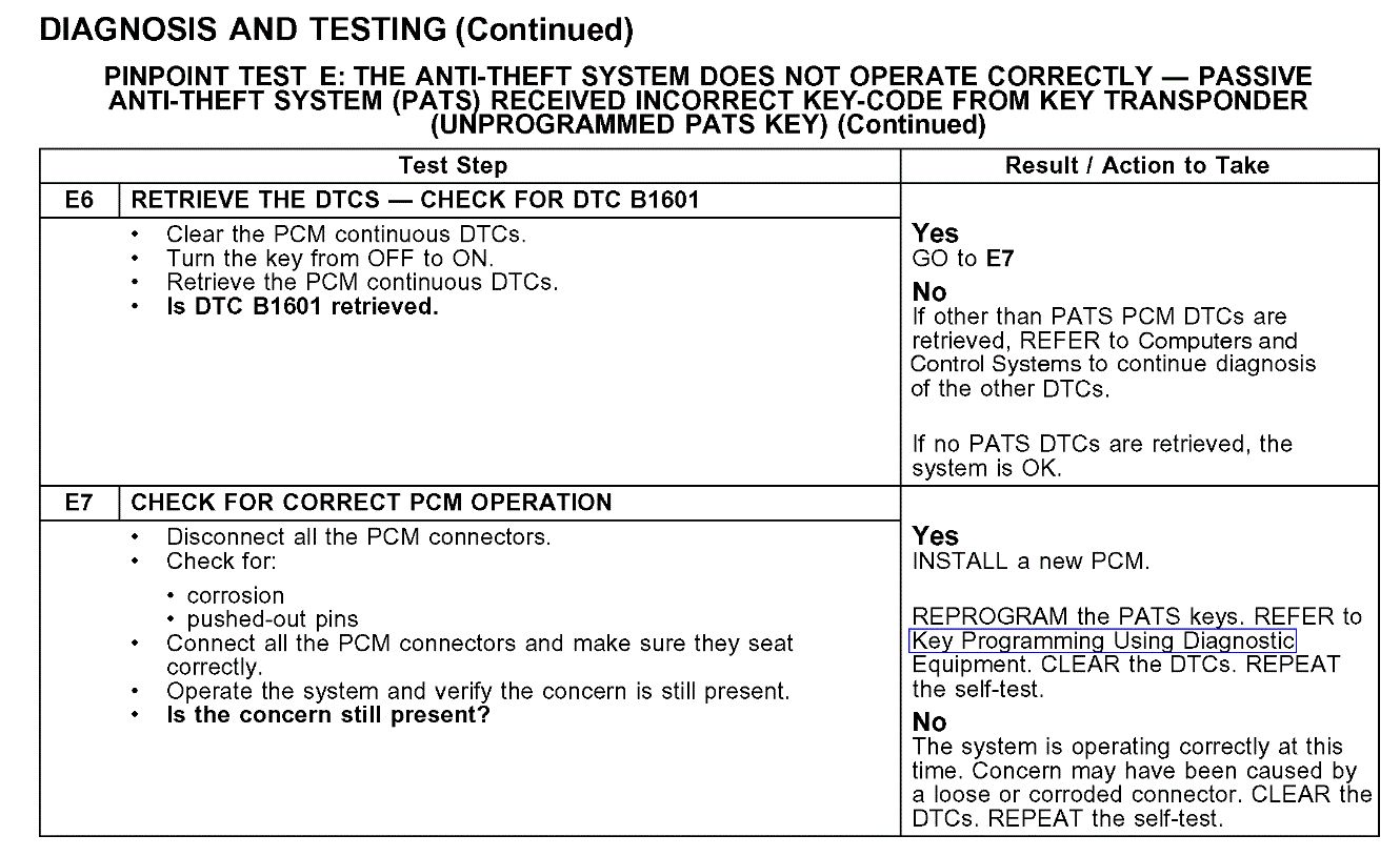

I scanned and it pulled a B1601 code. Would I have to get new keys and program them? My keys have an S stamped on them. That would mean that it is a 40bit?
Jun 17, 2022 at 4:04 PM
  • 110,240 POSTS

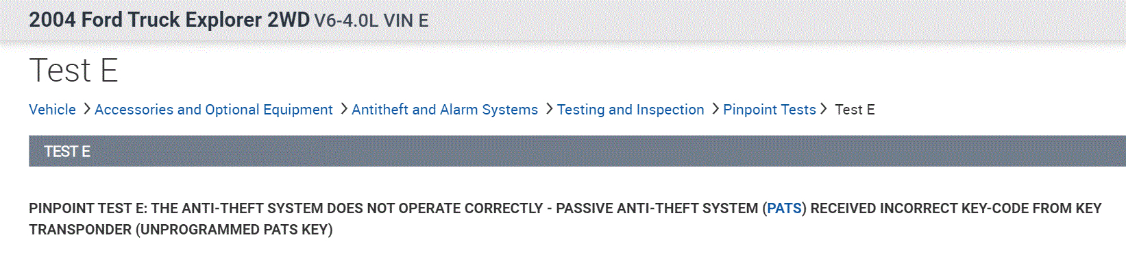

The PATS system doesn't recognize the key. Do you have a spare key to try?
I looked up the code and attached the diagnostics below. You can do this with the same scan tool that was used to retrieve the code.
Let me know what you find.
Jun 18, 2022 at 3:29 PM
