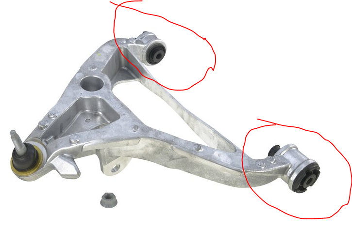

I don't know how many bushings I need to buy for my vehicle listed above, xlt.

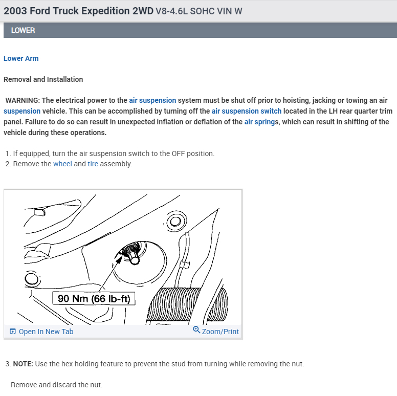

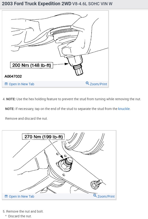

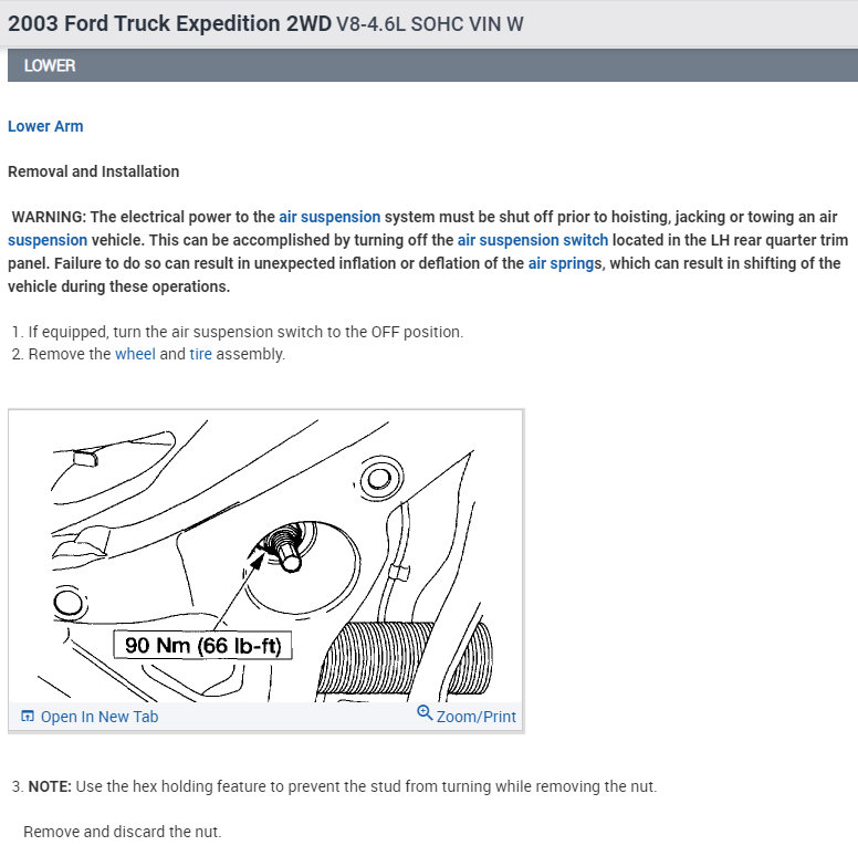

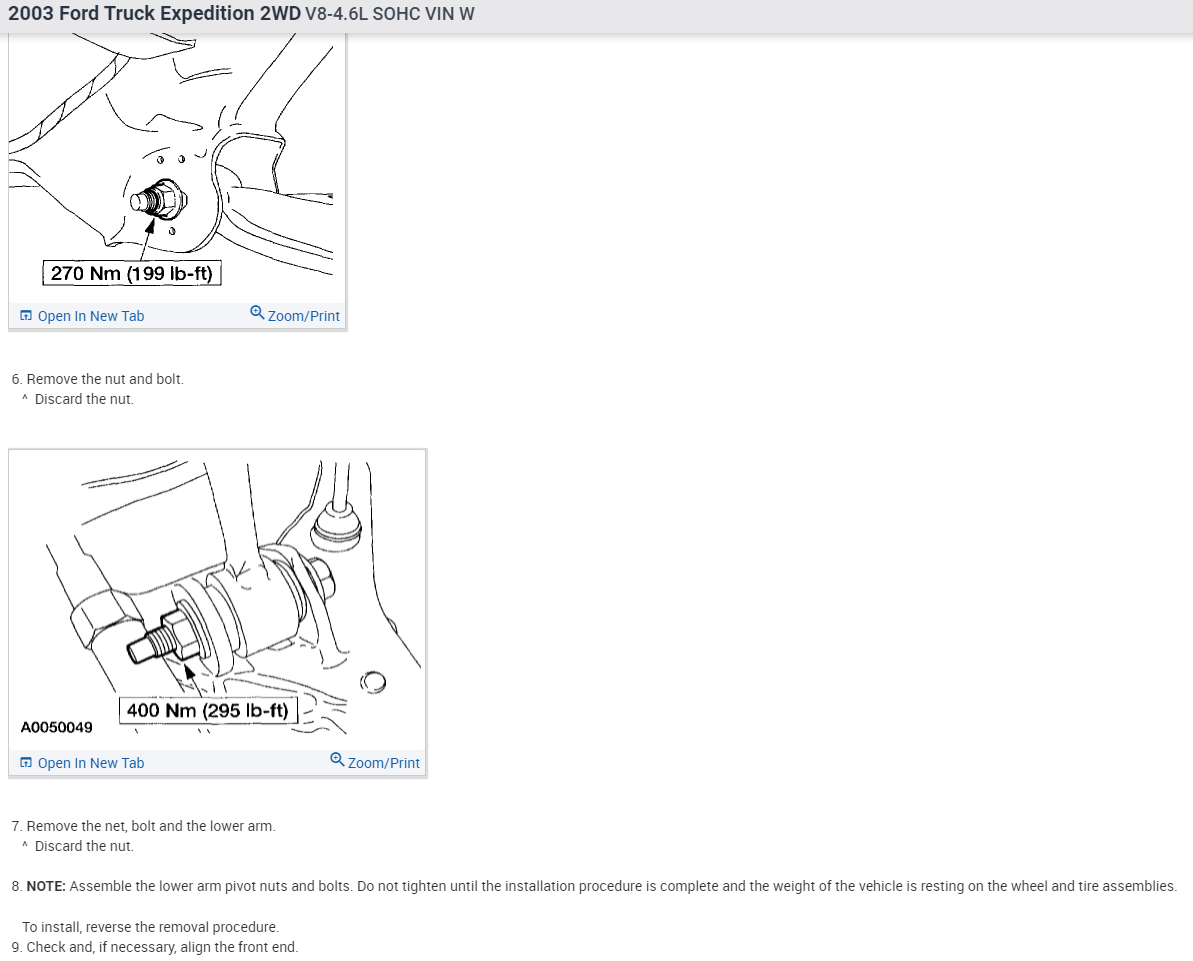

The lower control arm has two bushings (for each arm). See picture below.
It is also a good idea to replace the ball joint as well.
Here is a helpful guide on bushing replacement.
https://www.2carpros.com/articles/lower-control-arm-bushing-replacement
