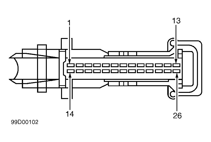

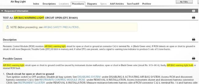

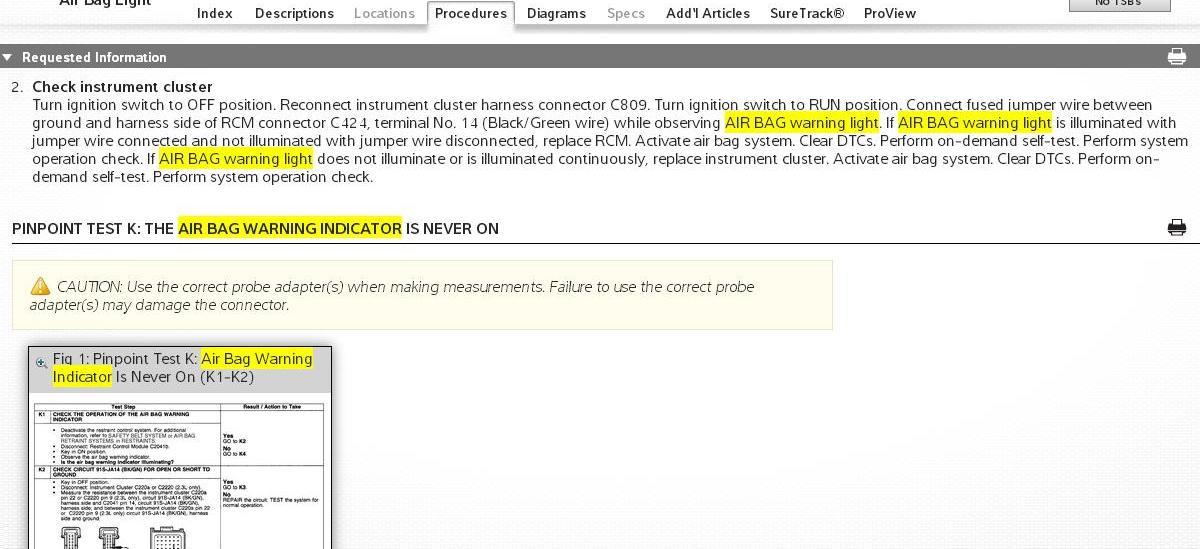

I swapped out my broken driver's bucket seat for a better one at a junk yard. The new seat was from an earlier model 2001. It fit perfectly but when I hooked up the electrical connection under the seat, the fasten seat belt bell rang even though I had it fastened. Also, the air bag warning light would not go out. I undid the battery for 5-min to see if things would re-set but no luck. I need to shut off both of these warning devices.

ANYWAY, IN ORDER TO LOOK THIS UP IN FURTHER IN "PRODEMAND", I'M GONNA NEED THE "SPECIFICS" OF BOTH VEHICLES
AUTOMATIC/ STANDARD/ ETC.
AS WELL AS ENGINE SIZES (GOT YOURS ALREADY)
I'M STUCK AT "SUBMODEL" RIGHT NOW ON YOUR VEHICLE, I NEED TO KNOW IF IT'S A "LX/ SE/ SVT/ZTS/ ETC. ETC. OTHERWISE I MIGHT WIND UP LOOKING UP/ COPYING THE WRONG DIAGRAMS
I MAY NEED MORE, SO POST ALL OF IT! (THE VINS FROM BOTH VEHICLES MIGHT MAKE IT REAL EZ, AS IT WOULD FILL IN ALL OF THE BLANKS)
MY APPROACH MIGHT BE TO GET WIRING DIAGRAMS (AT LEAST FOR THE SEAT STUFF) FOR BOTH RIGS AND COMPARE WHERE THE WIRING GOES. THE PRODEMAND DIAGRAMS SHOW THE WIRE COLORS AND LOCATIONS OF THE COMPONENTS THEY GO TO

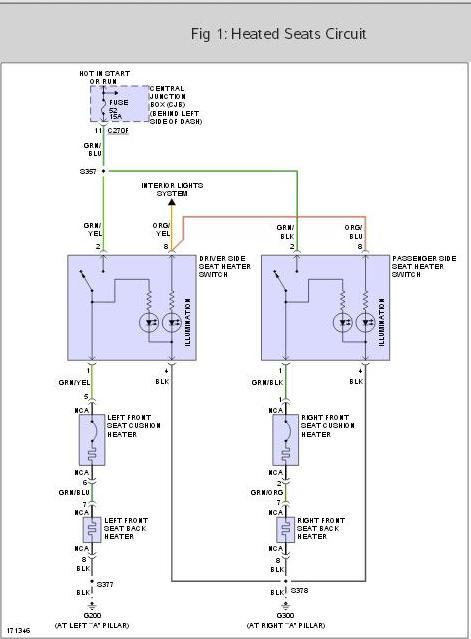

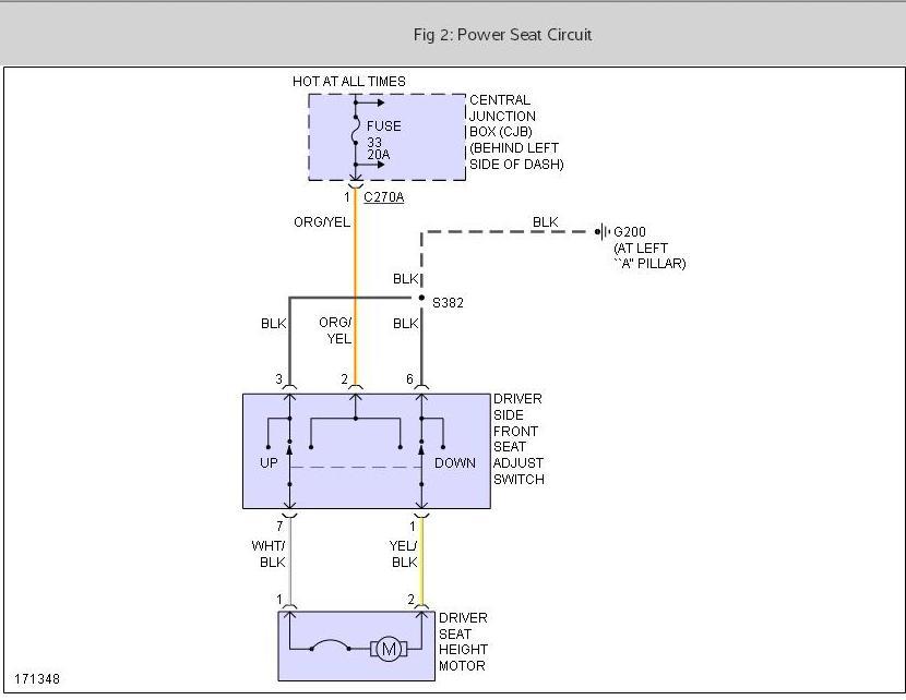

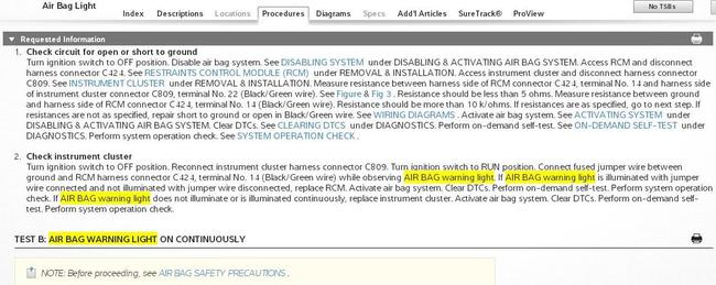

SO WITH THE BEST-US AS I COULD DO, WITH THE INFO FOR THE OTHER CAR. LOOKS LIKE THE SEAT'S WIRING ARE THE SAME FOR EITHER "HEATED" OR "POWER". I'M POSTING BOTH TYPES AT THE BOTTOM (EITHER CAR COULD HAVE EITHER TYPE)
NOW THE FUNNEST PART
SOME OF "PRODEMAND" IS "SAVABLE" TO MY COMPUTER (SOME DIAGRAMS)
MUCH OF THE TEXT STUFF CANNOT BE COPIED, HOWEVER WE CAN MAKE SCREENSHOTS. I MADE MANY AND HAD TO CROP OUT MY SCREEN STUFF
DUE TO MAYBE NOT BEING ABLE TO POST THEM IN THIS POST, I'M GONNA ANSWER AGAIN BELOW WITH THE SHOTS

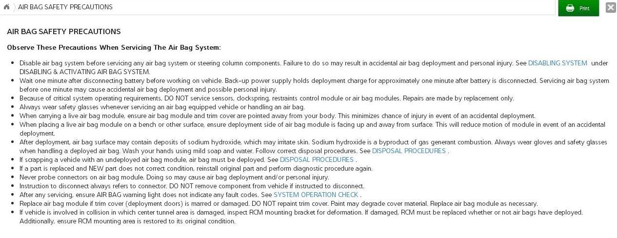

THERE IS AN AIRBAG WARNING I GOT, SO LET'S BE CAREFUL AND GO TO A PRO IF THINGS ARE NOT LOOKING SO HOOAH! IN YOUR GARAGE. DON'T NEED YOU TO GET MESSED UP WITH AN AIRBAG. I GOT MESSED UP WITH ONE IN THE 80s, BUT I WAS ABLE TO DIVORCE HER!
SO GIMME A FEW MINUTES TO POST THE REST, THEY "SHOULD" SORTA BE IN ORDER, AS ONE WILL CONTINUE TO ANOTHER WITH SOME OVERLAP OF SENTENCES.

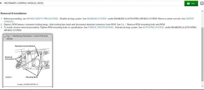

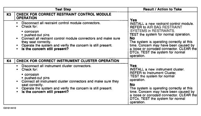

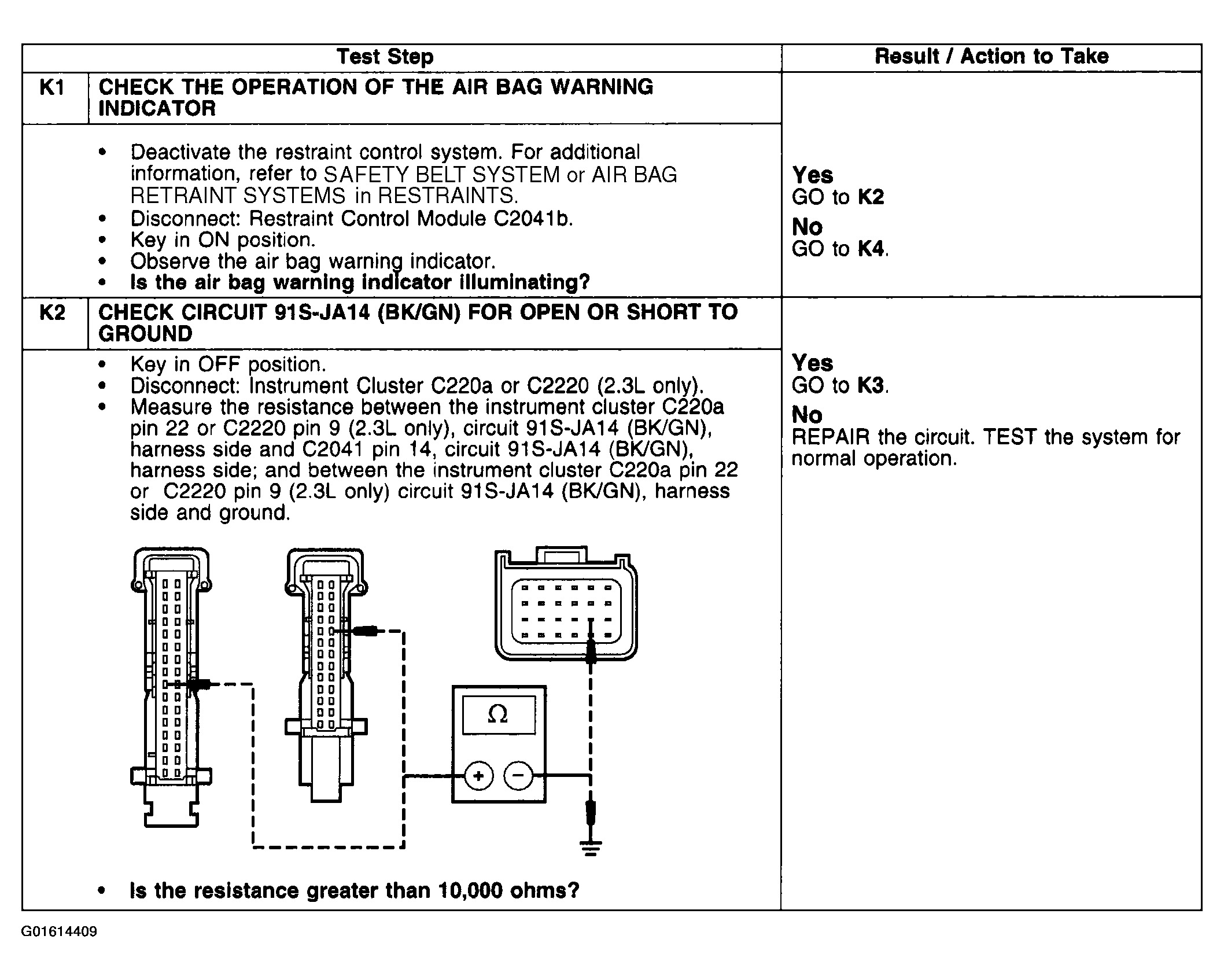

Jul 18, 2015 at 12:29 PM
CJ MEDEVAC
  • 11,004 POSTS
I SUGGEST YOU MIGHT DO THE EZ STUFF IF YOU CAN, TAKE IT TO A PRO IF QUESTIONABLE
THESE SHOTS ARE FROM "PRODEMAND", JUST GIVIN' 'EM CREDIT

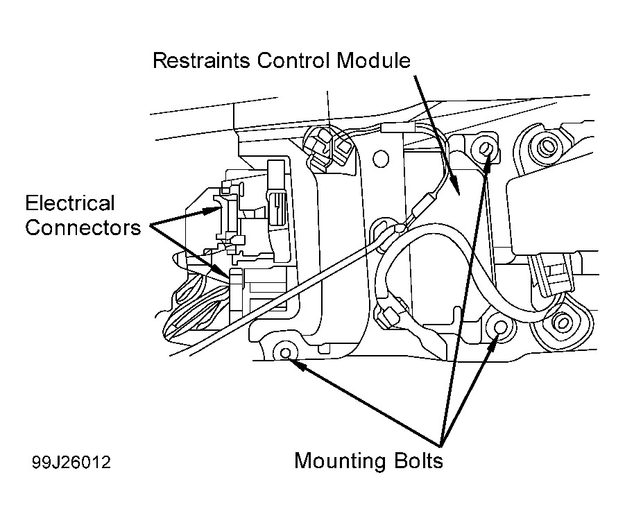

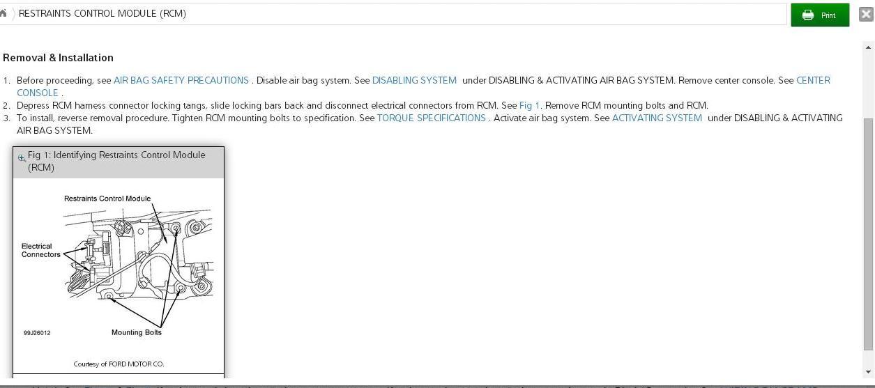

Jul 18, 2015 at 12:37 PM
CJ MEDEVAC
  • 11,004 POSTS

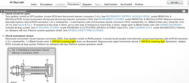

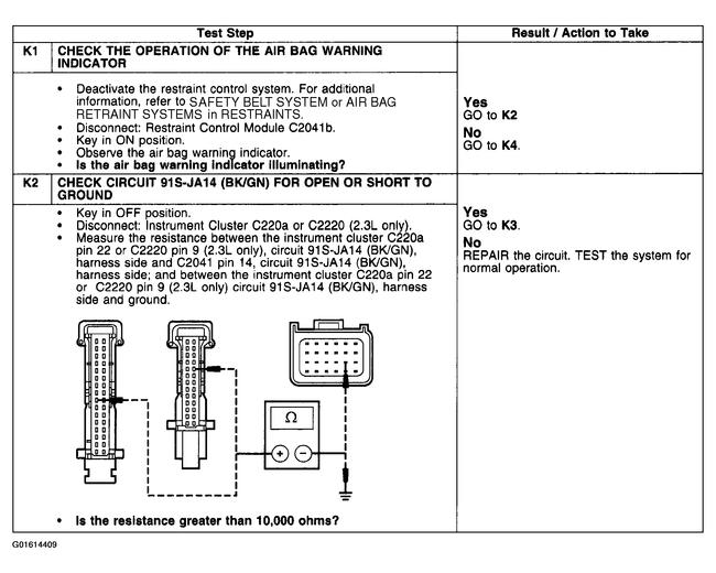

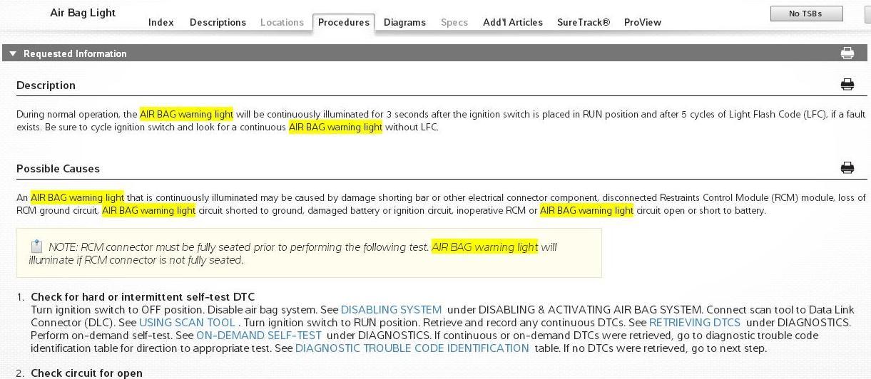

THE REST
LEMME KNOW IF THIS STUFF MIGHT HELP?

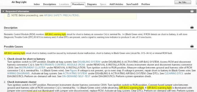

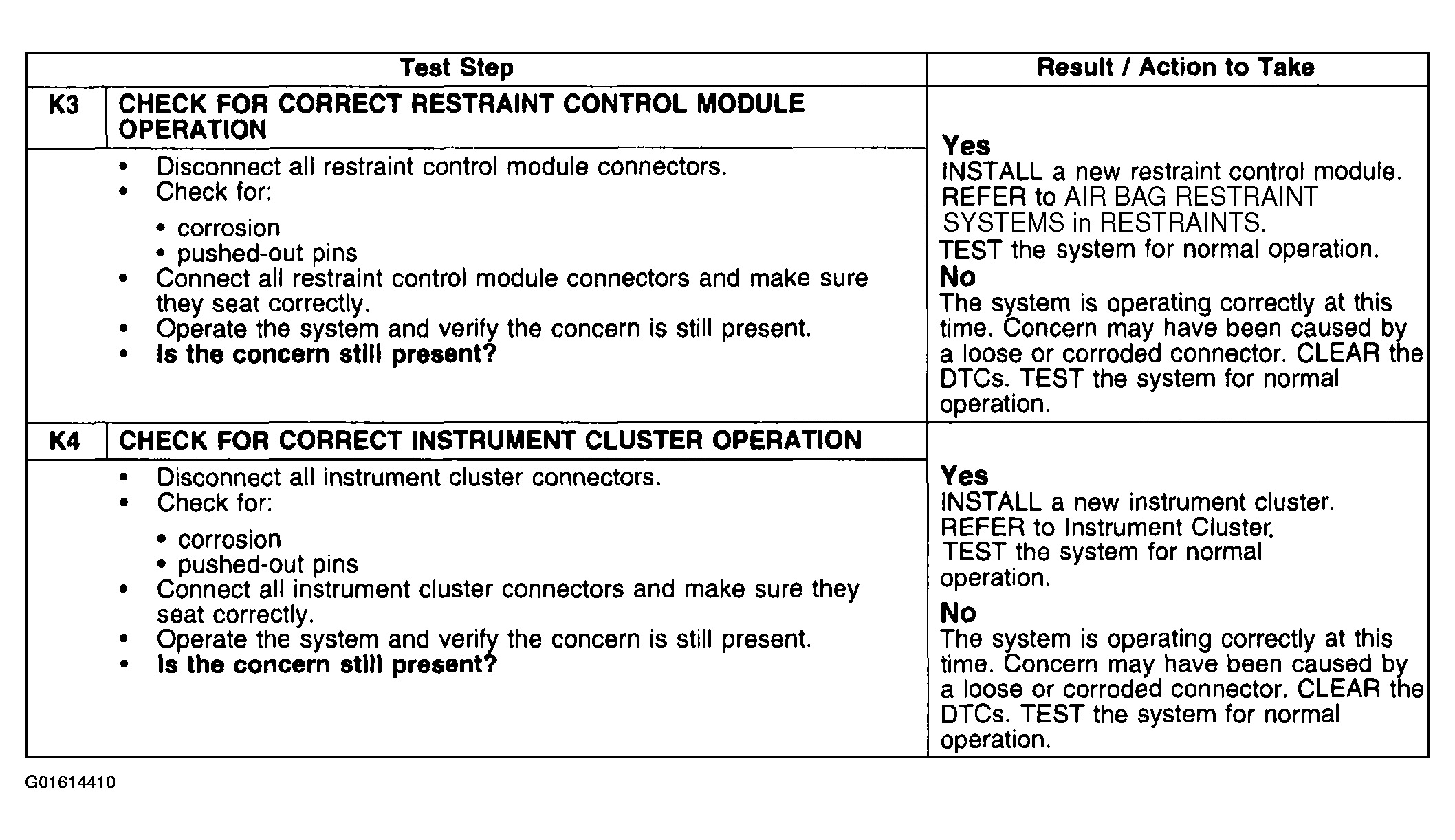

Jul 18, 2015 at 12:40 PM
CJ MEDEVAC
  • 11,004 POSTS

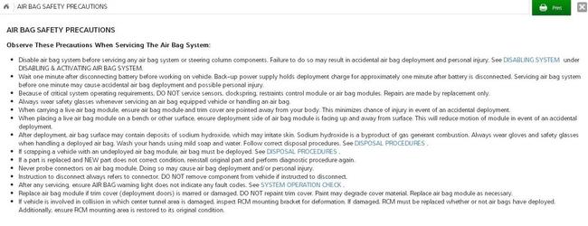

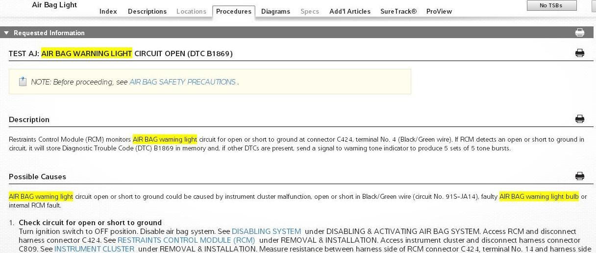

I THINK I MISSED THIS ONE

I don't think I want to screw around with the air bag system and wiring harness. Too far beyond my pay grade. I can flip switches and pull fuses and all the simple stuff but I'm not tearing into the electrical system .
Plus the early Focus models didn't have heated or power seats. Also the PCM module that is mentioned to be in the console doesn't apply to a Focus. The console is just a little plastic storage bin.
I'm going to take it to Pep Boys and see if they can reset the air bag system.
