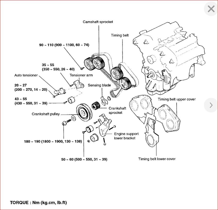

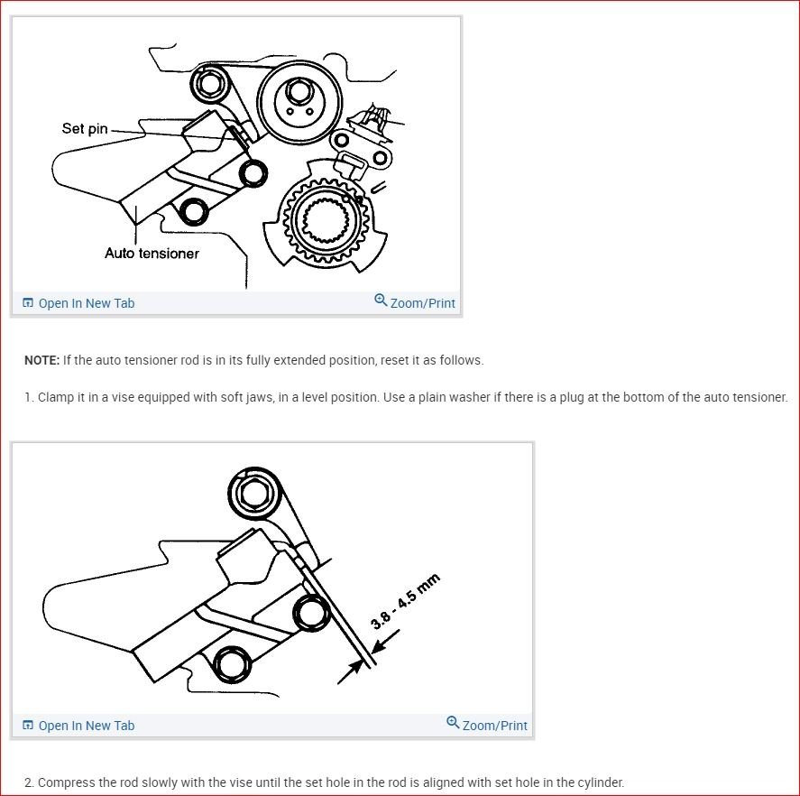

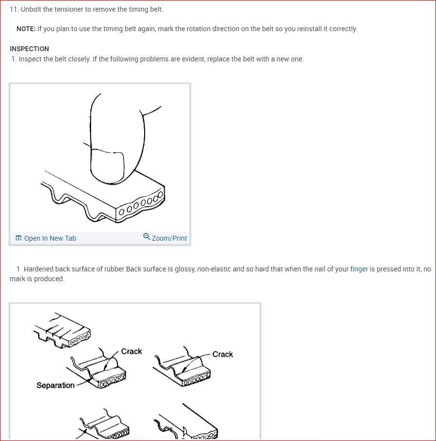

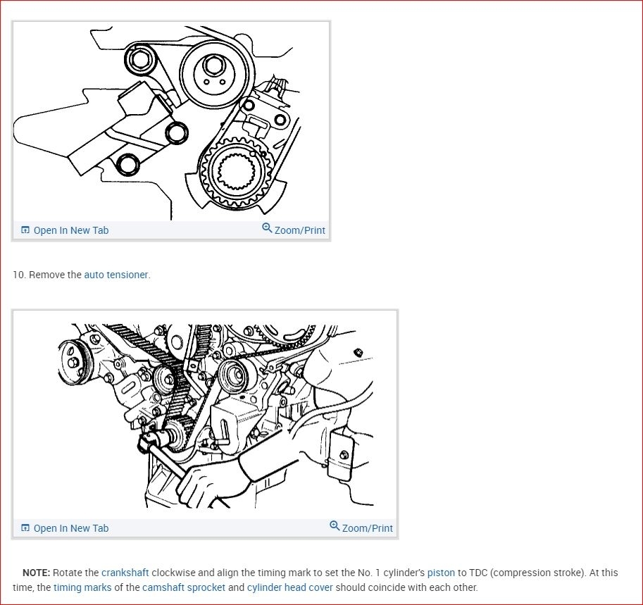

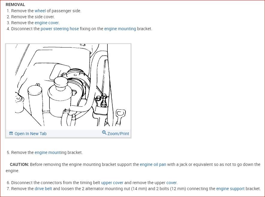

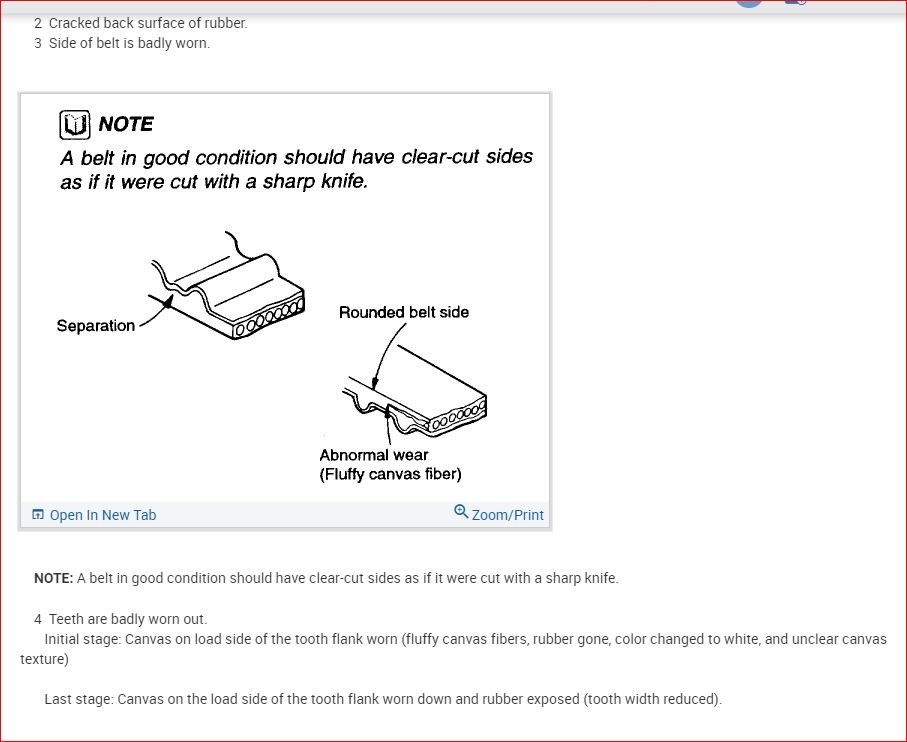

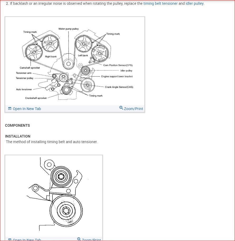

Hi TSAU,

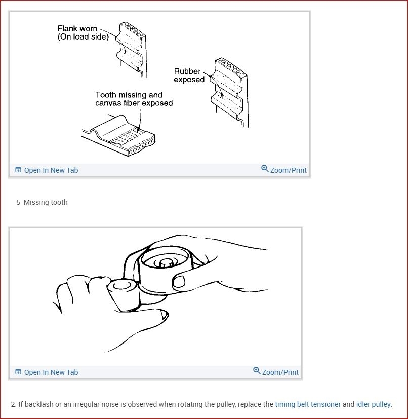

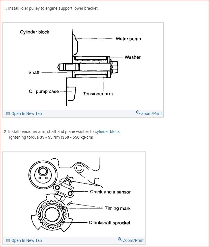

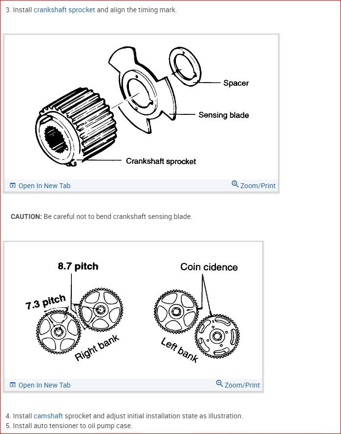

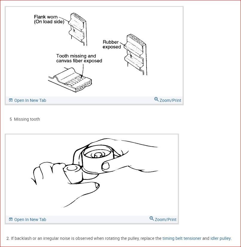

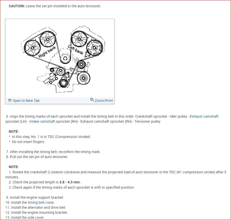

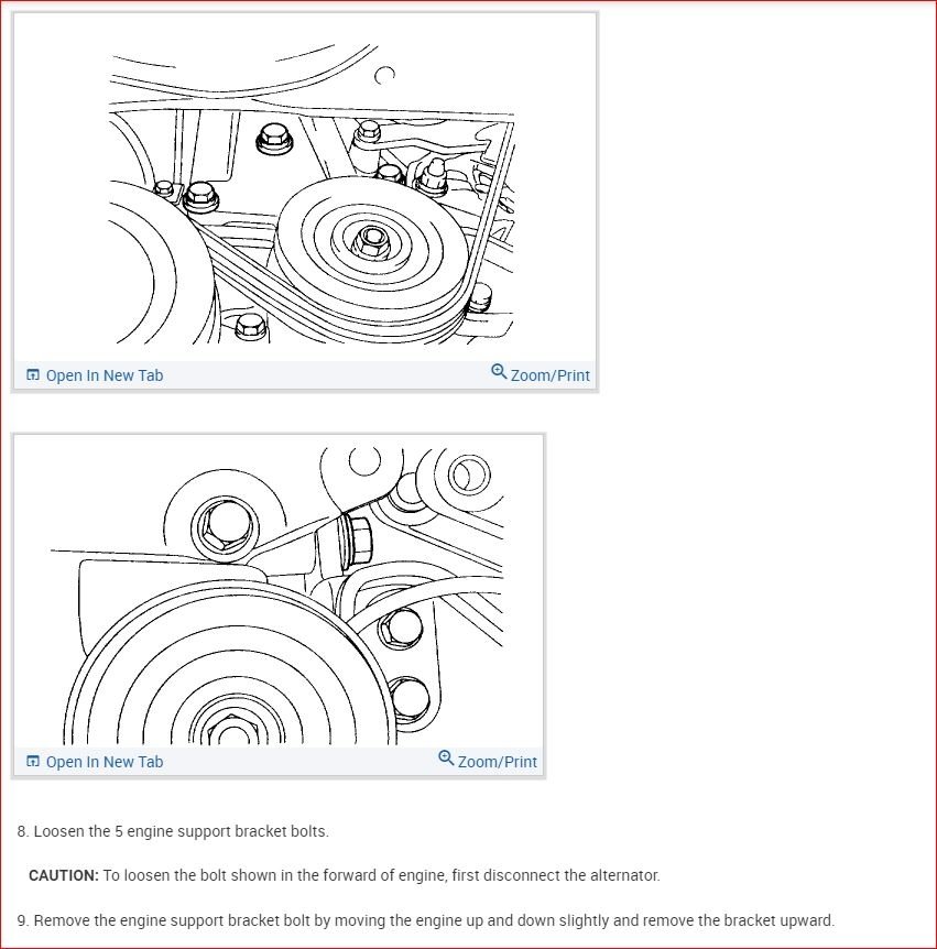

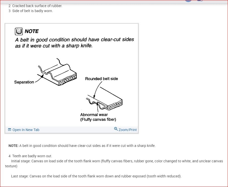

I attached the procedure on how to replace the belt. This covers alignment marks. There is a special note that you should not turn the engine using any other than the crank pulley when the belt is on.
However, if you are asking how to rotate the cam to line up the marks with the belt off, then you just turn the cam sprocket to align the marks.
Please tell me if I am not understanding and I will do what I can to clarify.
