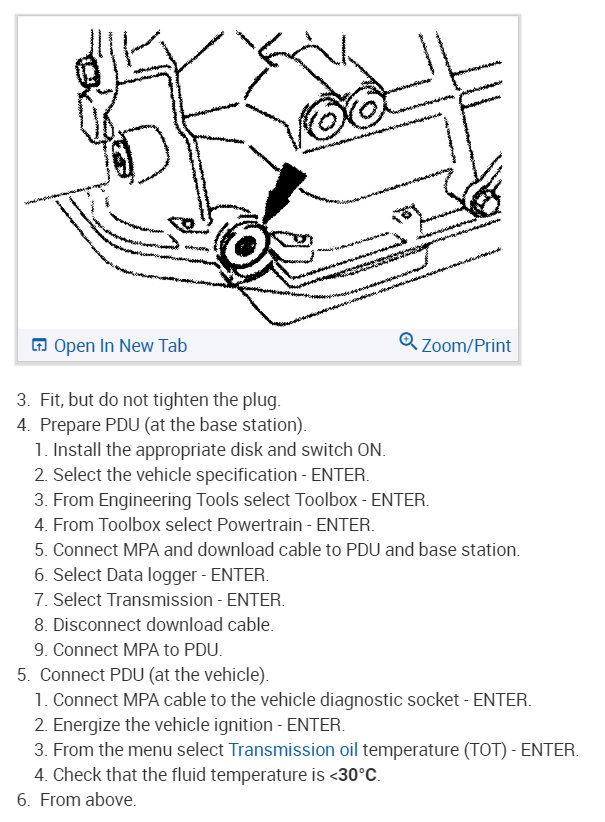

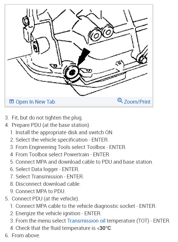

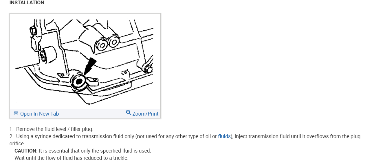

Found filler cap. Don't know how to take it off.
Nov 18, 2019 at 11:13 PM
  • 55,433 POSTS

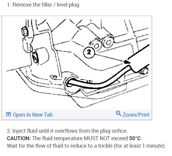

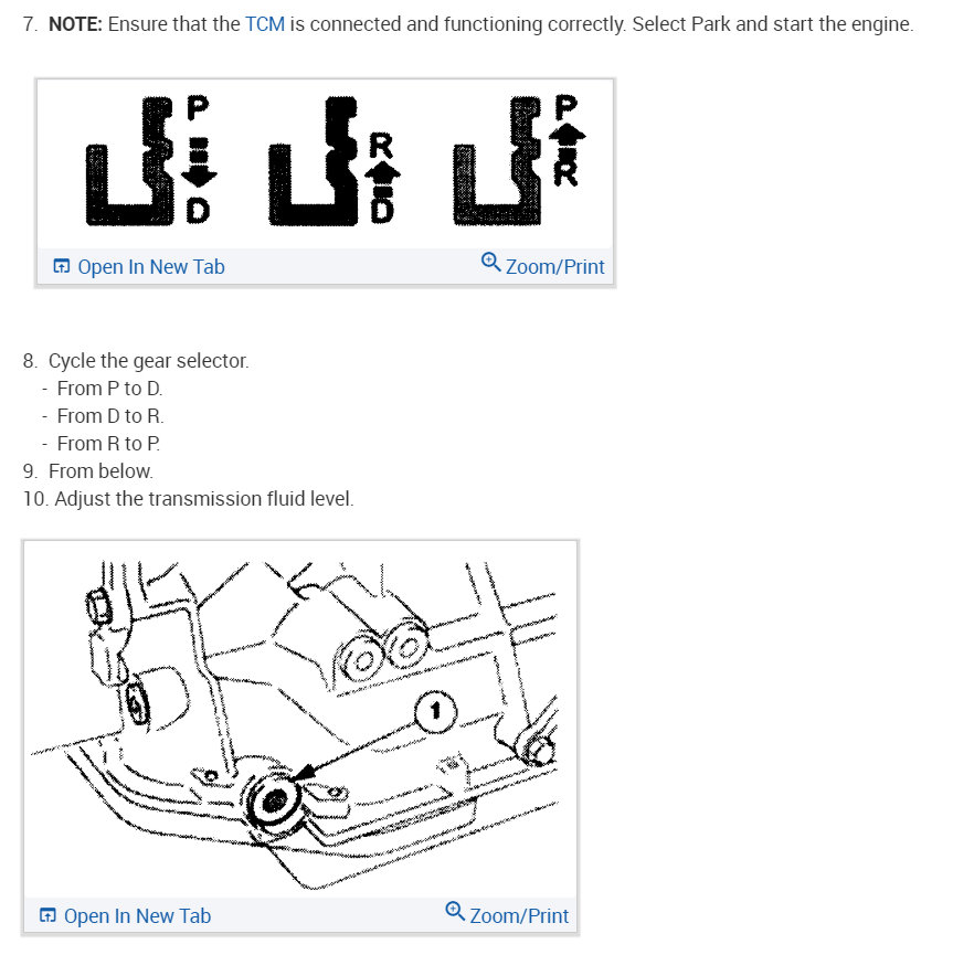

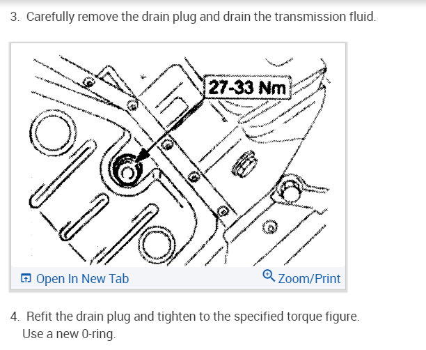

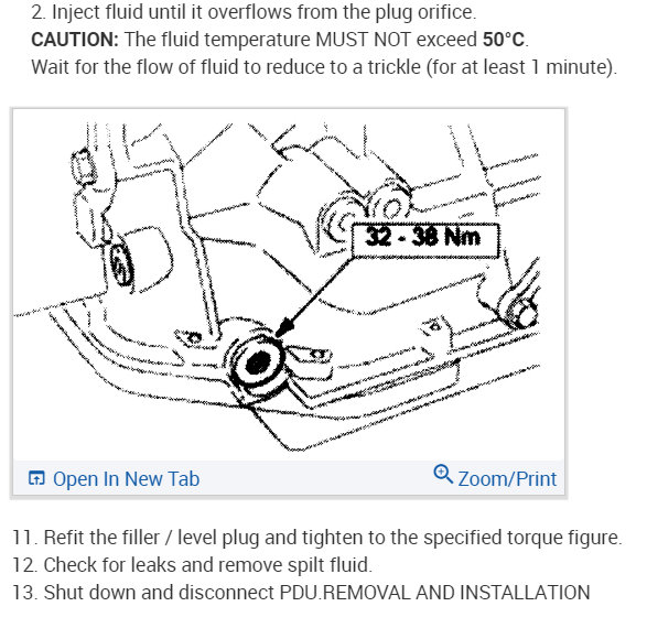

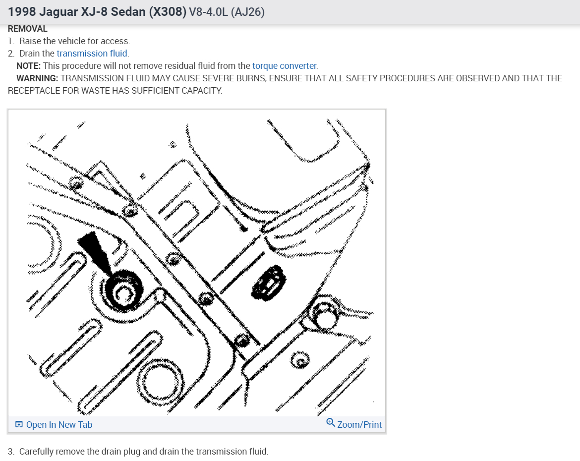

This is how the transmission fluid is checked in your car check out the instructions in the diagrams below.
Fluid Types
Automatic Transmission Fluid .................... Esso ATF LT 71141
Capacities
Transmission Fluid Capacity .................... 10.0 liters (10.6 quarts)
