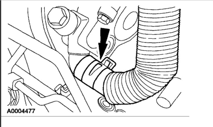

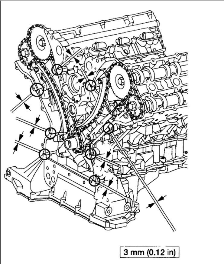

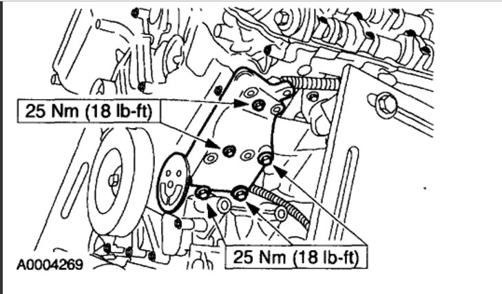

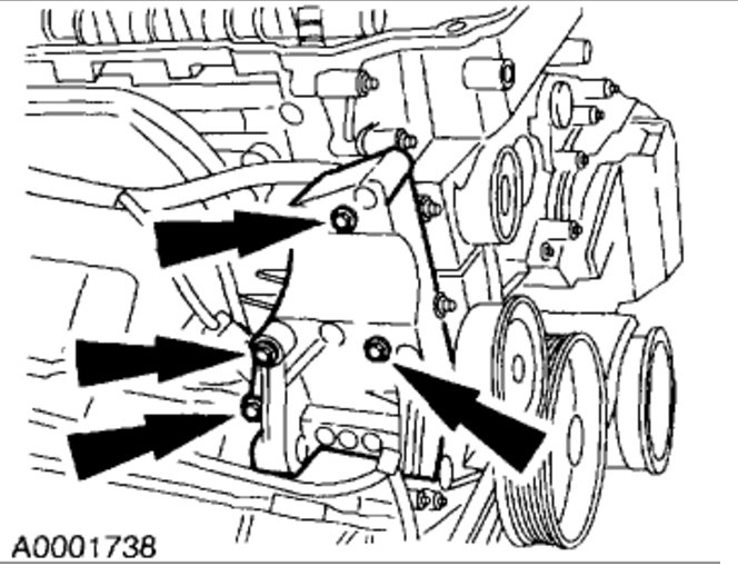

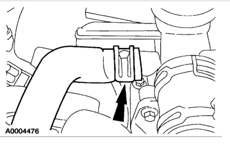

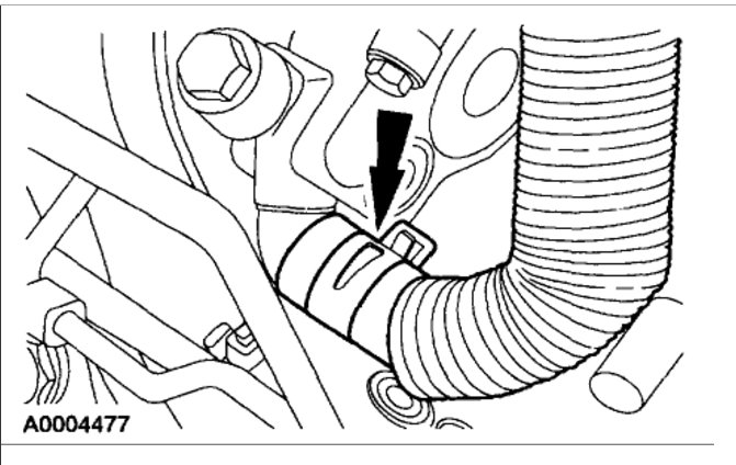

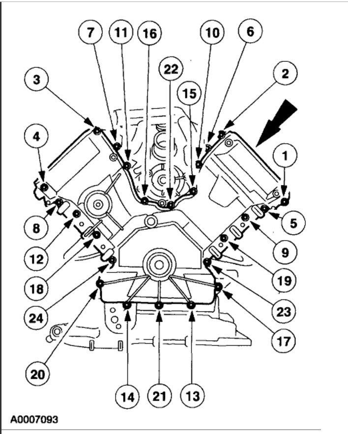

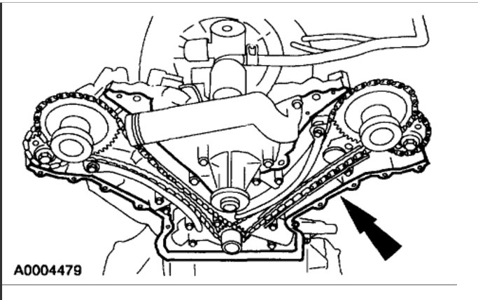

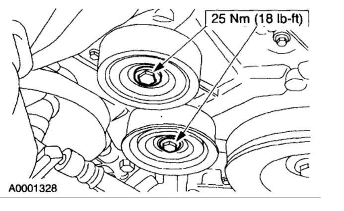

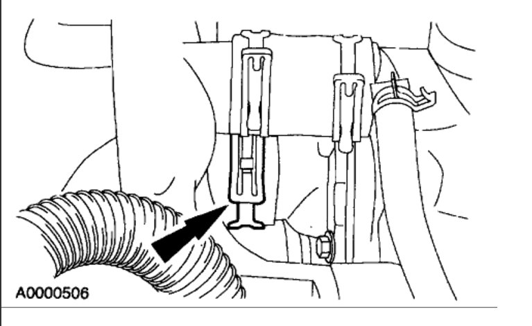

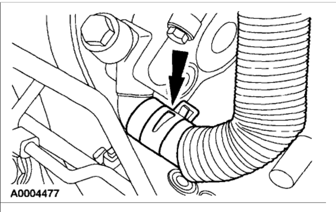

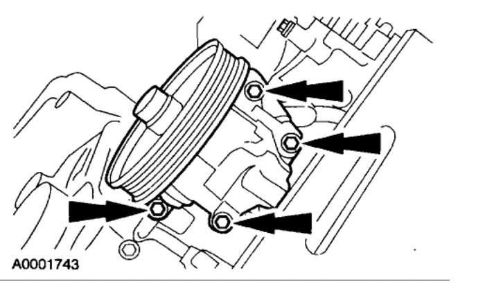

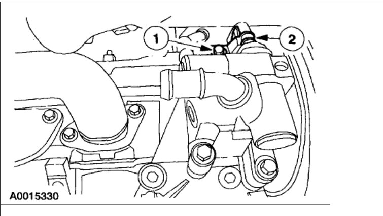

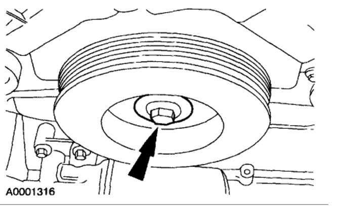

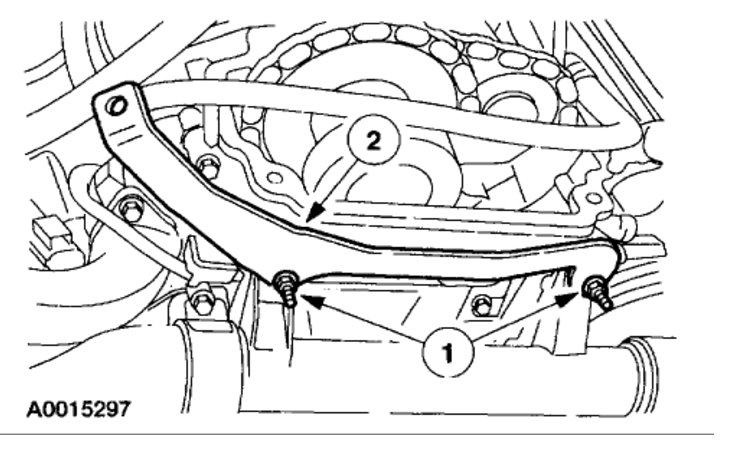

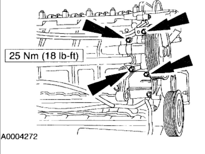

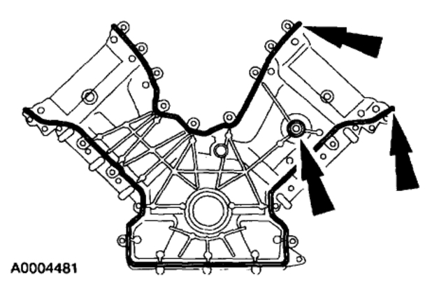

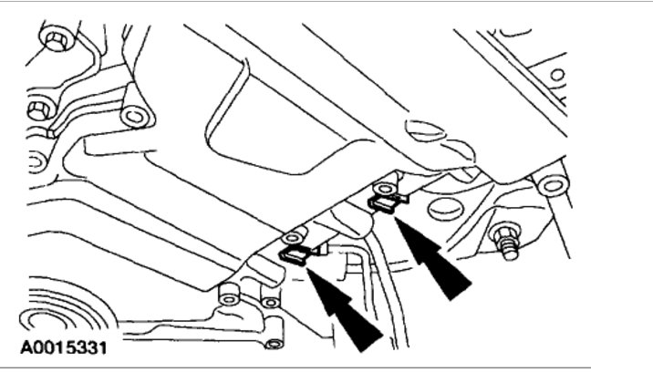

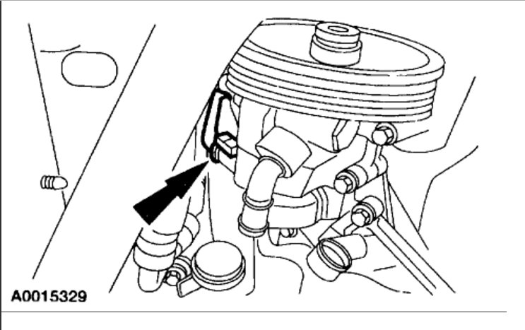

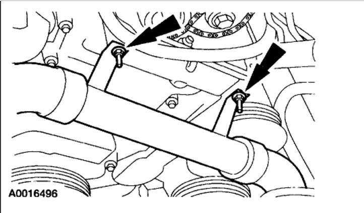

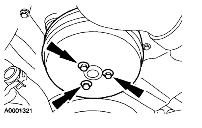

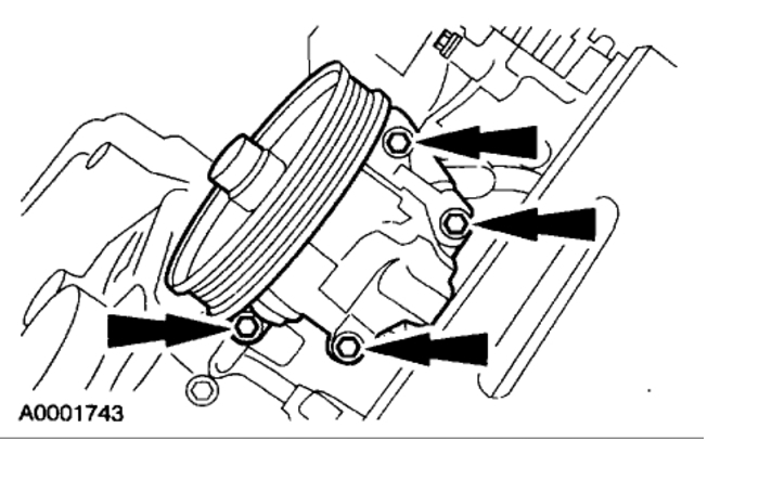

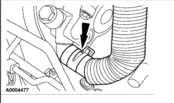

I cannot get the timing chain cover off. what all do i have to remove to get it off?
Sep 3, 2017 at 8:24 AM
  • 55,433 POSTS
First disconnect the battery so you will not create a short circuit. you will need to move the serpentine belt and then the front balancer.
Here are some guides that will give you an idea on what to do on that:
and
https://www.2carpros.com/articles/how-a-harmonic-balancer-works
Below are the timing cover diagrams needed to help you do the job.
Please let us know what happens and upload pictures of the problem.
