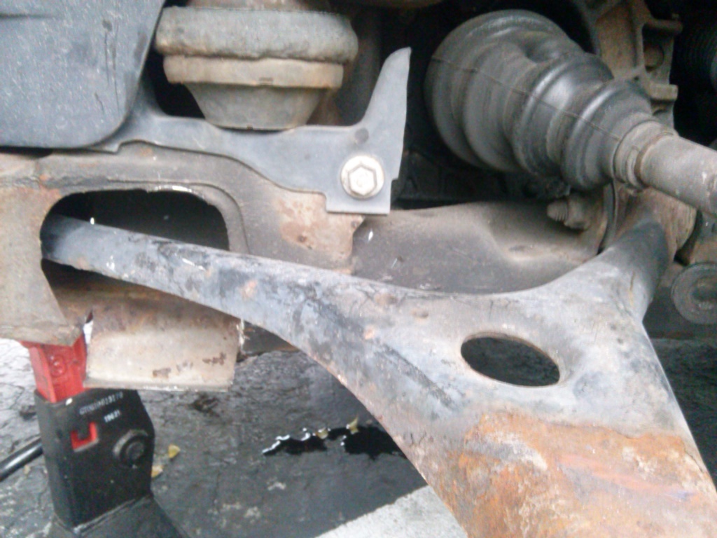

I took off all bolts to lower control arm and its still not budging. how do you get this control arm off so i can replace it ?

It is pressed onto the ball joint and requires some special tools to separate the ball joints from the arm. The other end should just slide out of the brackets with a little coaxing.

this isnt a normal control arm, one side is longer and going up into the frame.. so trying to figure out how to get it out of the frame.

It pulls straight out of the frame. https://www.2carpros.com/images/external/84863712.jpg.gif

one side (left side) longer part of the arm, slides up into the body of the car, has 2 bolts, i can get one bolt off but the other doesnt come out.. seems like the bolt that doesnt come out, might be something there so cant get it out ? heard something about the trans mounting bolt being in the way .. this is a drivers side front control arm.. wish i could post of pic

that left side is going up in the car, i got one bolt out but the other bolt doesnt move..

It's just a single bolt with a nut holding it in. You have to hold the nut when turning the bolt.

Thank You, was just a single bolt but we had to jack up the engine mount to get enough height to pull the bolt out..
