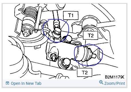

I paid the repair shop to put my clutch in. I picked it up drove home. The next morning my clutch was not working again so i had it towed back to the shop. He told me that. I needed a new master cylinder. I purchased that. It still did correct the problem. Then he said that the i needed i slave cylinder despite the that one came with the clutch. The people that I purchased the clutch exchange me for a whole new clutch kit. Now the mechanic says that the slave cylinder is faulty so now I'm left with a leaking clutch. My question is, how can this leaking be stopped because obviously he does not know?

Honestly, this is a good question. I need to know what is leaking on the slave. Is it leaking where the hydraulic line connects or is the slave itself leaking? I attached a picture of the slave cylinder and you will see that I circled two things. Those are the two places it can leak. One is the hydraulic supply hose that attaches to the slave and the other is the operating cylinder. If the internal components in the slave are bad, it will leak from the cylinder itself. If the hose is bad or not properly seated, it can leak from there.

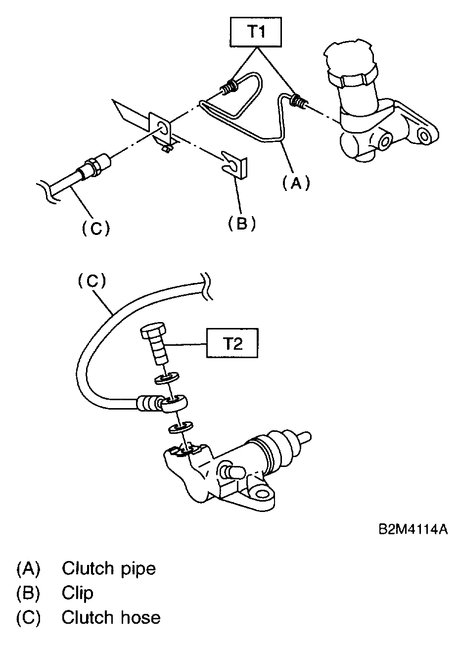

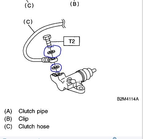

If you look at picrtures 2 and 3, they are of the hydraulic clutch lines. In picture 3 I circled two brass washers that have to be replaced when it is taken apart. If they are not both replaced, it will leak. That fitting is known as a banjo fitting.
If there is a chance you could check where it is leaking, I could better help you. Also, you will most likely need to clean the area and refill the system to see where the leak originates.
